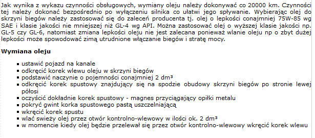

    Welcome as in the subject. Maybe someone knows where the oil is drained from the gearbox and where it is poured? I would be grateful for the information, and even more for the pictures. greetings

    And this control and filling hole is where it is located?

    Ok thanks a lot
