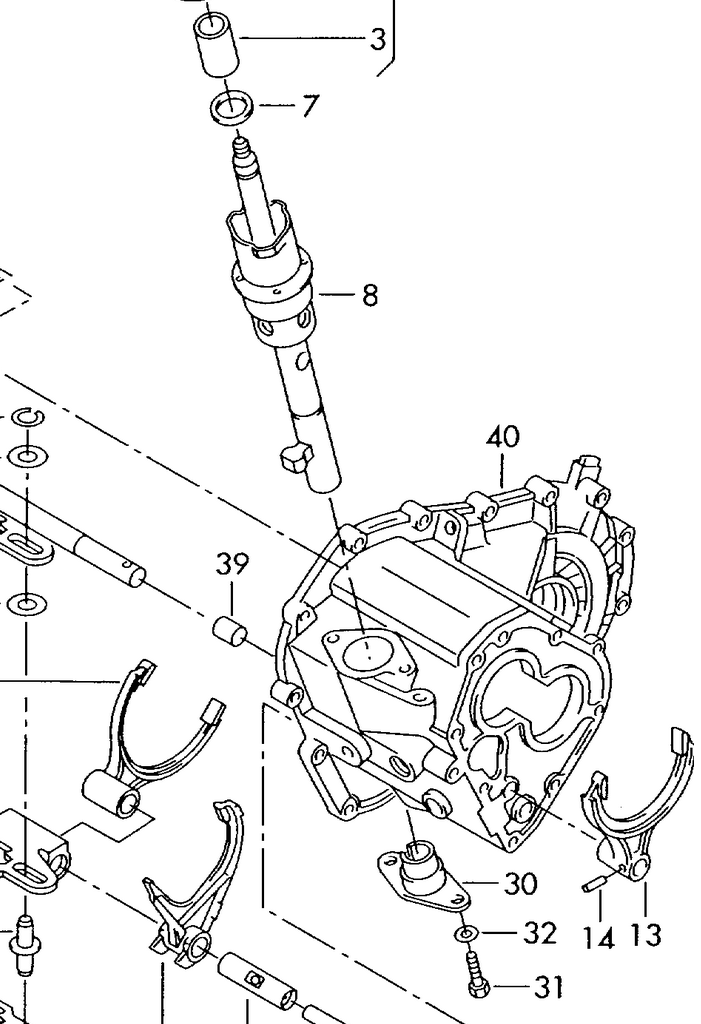

  • #14 21116260
    pawelnowakowski1984
    And what is underneath that red marked lid? Perhaps it would be more convenient to drain the oil with it?

  • #16 21117266
    M.R-V4
    Posts: 510
    Help: 76
    Rate: 164
    pawelnowakowski1984 wrote:
    what is underneath this highlighted red cover?
    Bottom bearing of the selector shaft, no. 30
    • Skoda Fabia 1.4 mpi 68km 2002 - Problem - Fabia I oil change in the gearbox Zaznaczenie_001.png (271.09 KB) You must be logged in to download this attachment.
  • #17 21117321
    pawelnowakowski1984
    >>21117266 .
    And will I be able to drain the oil from the gearbox there?
  • #18 21117695
    M.R-V4
    Posts: 510
    Help: 76
    Rate: 164
    You can do this, do not move the gearshift lever after removing this cap.
  • #19 21117863
    pawelnowakowski1984
    M.R-V4 wrote:
    You can do it, don't move the gearshift lever after removing this cap.
    Ok thanks very much.
  • #20 21118190
    ociz
    Posts: 15844
    Help: 1379
    Rate: 3486
    And will I be able to drain the oil from the box there?
    No, not even half the oil will come out when you unscrew it.
  • #21 21121932
    pawelnowakowski1984
    It worked fine, all the oil flowed out elegantly.
  • #22 21122689
    ociz
    Posts: 15844
    Help: 1379
    Rate: 3486
    Only someone who has never seen such a box from the inside will believe this.
