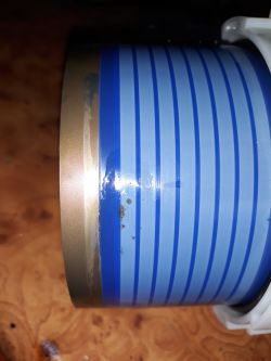

    After reading the electrode and displaying error E9 I dismantled the dishwasher and I know that I have to buy a pump with a heater. The heater cannot be removed from the housing. There was a leak on the O-ring and a heater shot. I'm heading for something else, while cleaning the plastics, I had to unscrew the gear motor that controls the water flow.
    P I would grow for help in assembling, and actually in the exact arrangement of the cog and holes - I think it matters. I am asking for help and I attach photos. One more thing - can the gasket on the main plastic attached from below be removed or placed on silicone.
    Regards hoping for help.

    The connection of the plastic bowl to the bottom of the dishwasher is made of silicone (enough to withstand temperatures up to 180 ° C) can be folded.
    PS .
    Three days ago my hu ... shot through the spill from the bowl. A new pump plus a silicone leak seal and the topic taken care of. If I don't forget, I will put a photo with a water separator system. In the mode on the 3rd photo there is a notch that should match the notch in the rotary aperture with holes, that's all theory I will check tomorrow.

    I thought so too and folded it. If anything, I will sell a functioning pump motor, as if someone had fired, please let me know.
    edit:
    Well, the pump has been ordered, nothing more than to fold, and it is a pity that the heater cannot be replaced.

    There is no silicone available, and the O-ring and heater can be bought and replaced.
  • #6 16782078
    lensa
    Posts: 37
    It is not possible to replace the heater in this model, it is combined with a metal something and embedded in a plastic housing. As for silicone, I think it will do its job.

    Well, I do not insist, but the heater about 200 PLN, and the entire pump 360 PLN so it works, but I have one grasp. As you can see in the picture I cleaned one part before and I have to set the cog, sometimes you don't know how it should be? I folded so that I covered the notch visible on the cog with the marker on the second one but I see that there is no proper pressure on the "windmills".

    I put together and works ok.
    As if someone needed such a pump with a burner heater I invite you. Engine Works.

    This time I had a problem E 04. I dismantled the dishwasher there was some water on the tray but not too much. Standard review. Drying. Seeing the motherboard because the dishwasher was washing but with cold water. I checked the relays, improved February at the heater output. After folding, she hulked like gold for 2 weeks. Yesterday again E 04 but it pounded the difference. I am at home. I stripped. Pump pulled out and pain here. Dripping from under the heater.
    And here a request for help. How to seal the heater in the housing. The pump lasted a year. And I don't have a receipt, and I took it apart from the thread guarantee.
    Damn. Is such sealing feasible?

    Put a new O-ring into the pump body and after a problem.

    O-rings cannot be used for this heater, it is for pumps with a narrower heater.
    Dishwasher dismantled, new purchased.
