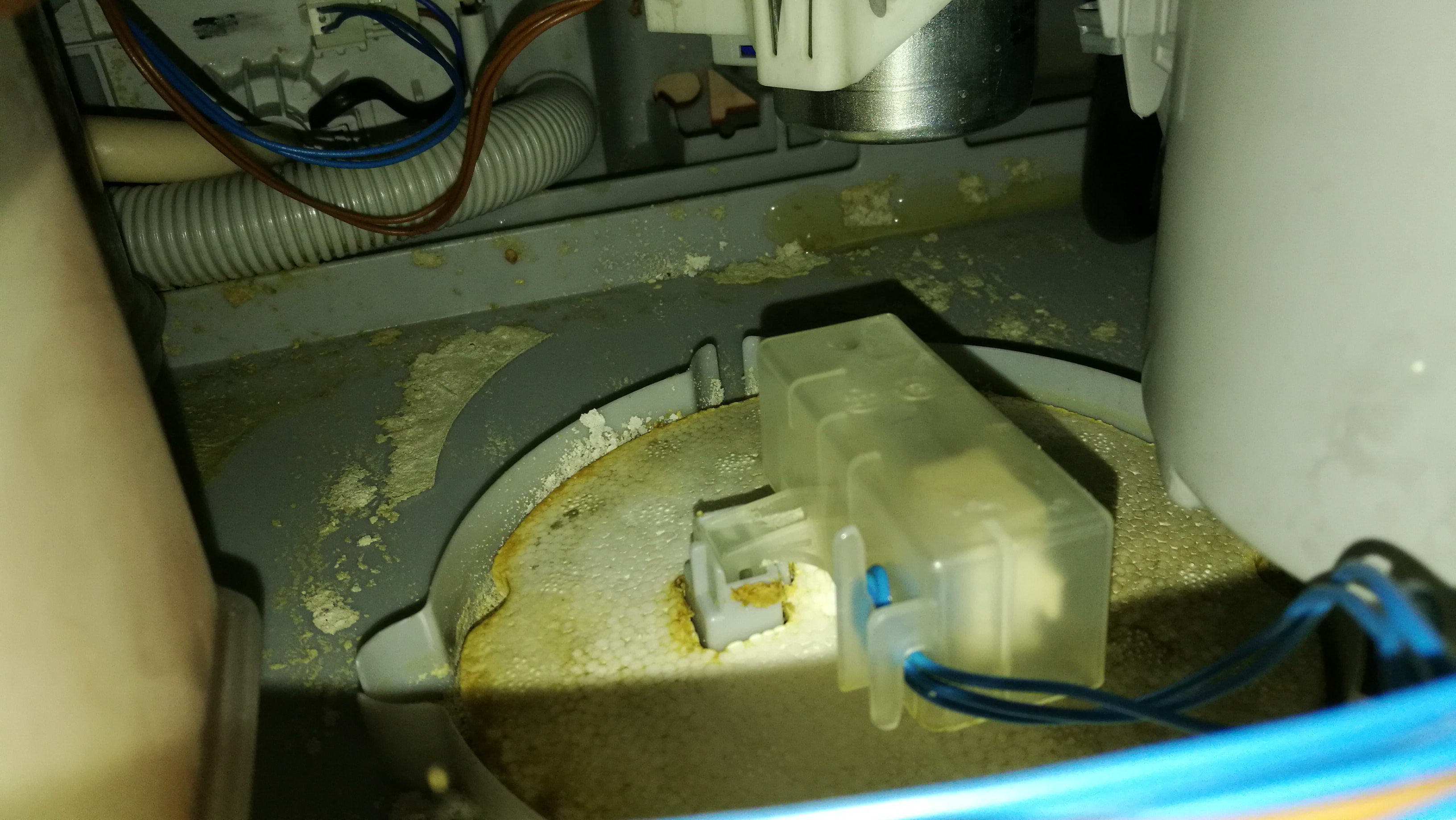

    Cause of a problem
    Repeatedly described leakage at the junction of the dishwasher chamber and a plastic drain pan with pumps and sensors. After about 3 years of use, first, sporadically and in the final stage, water permanently leaks into the dishwasher housing. Water collects in the central part of the bottom where the flood sensor displays the error E15, and then the water is pumped out immediately.
    Below is a view of the humidity sensor. It is a disc of polystyrene which, as the water level rises at the bottom of the dishwasher, flows out and presses a small switch.

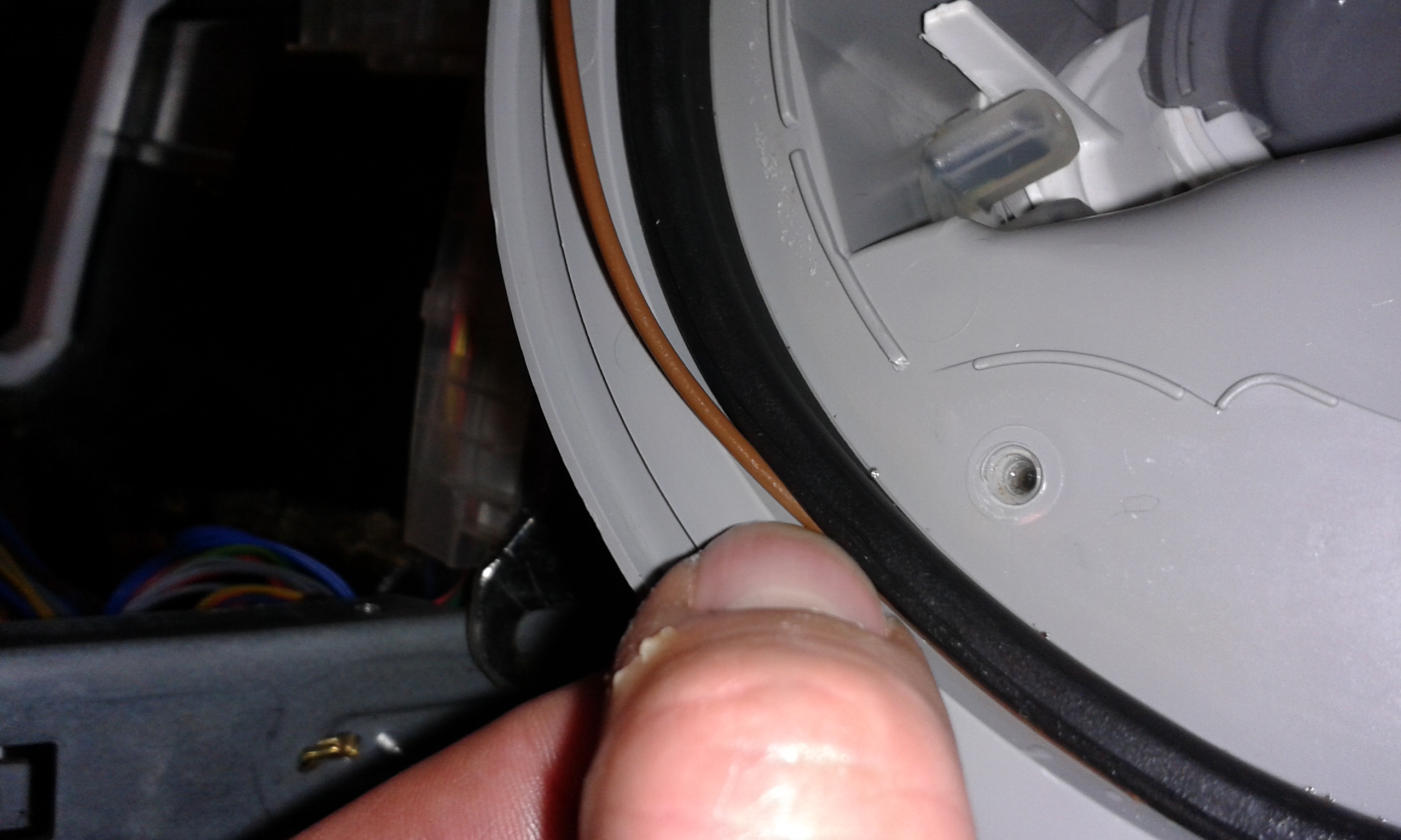

    11 Repair of the gasket. This example shows the obvious bad will of the manufacturer. The gasket could be replaceable, but not ... it was integrated with the bowl and the whole element needs to be replaced. More about it here: Link
    over time, the rubber lost its properties and slightly decreased its cross-section, which means that at high temperature water flows almost around the entire circumference.
    Paradoxically, the fact that it is permanently attached to the bowl allows for a provisional but effective solution to this problem.
    Just gentlyswivel the gasket and insert an electric cable or something similar with a diameter of about 2 mm around the entire circumference of the resulting slot.
    After this easy treatment, the inner diameter of the gasket significantly decreases and when it is applied to the opening in the bottom of the chamber, the play is noticeably reduced.
    The bowl prepared in this way must be screwed in again with 4 screws and a test wash at 70 ° C should be performed. In my case, the problem is over.

    I have similar equipment, namely Bosch edition 45 SilencePlus, I have the same problem, water gets into the emergency tank and there this emergency float turns off the dishwasher and the so-called LED is displayed. "tap".
    After removing the bottom panel and disconnecting the electric ankles, etc. I got to this gasket, and I can't believe the gasket is separate, not integrated.
    Does it make sense to replace the gasket with a new one?
    Is it worth putting only this wire in the center slot?
    Many thanks for the manual, after reading it, I got the proverbial wind in my sails and I started it and I was about to call someone to do this job ...

    It looks like you have a different model of this tank where it was possible to replace the gasket itself. Unfortunately, it is not that cheap because it costs about PLN 70. Look for by part number: 00263102.
    However, I would try it, because it costs nothing to insert this wire into that old seal. If it is not pushing the gasket out and the play is removed, this should help.
    On the other hand, if you have it all broken up, maybe it's worth calling the Bosch service and asking.
    On the outer side of this gasket one could also stick a strip of 3M self-adhesive tape of such a 2 mm (foam) suitably cut to height. The gasket has to reduce its inner diameter because that is where the problem is.
    As for my patent, everything is tight after 10 washes.

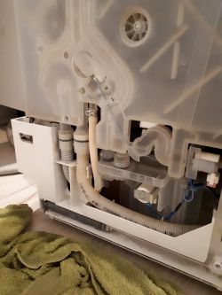

    I would like to add that I got the dishwasher and it stood for some time, so I don't know its history completely.
    It turns on, the pump seems to want to remove the "old" water first, then it pumps "fresh" water and suddenly error E15 flashes and "0:00" appears on the display and the program turns off.
    I am attaching a video.
    [movie: 278e3525c8] https://filmy.elektroda.pl/43_1484177917.mp4 [/ movie: 278e3525c8]
    I undressed it and it was obviously leaking from under the gasket - a lot of traces. Unfortunately, now I am not able to verify it because it turns off. I also checked the float with aquastop, but it was dry there.
    Can you tell anything based on the photo and the video?

    Buddy, you need to check if there is water at the bottom of the dishwasher and how to get rid of it. Then turn it on and look if it is dripping somewhere and from where? If it does not drip, and an error turns on, I would check the sensor on the float, it may throw out false errors.

    I undressed, turned it to the side, poured out the water, connected it, lit it, turned it on and ... it flies from under the seal of this large round :( where do you buy spare parts? Is it easy to replace?
    Bosch SMI40M35EU Dishwasher Error E15: Affordable DIY Solution for Leakage & High Temperature
    It flies in the place marked in red. I have a problem how to do it. I have to take off the gray element marked in green, but I don't know how much.
    Added after 3 [hours] 34 [minutes]:
    Taken according to the author of the post. So far, everything is fine and nothing is leaking :)
    Thank you for the detailed and legible description :)

    I am asking for your understanding in advance because I am a complete layman in the subject of dishwashers.
    I have a similar problem as in the topic. After turning on any program, the dishwasher works for a minute and an error E15 and a flashing tap pops up, which, as I learned from this topic, means an internal water leak. Indeed, the leak is quite a bit because there is a puddle on the floor, so the diagnosis is made.
    According to the instructions in this thread, I took the dishwasher apart, cleaned the gaskets and sealing areas, checked if they were free from damage, everything seemed ok.
    I run again .. Same. a moment came and an error e15 popped out. Well, the dishwasher on the "back" I poured water that had accumulated on the bottom, I took off the side covers and let the dishwasher go to locate the leak. It turned out that the leak (and quite a lot of it) is in the place shown in the picture. Bosch SMI40M35EU Dishwasher Error E15: Affordable DIY Solution for Leakage & High Temperature Bosch SMI40M35EU Dishwasher Error E15: Affordable DIY Solution for Leakage & High Temperature
    When cleaning the dishwasher, I noticed that there is something wrong with these connections, but as I mentioned before, I do not know dishwashers and I do not know what it should look like.
    Do you have any idea what happened to it and why is the dishwasher throwing water out there? Can it possibly be repaired? I'm counting on your help !

    Remove the coat and determine what is happening with the seals.

    Anyone have a picture of what this connection looks like when it is properly assembled? Because for me you can see with the naked eye that the connections are assembled incorrectly, maybe I miss some part there. I will add that I do not know the history of the dishwasher.

    The left port in the photo looks properly sealed, but the photo may look, and reality may show something else.

    Both connections are leaking, water is gushing out. The problem is that I do not know what these connections should look like when they are additionally sealed and the search for some photos was unsuccessful.
    Maybe some of you have photos of these connections in your dishwashers or know how it should be sealed properly?
    There are some plastic rings inside these nipples that fly around loosely but I don't see any o-rings on them.
    Is there any chance that it could have unsealed by itself or has someone fumbled with it before?
    The whole thing looks like something is missing, because it is a "rigid" connection without any hoses, and yet the elements do not fit together, ie the stubs are too short to fit into each other and seal well, but these are only my observations.
    If any of you were so kind as to enlighten me about the tank with which this mantle is connected, I would be grateful, because it will be easier for me to look for solutions.

    In my opinion, nothing is missing there. The black ones are the rubber seals. Perhaps someone has put silicone on there and the seals are not in place. The one on the right looks pushed too deep. These seals are unlikely to wear out. If it starts to leak here, there is something blocked behind the connection and there is pressure build-up here. You need to remove the water jacket and check the flow towards the bowl at the bottom of the dishwasher.
