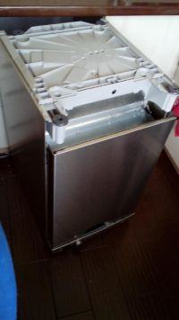

    Gentlemen, how to take off this cover? In the materials found on the Internet, the cover is made of metal and you just need to bend the protection a bit. But in my case it is plastic and there is a strange hole in the front with pictograms suggesting opening this plastic with a tool. Can someone help me?
    Bosch SPS53E08EU / 01 dishwasher - error E09 and no temperature. Bosch SPS53E08EU / 01 dishwasher - error E09 and no temperature.
  • #4 16482708
    ROBSON33
    Admin of household appliances group
    Posts: 9730
    Help: 465
    Rate: 1714
    Leave it alone, turn the side and get to the pump.
    Why disassemble the whole thing, unless you have nothing to do and you want to buy a new dishwasher.

    Wish it were that simple. Just the side is somehow connected to the bottom, I have no idea how to do it. I do not want to destroy the plastics and hence my question. There is certainly a way that allows you to remove these covers. Besides, to remove the pump I have to pull the bottom cover, unfortunately I do not know how. I tried to make a movie that shows how everything is connected to each other.

    Looking after the photo, the friend probably wants to buy a new dishwasher ... first rule, do not put such a device upside down. Let's agree that it is allowed to put only the back, so it will be definitely safer for the dishwasher.
    In general, to take the base in turn you must
    - remove the sides of the dishwasher
    - put on the back
    - take out the front legs
    - unscrew the sheet under the door
    - dismantle the door pulls
    - straighten the bent sheet of the washing compartment in the rear upper part of the base
    - from the front of the base either there are two screws from the front or on the sides hooks that need to be lifted.
    - pull out the base and unhook the module from it
    to get to the power cube of the heater and measure it, the first four points are sufficient
    In general, due to the removal of the base and its brazier assembly, if you do not have a combat mortar to bury in the equipment, I would not recommend that you attack it yourself

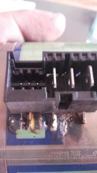

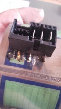

    I managed to undress the dishwasher, in fact the manufacturer did everything on the crimps to make it more difficult to undress. After removing the heater, it looks like it. How do you think it can be fixed?
    Bosch SPS53E08EU / 01 dishwasher - error E09 and no temperature. Bosch SPS53E08EU / 01 dishwasher - error E09 and no temperature. Bosch SPS53E08EU / 01 dishwasher - error E09 and no temperature.
  • #12 16488467
    nares
    Home appliances specialist
    Posts: 8717
    Help: 1515
    Rate: 3386
    Some have tried, but with a poor result ... Technologically, it is very difficult.
