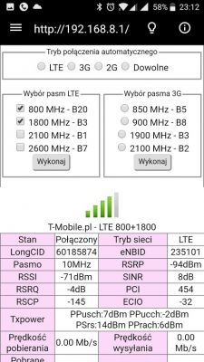

    HManager installation on an Android phone http://www.mediafire.com/file/99t05l2dv6vany8/Huawei_Manager_1.1_PL.apk and tests of LTE1800 and LTE800 bands and LTE1800 + 800 aggregation. You show screenshots from them, you do speedtests. LTE1800NetWorks and LTE800 T-Mobile operate on Centralna, LTE800 in Gostyń. Given the terrain, forests are rather the choice for LTE800 and the antenna for this band.

    Ok, I tested it.

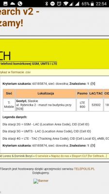

    Thanks for the link to the program. Actually, you were right - on the one hand, seeing GOSTYŃ works LTE800 and allows you to use max bandwidth from TMobile (I have 20DL).
    In real life it looks like this
    4G Antenna Selection for Huawei B529: Improve T-Mobile 60Mbps Connection in Rural Areas
    And transfers on this (the same are as soon as I choose LTE800):
    The right frequency column is offline at all.
    Turning two on at once (you seem to call it aggregation) doesn't give you visible improvement. Transfers are going smoothly - although this morning there was hiccups for 15 minutes and practically nothing worked.
    The program shows such information about the visible mast:
    The router set in the window - at a height of 1p. Without external antenna
    What does it look like from your point of view?
    How would you rate the BTS load?
