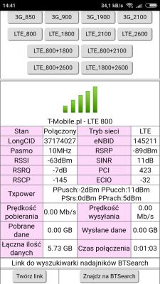

    Hello!
    I have an offer from t-mobile for home internet up to 60mb / s with Huawei b529 router
    I would like an antenna for it because the signal is not stable.
    my location: 53?55'51.31 '' N, 17?44'46.87 '' E
    89-632 Lubnia
    Regards

    Have you done any LTE signal tests, forced LTE1800, LTE800 bands using HManager? Range on LTE800 T-Mobile from BTS Leśno, Wiele and Brusy-Chełmowska 12. On the latter also LTE1800NetWorks and aggregation LTE1800 + 800.

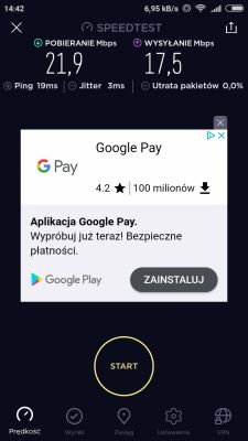

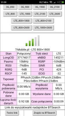

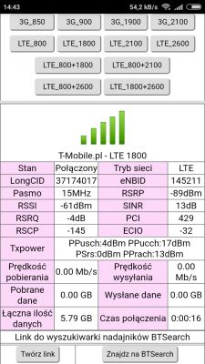

    KadiosPL

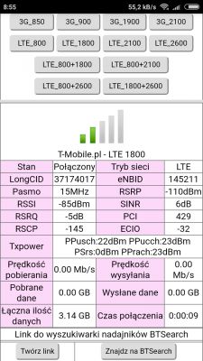

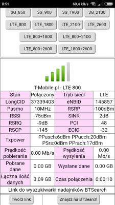

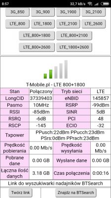

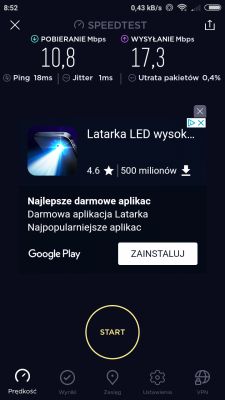

    I did tests with HManager and Speedtest and these are the results
    LTE 800:
    Best Antenna for Huawei B529 Router: Improve T-Mobile Home Internet Signal (Up to 60Mbps) in Lubnia Best Antenna for Huawei B529 Router: Improve T-Mobile Home Internet Signal (Up to 60Mbps) in Lubnia
    LTE 1800:
    LTE 800 + 1800:
    if something is missing I will add

    #4 17372307
    matek451
    Posts: 31254
    Help: 4352
    Rate: 5808
    LTE800 from BTS Leśno. Signal sufficient, just like speed. LTE1800 and LTE1800 + 800 from BTS Chełmowska, weak signal, but not bad SINR and DL. Put B529 out the window and repeat the tests. Generally, there are two options, i.e. LTE1800 and LTE1800 + 800 with BTS Chełmowska on a broadband antenna or setting to LTE800 on a directional antenna at 800MHz. With this selection, the option of forcing the connection in turn with each of these 3 BTSs are in different directions and the optimal choice.

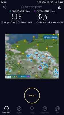

    #5 17372603
    KadiosPL

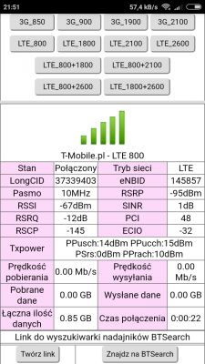

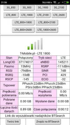

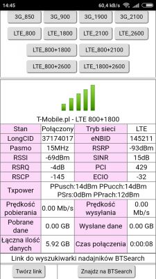

    So today I did the tests as you said and here are the results:
    LTE 800:
    LTE 1800:
    LTE 800 + 1800:
    Added after 2 [hours] 24 [minutes]:
    So what antenna will it be? provide a link to such an antenna

    #6 17373027
    matek451
    Posts: 31254
    Help: 4352
    Rate: 5808
    Strange outside results, a signal like at home? LTE1800 + 800 aggregation does not work. Up to LTE1800 antenna http://www.cybertech.com.pl/p170,antena-dualna-lte-4g-15dbi-do-huawei-b529-b528-mimo.html Up to LTE8002x antenna http://www.cybertech.com .pl / p89, antenna-atk-10-13dbi-lte800-umts900-gsm900.html cables up to 10m and connector TS9. To LTE1800 + 800 http://telkob.pl/inkontrahent.php?t=2125&g=386&q=&r=0&rg=0&sg=

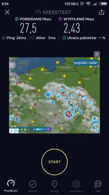

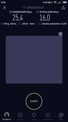

    #7 17373050
    KadiosPL
    Just with the signal with us on average, sometimes on GSM there is sometimes no
    I can do tests from another side of the house
    Added after 39 [minutes]:

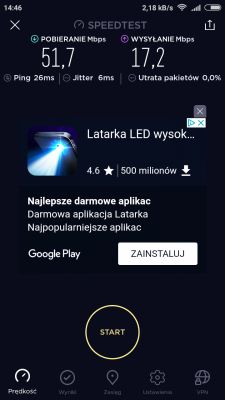

    ok, I decided to do tests from the other side of the house on the balcony facing Brusy.
    Until I was surprised
    LTE 800: Best Antenna for Huawei B529 Router: Improve T-Mobile Home Internet Signal (Up to 60Mbps) in Lubnia Best Antenna for Huawei B529 Router: Improve T-Mobile Home Internet Signal (Up to 60Mbps) in Lubnia
    LTE 1800:
    LTE 800 + 1800:
