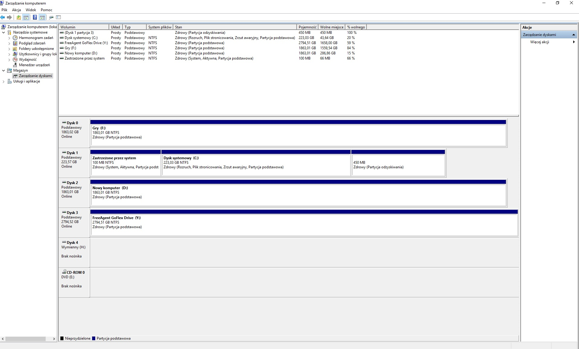

    Welcome. Drop the disk management screen.
    #3 16779799
    jerzyf
    Posts: 512
    Help: 47
    Rate: 198
    It is a partition style issue, MBR supports disks up to max. 2TB, and above must be GPT style. Read about GPT on the net, but it must be supported by your CD.
  • #4 16779819
    jackobt
    Posts: 125
    Rate: 8

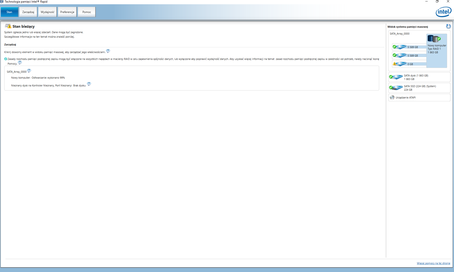

    In the attachment I am throwing two screenshots, one from the computer management, the other from the Intel Rapid program.
    My motherboard is Gigabyte Z97X-Gaming 5

    I guess you didn't expand the capacity after rebuilding RAID 1. Sometimes there is no expand capacity option or something like that? It shows you 6TB disks and 2TB surface in the program.

    The problem is that I approached the whole matter several times and extended it earlier, with this approach I actually forgot :) In any case, the extension does nothing, unfortunately. After initializing and loading the bar to 100%, still nothing. The Intel Rapid program sees this RAID1 with a capacity of ~ 6TB, but unfortunately the system itself does not.
    I have the impression that my colleague Jerzyf is right in this matter and it is a matter of partition style. I'm looking for information on how to do this. Do you have to format the system disk then? Maybe my colleagues will tell me more about how to properly carry out the entire process?

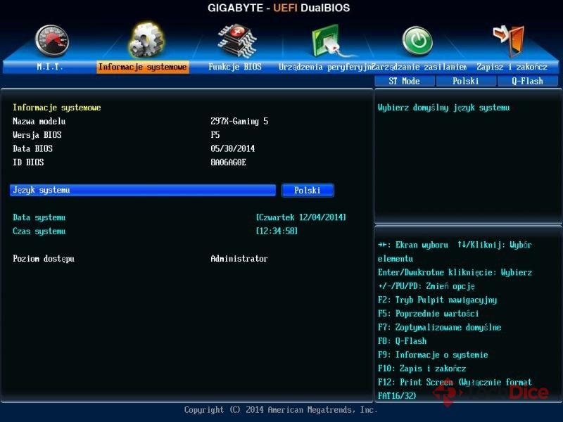

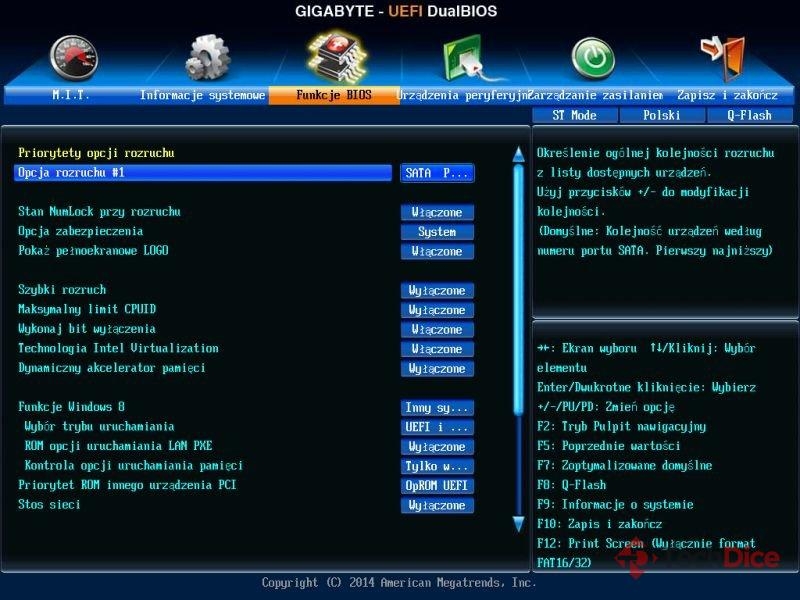

  • #10 16783877
    PitD
    Posts: 3957
    Help: 431
    Rate: 237
    Replace Legacy / CSM mode with UEFI only
    Boot mode selection: UEFI
    Besides, you have UEFI DualBios
    Windows 10 PRO - 6TB RAID1 Drives Showing 2TB Partition: Disk Capacity Limitation or Error?
    Then disk conversion. Maybe you will be successful.
    If not, you will have to put the system up again.
