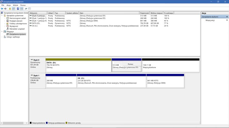

    I installed linux on HDD and divided the D disk into 2 partitions. After some time, however, I wanted to remove this additional system (because the main one is Win10). So I deleted the volume, this picture is the 138GB. He then became unassigned.
    And now I don't know how to combine these 2 partitions into one 1 terabyte disk.
    Combining Two Partitions into One 1TB Disk: Merging Linux & Win10 Partitions (How-to Guide)
    I get this notification after trying to extend the volume (the one with 792GB).
    How can I combine these volumes into one whole disk?

    Can you delete the 513 MB partition?
    tymos1 wrote:
    That topic won't help me
    If you read the indicated topic carefully, you would know that you cannot combine two partitions that are separated by another partition.

    I can't because it's probably a system partition
    When I right click, only the "help" option comes out
    Added after 3 [minutes]:
    I know that.
    So how did linux split them up before installing?
    And there is such a program what will delete these partitions for me and do one?

    I think it's about removing GRUB, link . link .
    Not wanting to mislead you, please confirm other colleagues.

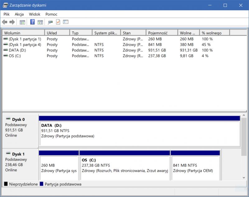

    I found the crack Ease US Partition Master version and this program repaired the whole disk for me: I converted the disk from dynamic to basic and removed all partitions on this disk, and then I created one partition from it.
