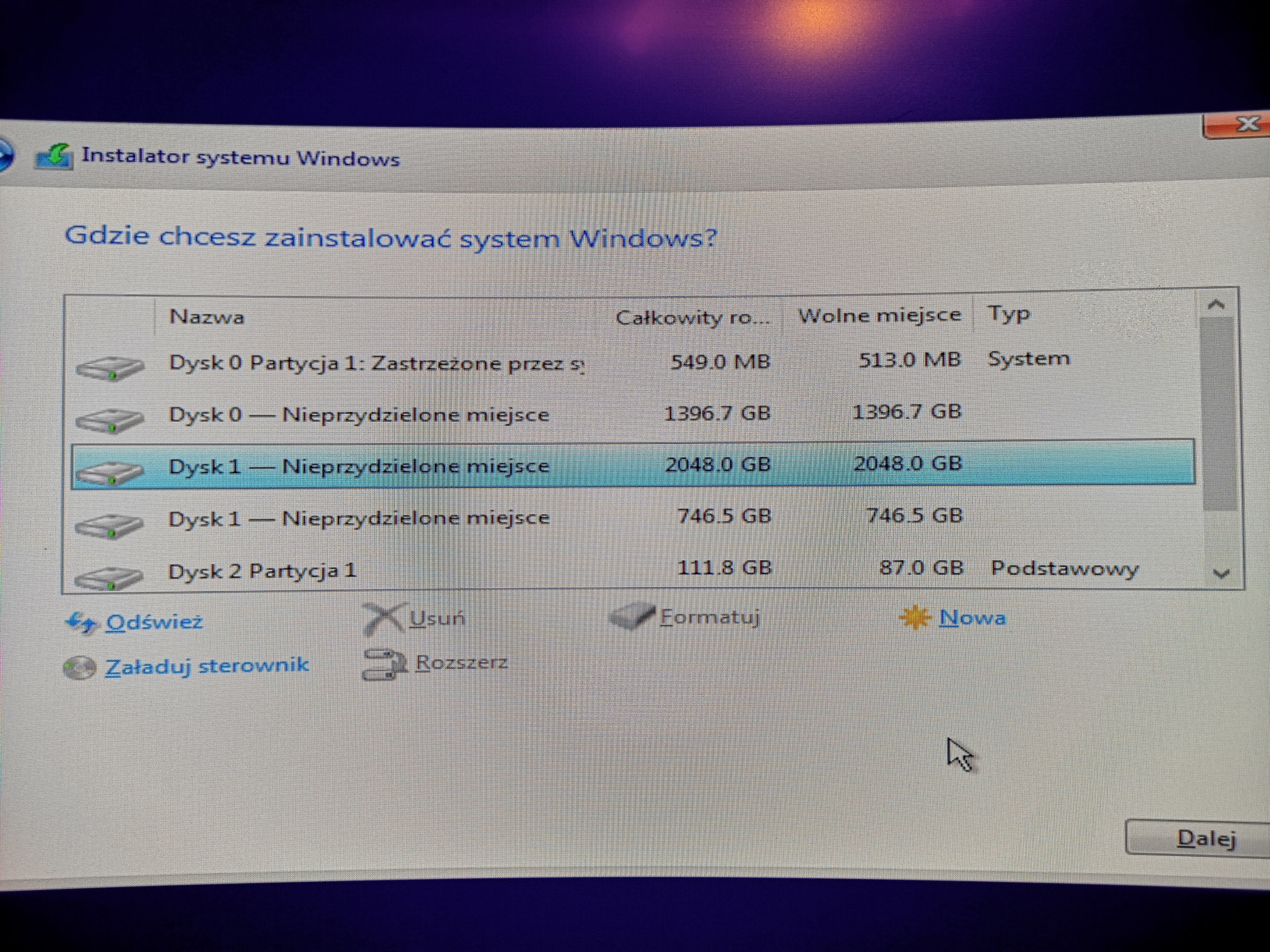

    when creating a 746.5 GB partition, an alert pops up "we couldn't create a new partition error 0x80042468"
    I have the original version of win 10 home version 64 bits
    please help.

    I used the support a lot before and it didn't help. that is, converting the disk to gpt was successful (I followed the instructions, you know), it showed me a 2.7 TB partition later, but when I wanted to create a 2.7 TB partition, an alert with a different numbering appeared, then the problem returned to the exit point, i.e. partition 2, 7 Tb gave me two 2048 GB and 746.5 Gb and an alert appeared with the error 0x80042468.

    WIN 10 0x80042468 - We were unable to create a new partition error 0x80042468
    before converting to GPT
    the conversion run itself
    after the conversion is completed and the system is restarted
    attempting to create a 2.7 TB partition
    error 0x80004005 right after pressing "apply"
    later again `` we couldn't create a new partition error 0x80042468 ''

    Delete all partitions.
    Create one system partition and install the system on it.
    Leave the unallocated space alone. After installing Windows under the system, you will create the remaining partition.

    I have done some updates in WIN10 and it has merged 2 partitions into one. Finally, I got back the unused 700 GB.
    I will not split the disk into partitions because it does not make sense anyway. Better to make folders. It's a pity that I didn't catch at what point it surprised. Thanks for being active. I close the topic.
