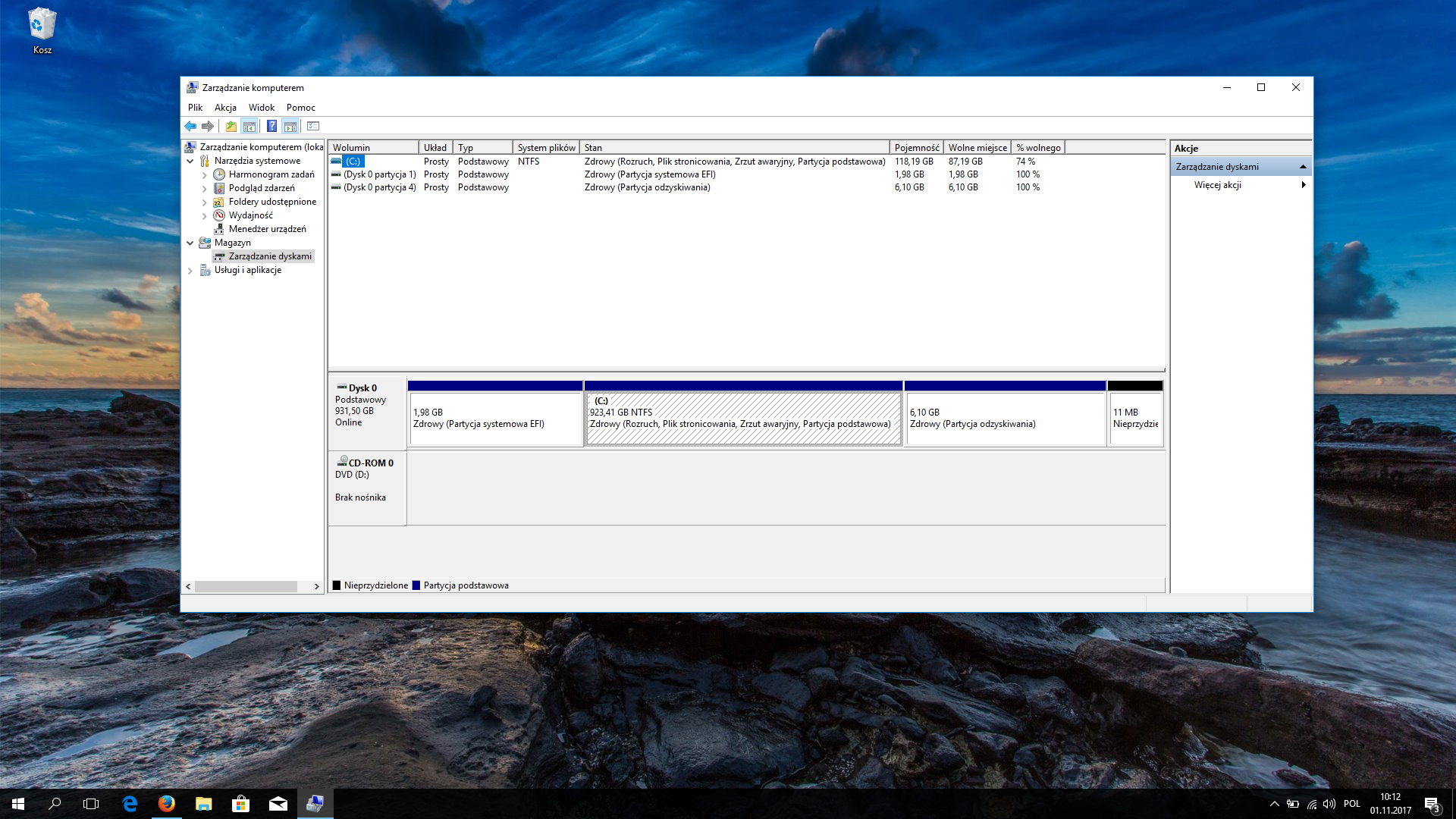

    Hello, my problem is that the newly purchased computer has a 1Tb disk and this capacity is visible in disk management but only 120 is allocated to partitions. How to allocate the rest of the disk or where is it visible? By clicking properties, the expand volume option is not available.

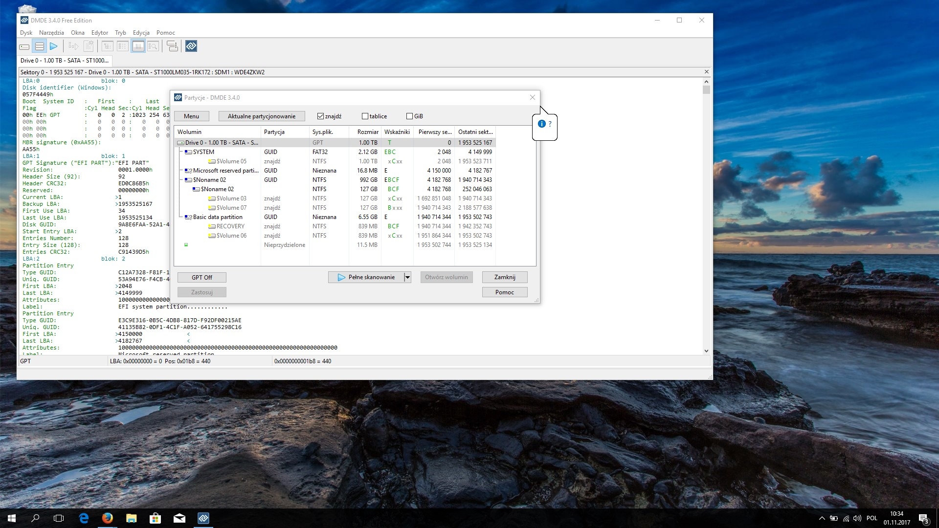

    I see a partition over 900GB there.
    Show screen from the partition layout in DMDE.

    On the volume list at the top - 118.19GB. Windows 10 pre beta version continues.

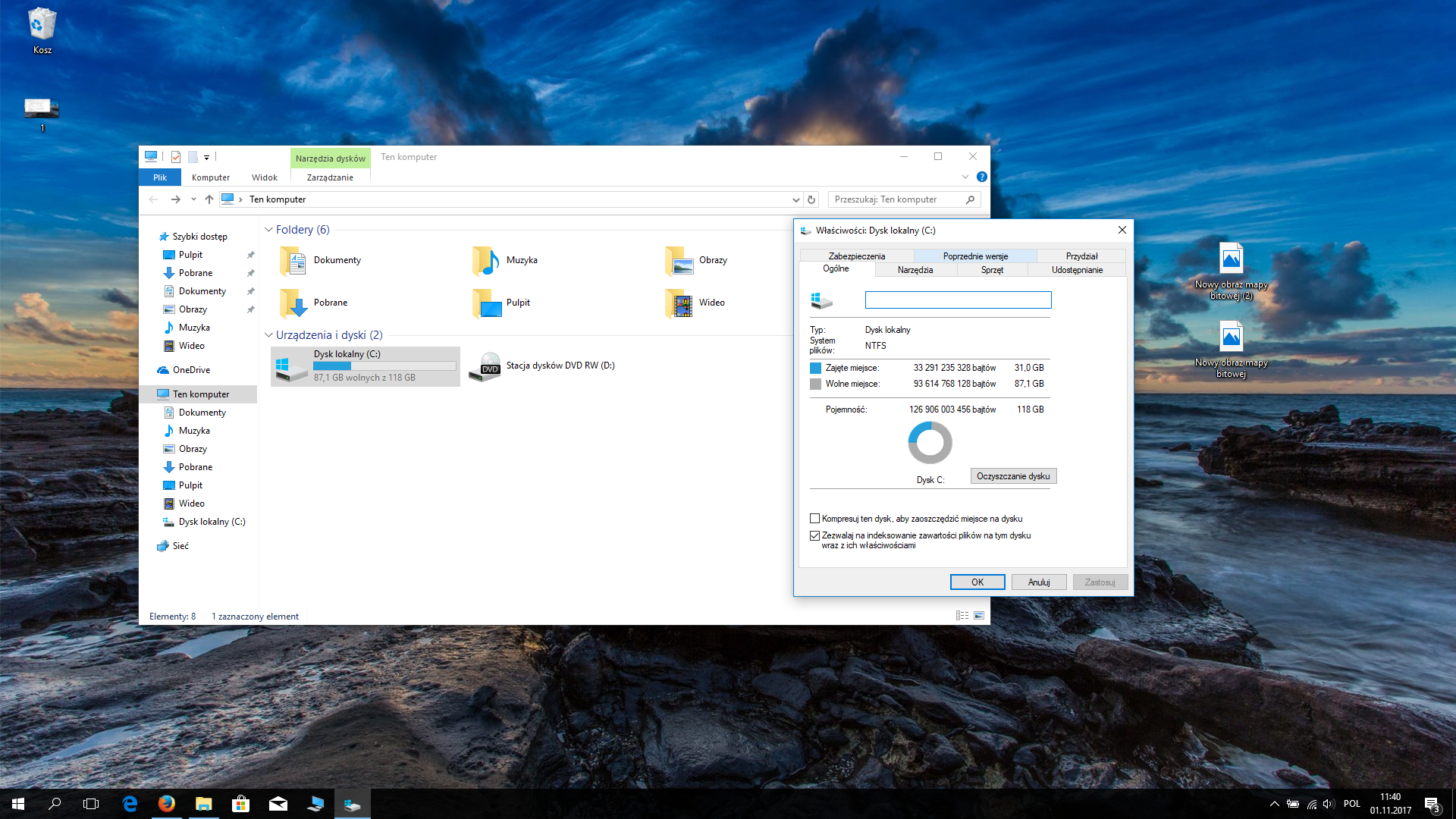

    To the author: see in the disk properties (my computer) how much space you have on the C drive:
    It looks like a bugged disk management snap-in. Nothing new in the "ten".

    Apparently there once was a 120 GB partition (maybe a cloned disk), anyway, these are just Windows anomalies.
    Do you have the option to connect this drive to another computer?

    poole18
    Posts: 7
    C 118Gb disk capacity in properties
    Unfortunately, I can't connect it elsewhere.

    Advertise equipment. In fact, it looks like pre-cloning from a smaller medium and GPT groats have been made - 2 volumes are "Noname 2" - one 992GB invisible and the other 127GB separated on the first visible as a logical disk. You can't handle this configuration, because you would practically have to reinstall the system with disk repartitioning. Then the recovery partition goes into space. You can finally try to run system recovery, but I bet it will reconfigure as a 127GB system partition.

    According to me, I need to correct the partition table and extend the volume on the system or create a second data partition.
    PS $ Noname 02 is the same partition.
    $ Noname 02 BCF - valid partition.
    $ Noname 02 EBCF - damaged partition - incorrectly entered into the table.
