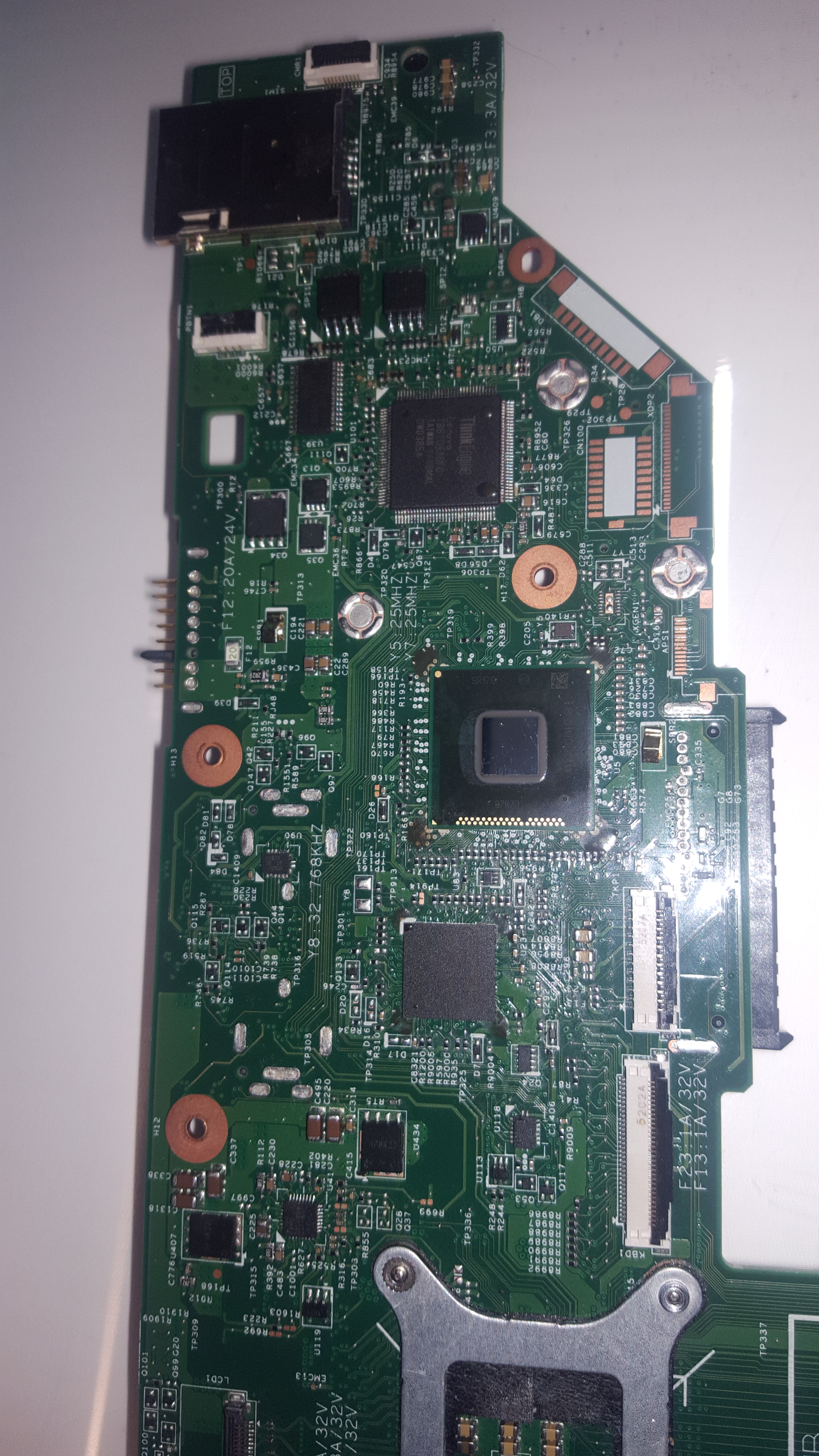

    Hello everyone.
    I have a damaged Lenovo W541 dead. I need to program MEC16333L, but it's hard to find a pinout of this system.
    Does anyone of you have such a list where I can find TDO TDI SCK TMS VCC GND? Or someone knows where it "lies" on the internet, please give me any hint or link.
    Thank you in advance.
    Danao.

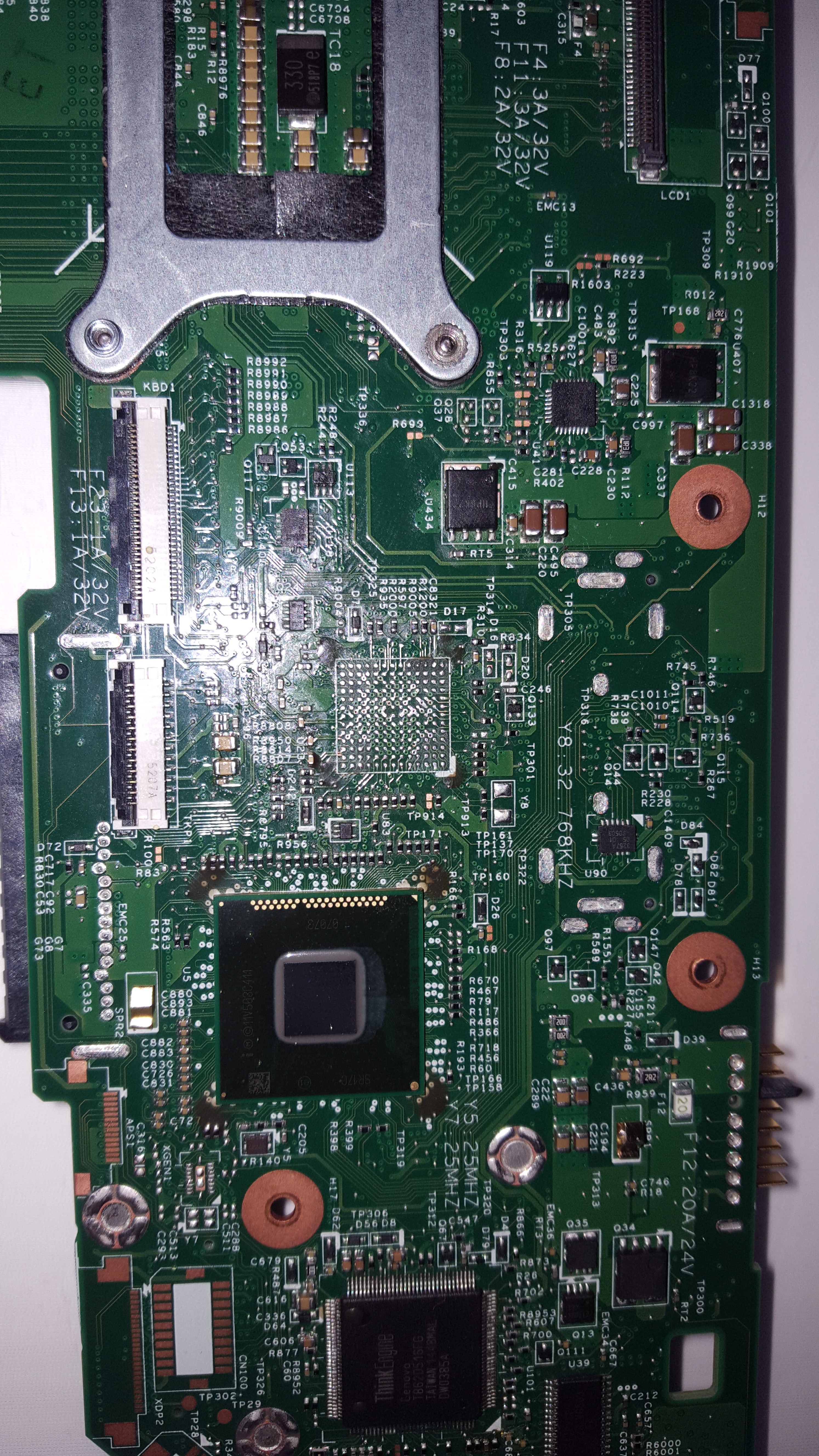

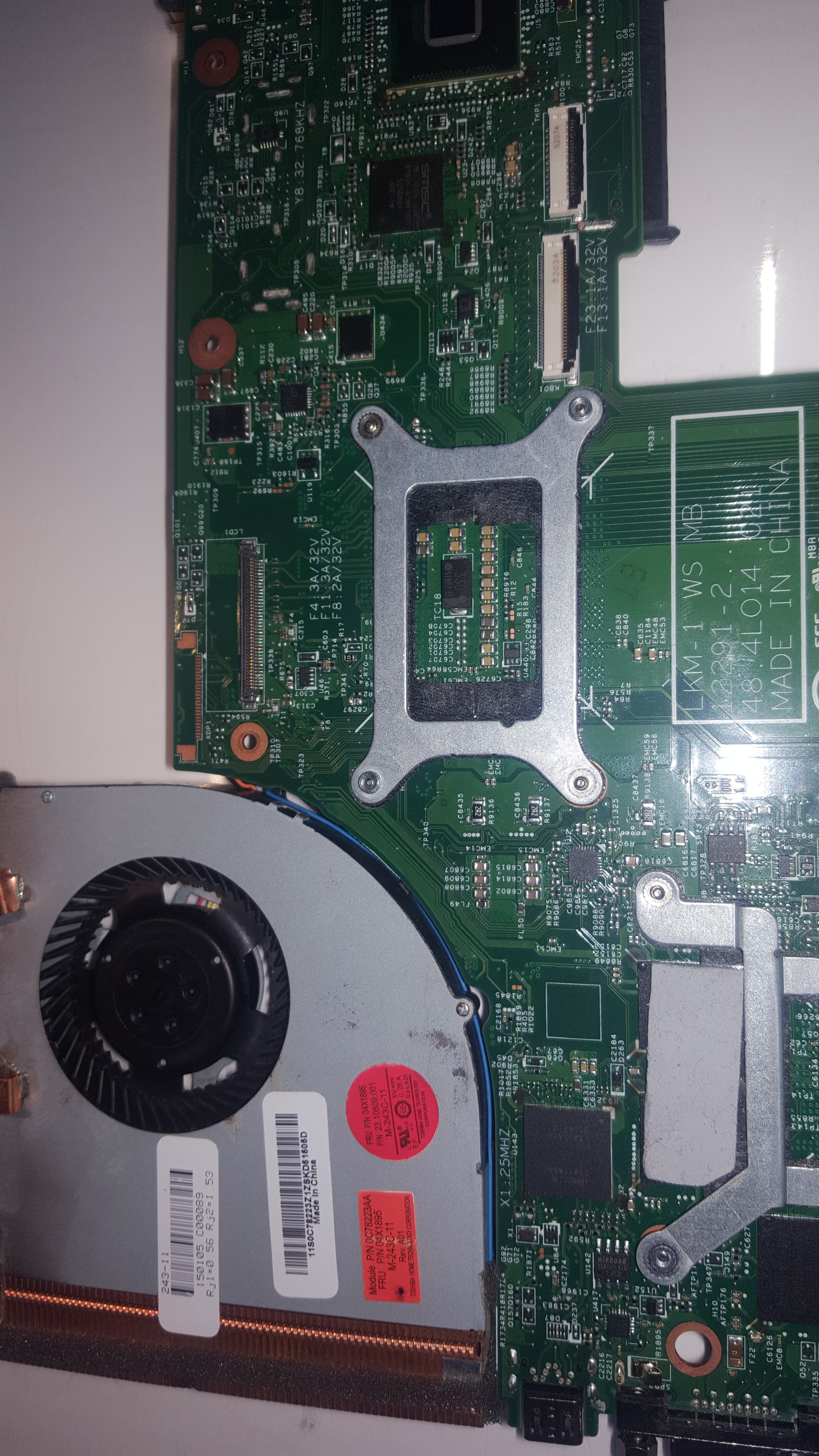

    Take and post pictures in high resolution on both sides of your disc. Mostly, manufacturers placed a socket or a place for soldering the jtag socket. The disc label will also be useful.
    Besides, if it's like MEC1609 then you have to put it into bootmode state. One of the pins must be shorted to the ground.
    On elvikom there is my post on this topic (mec1609).

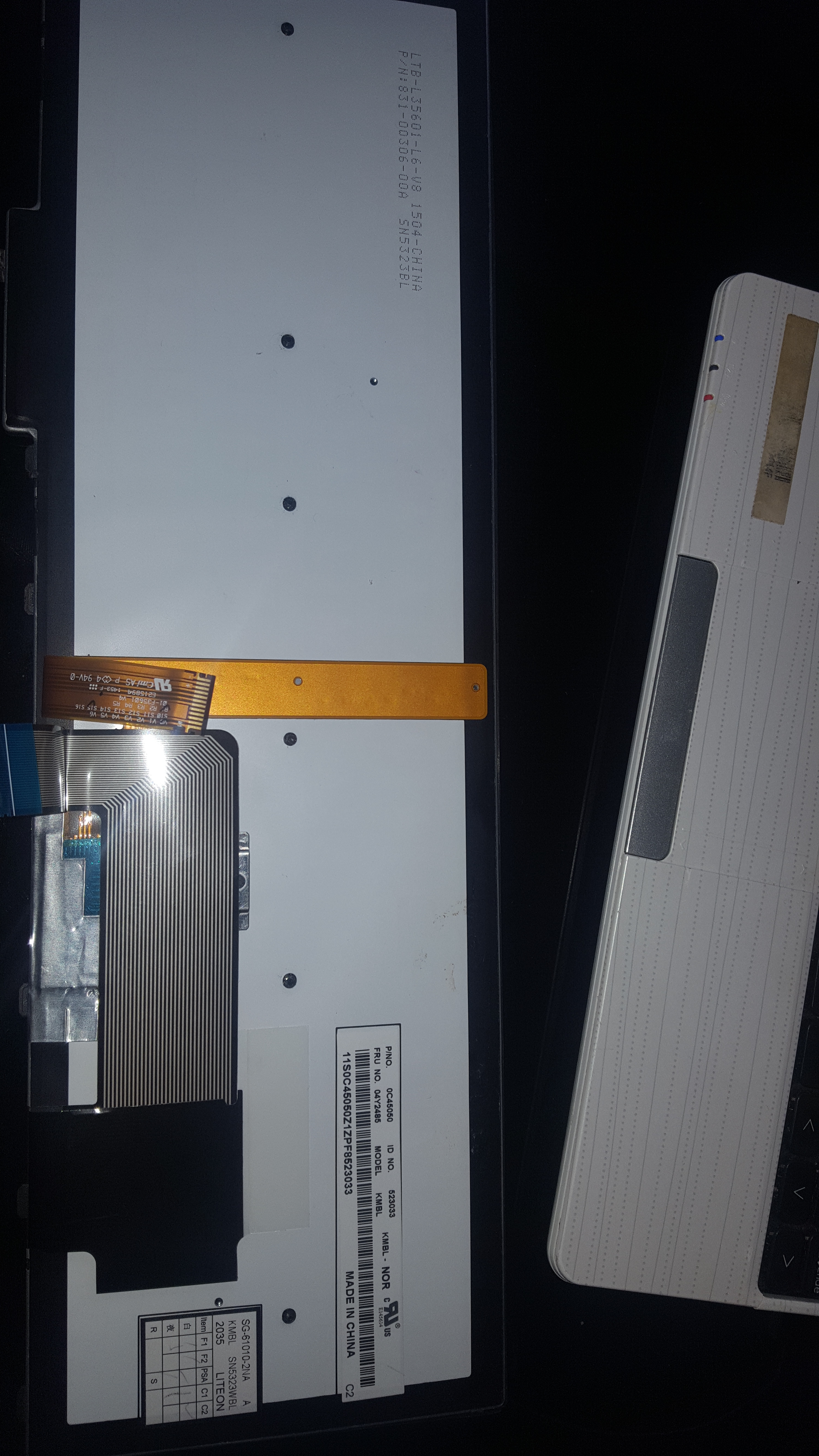

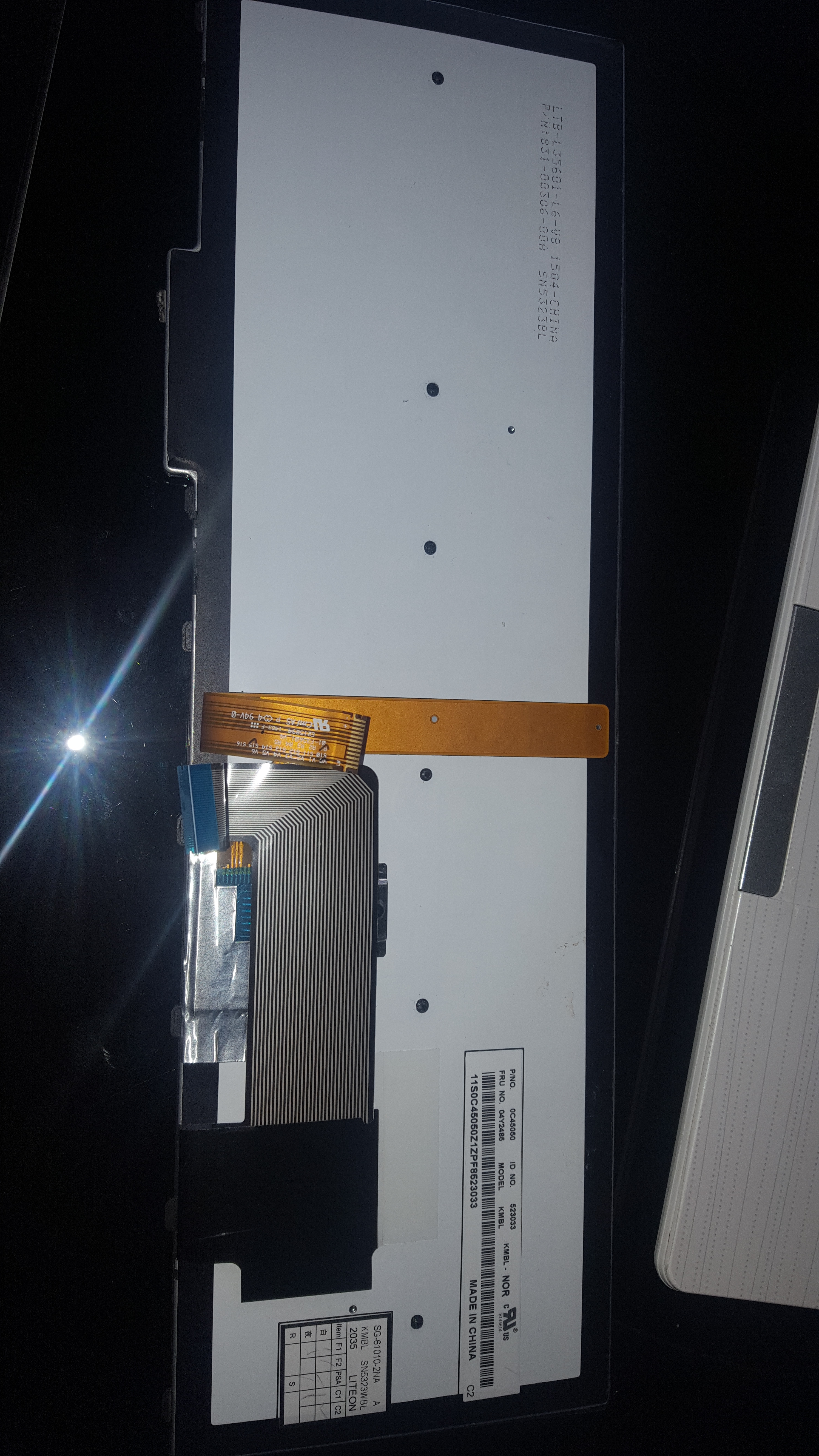

  • Request for W541 keyboard connector pinout and programming pads
    #4 16788809
    danao
    Posts: 949
    Help: 26
    Rate: 19

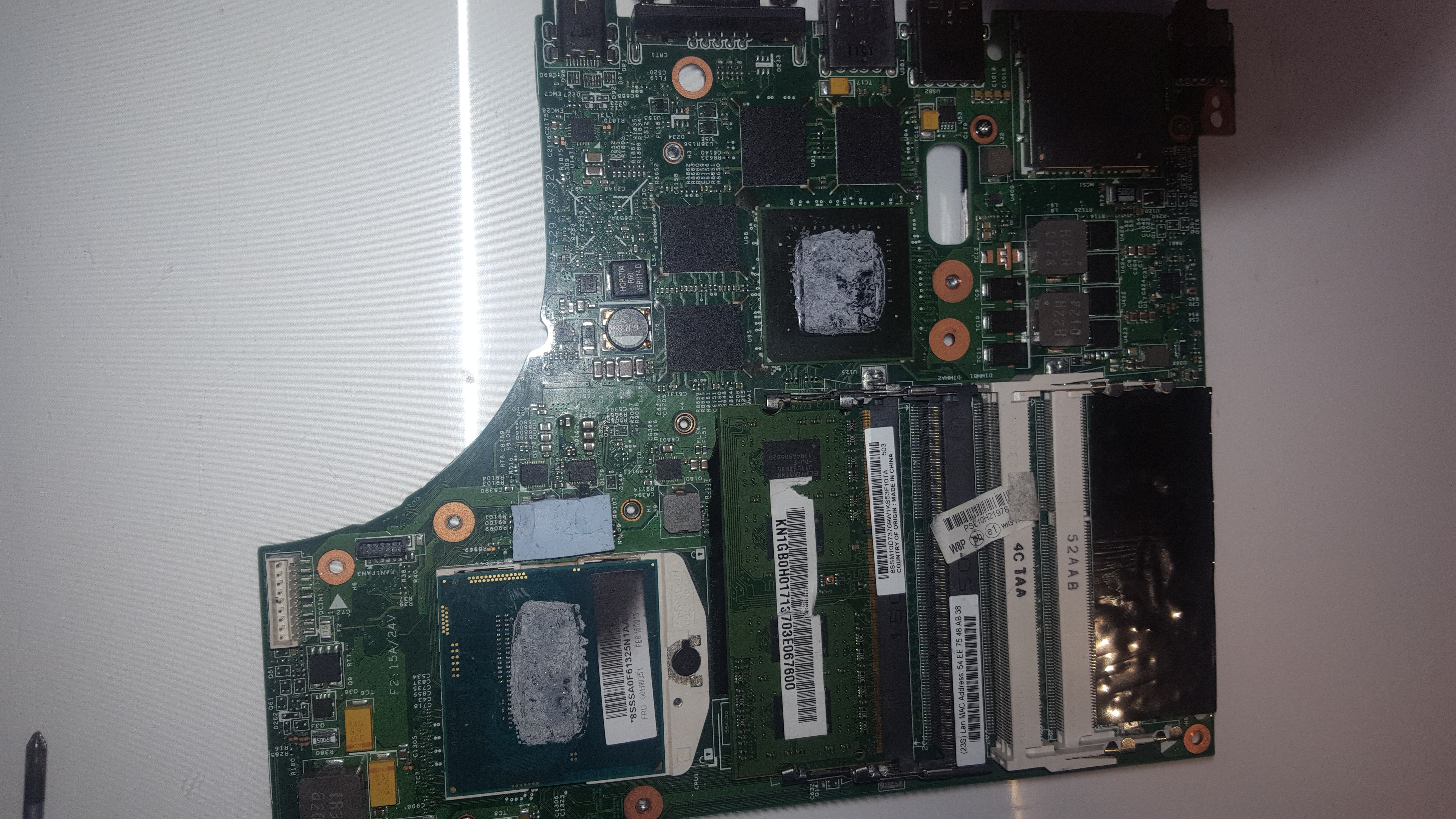

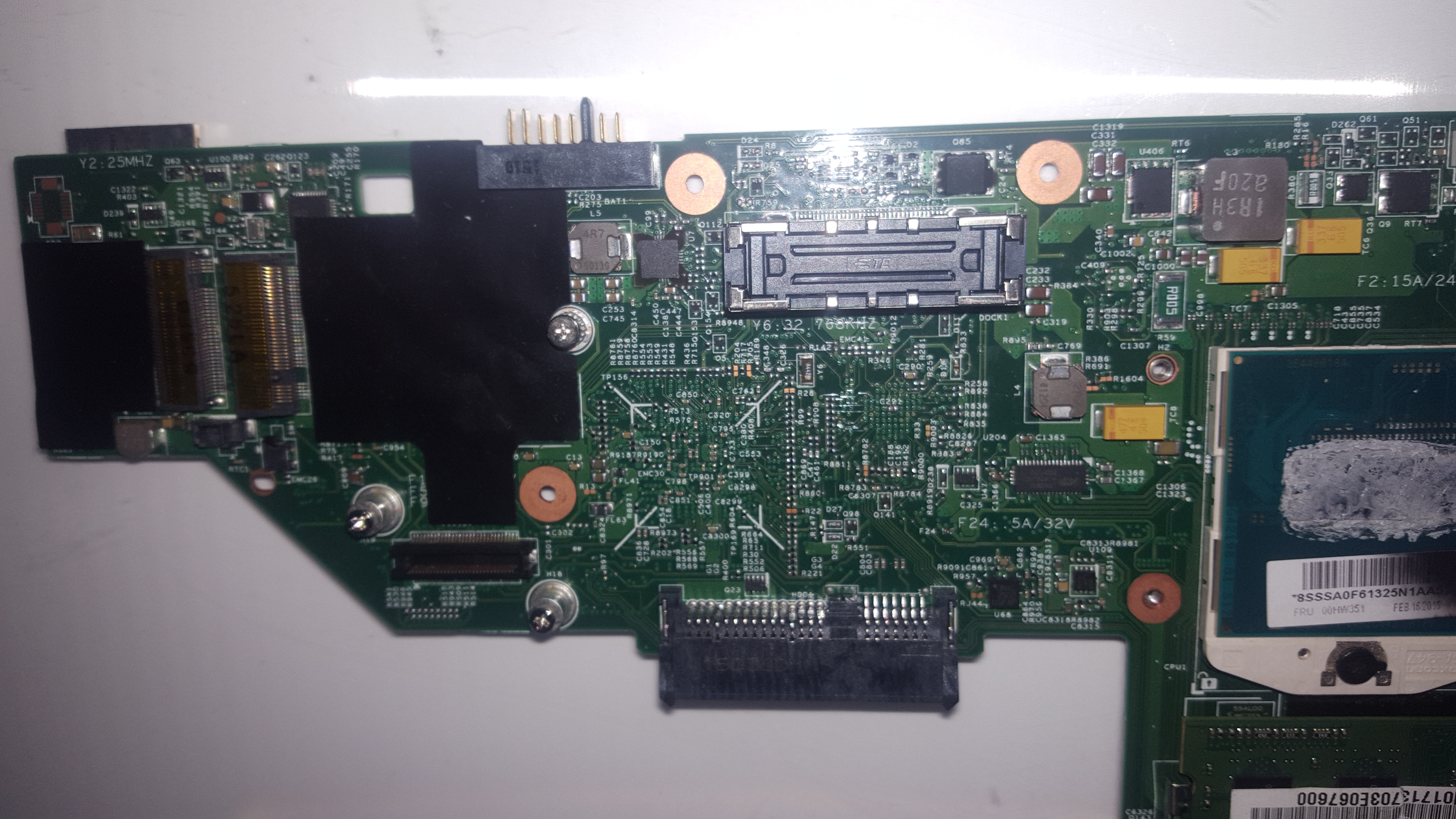

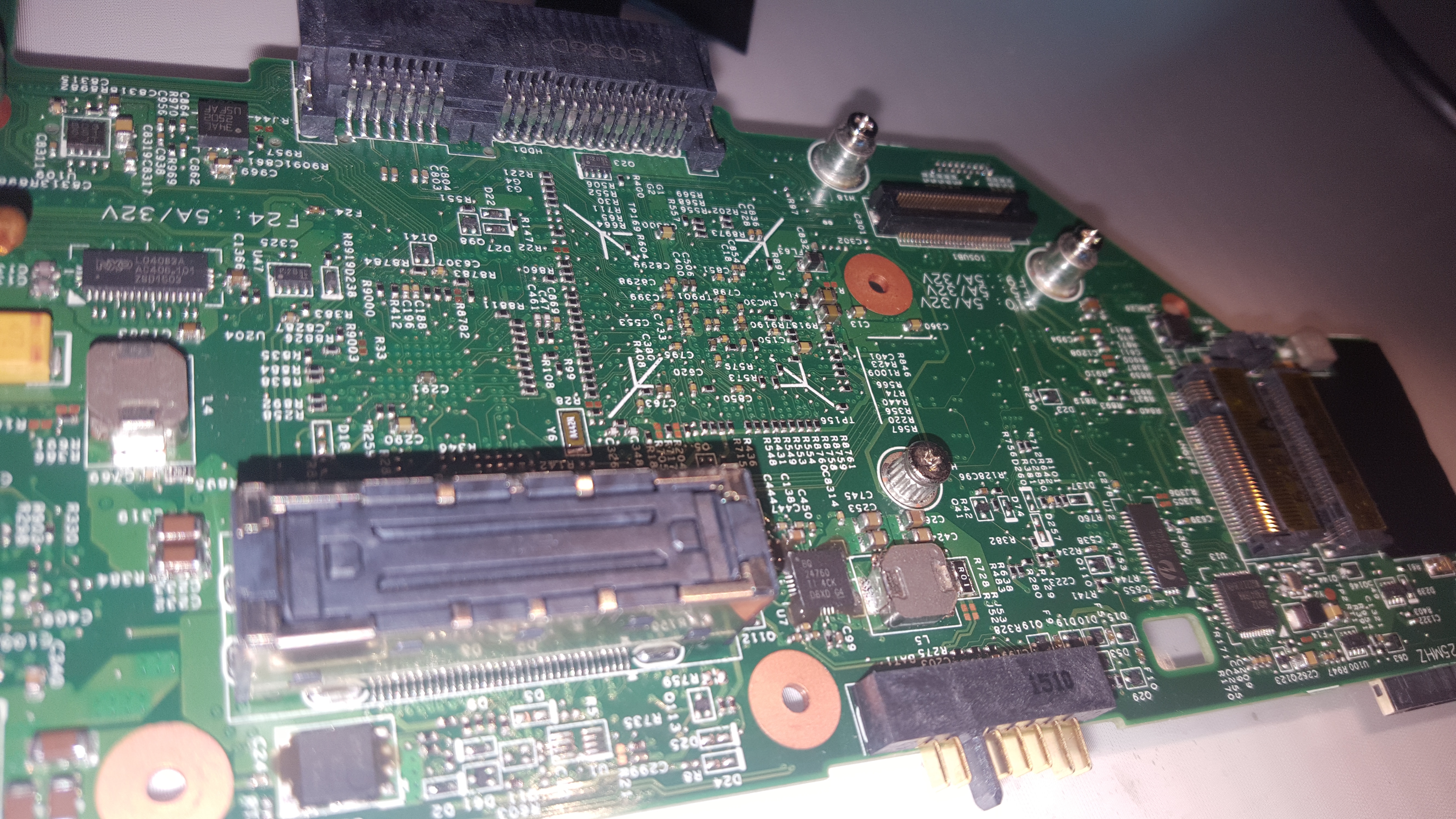

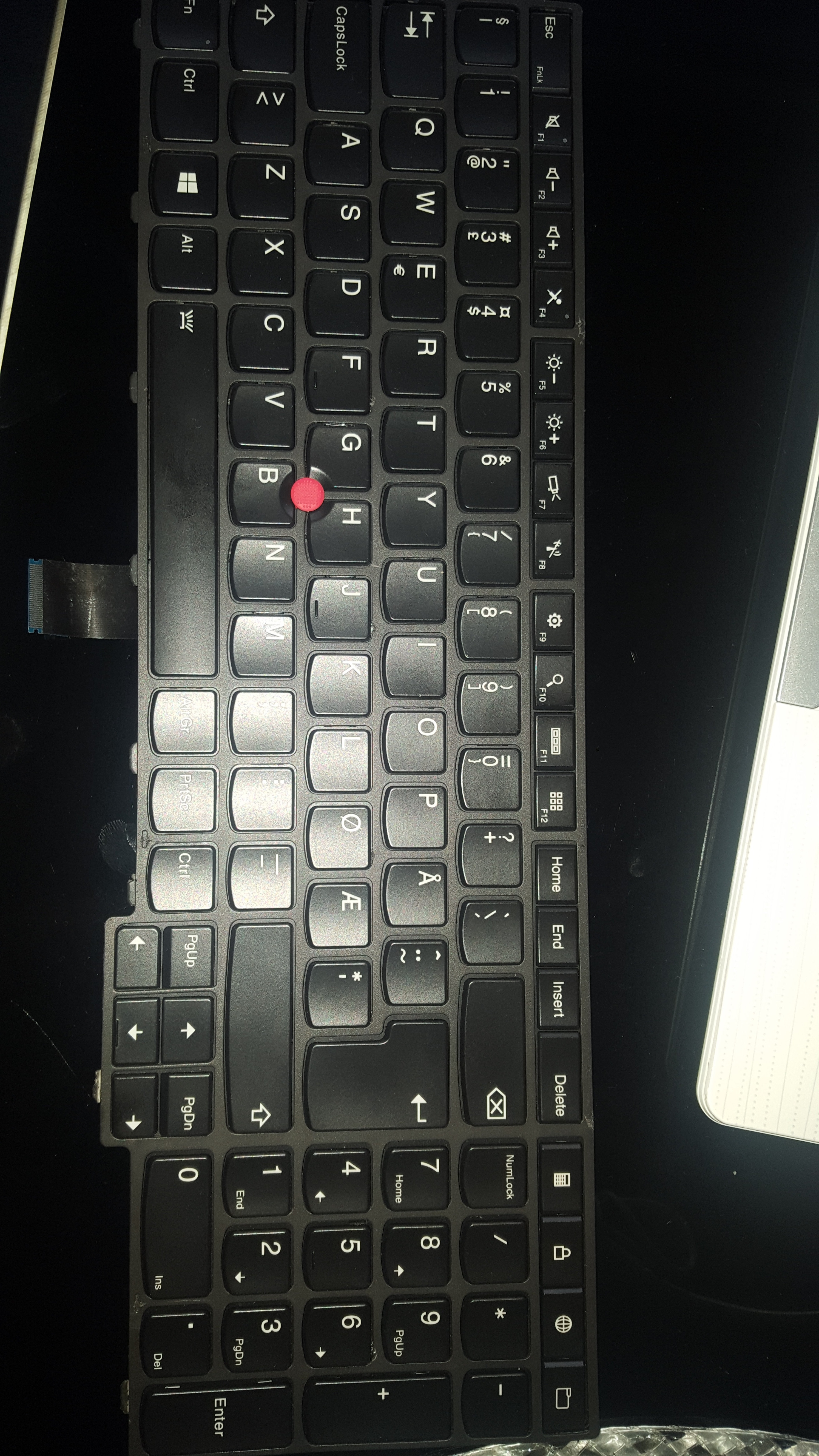

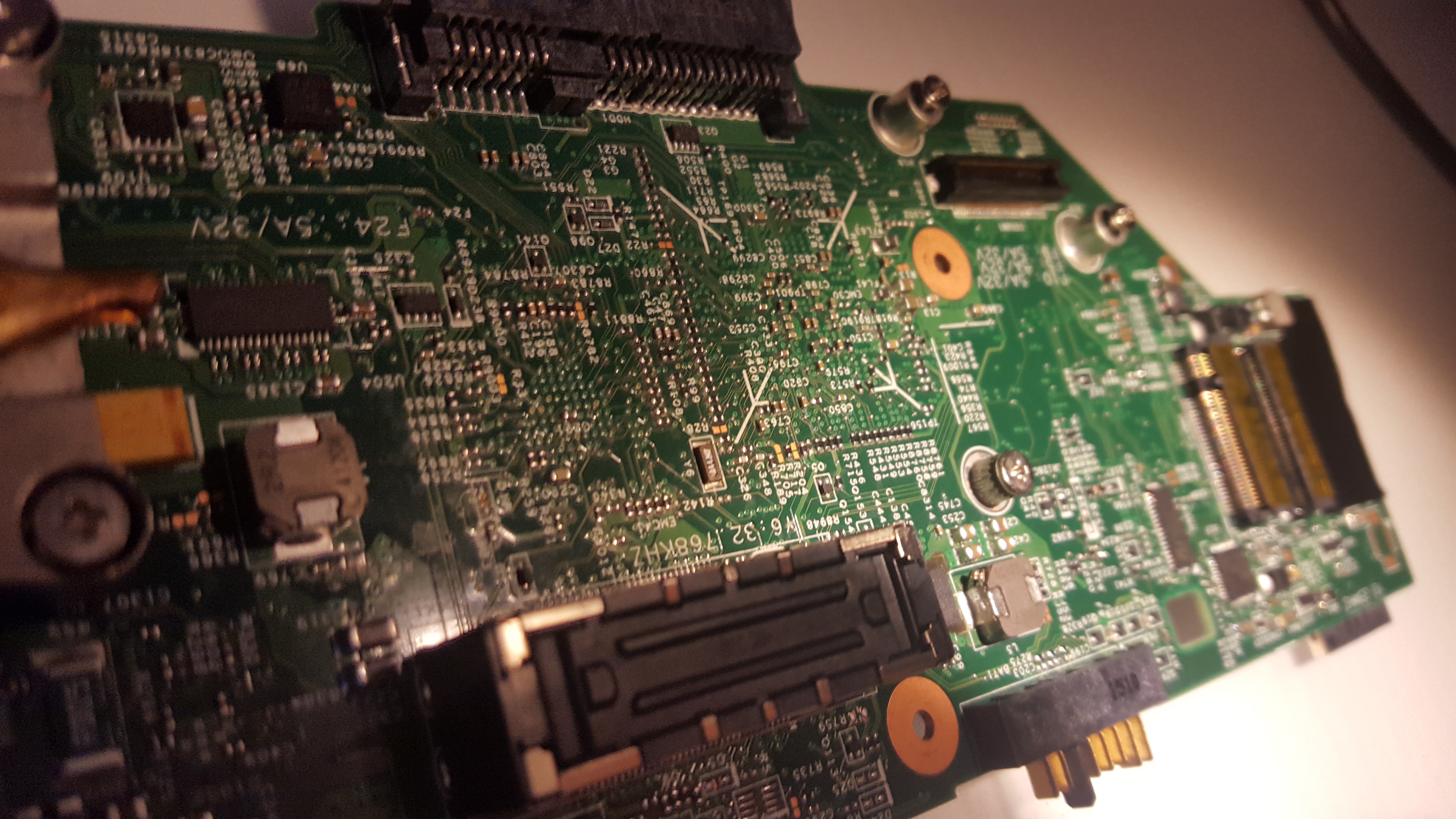

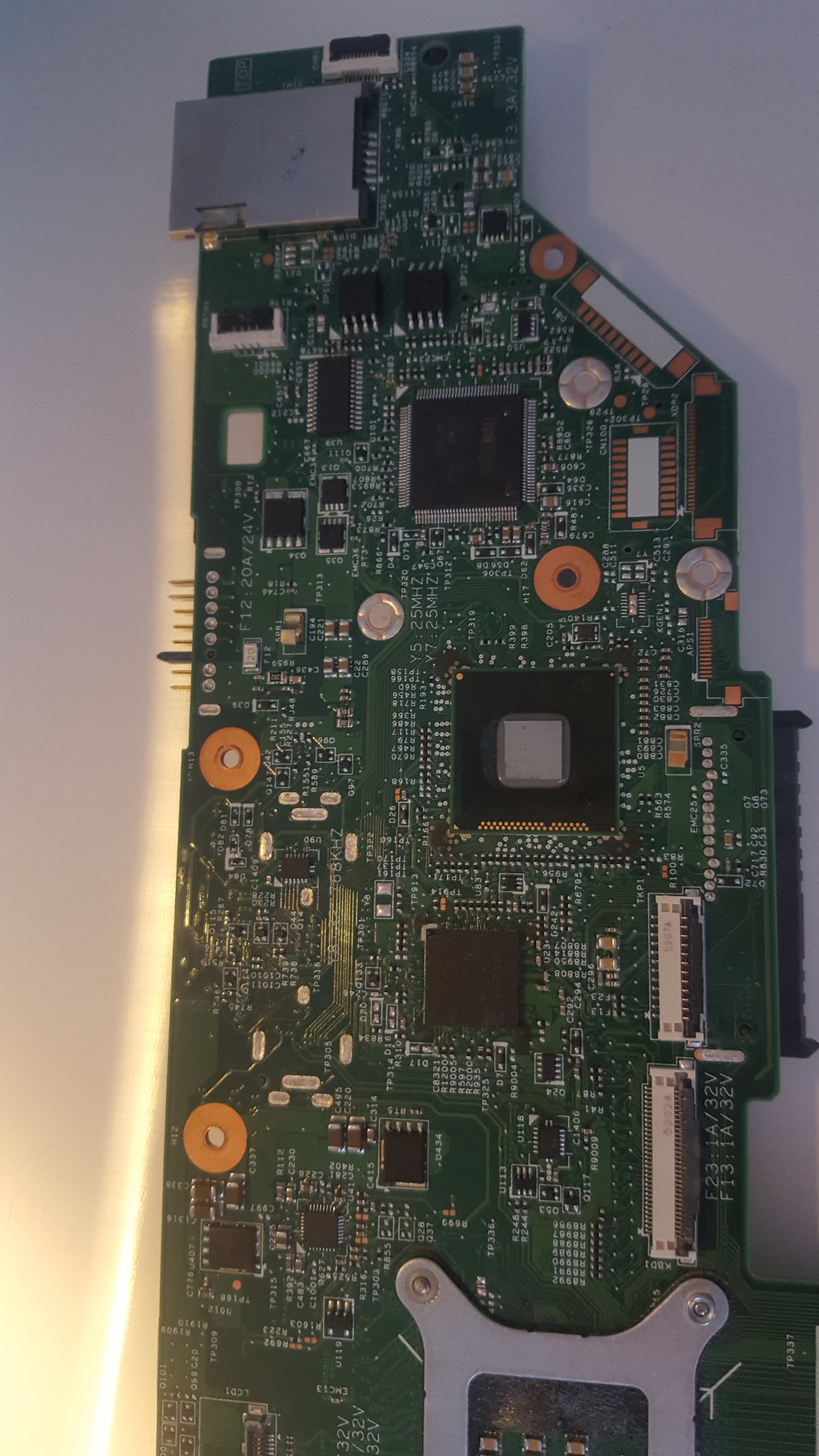

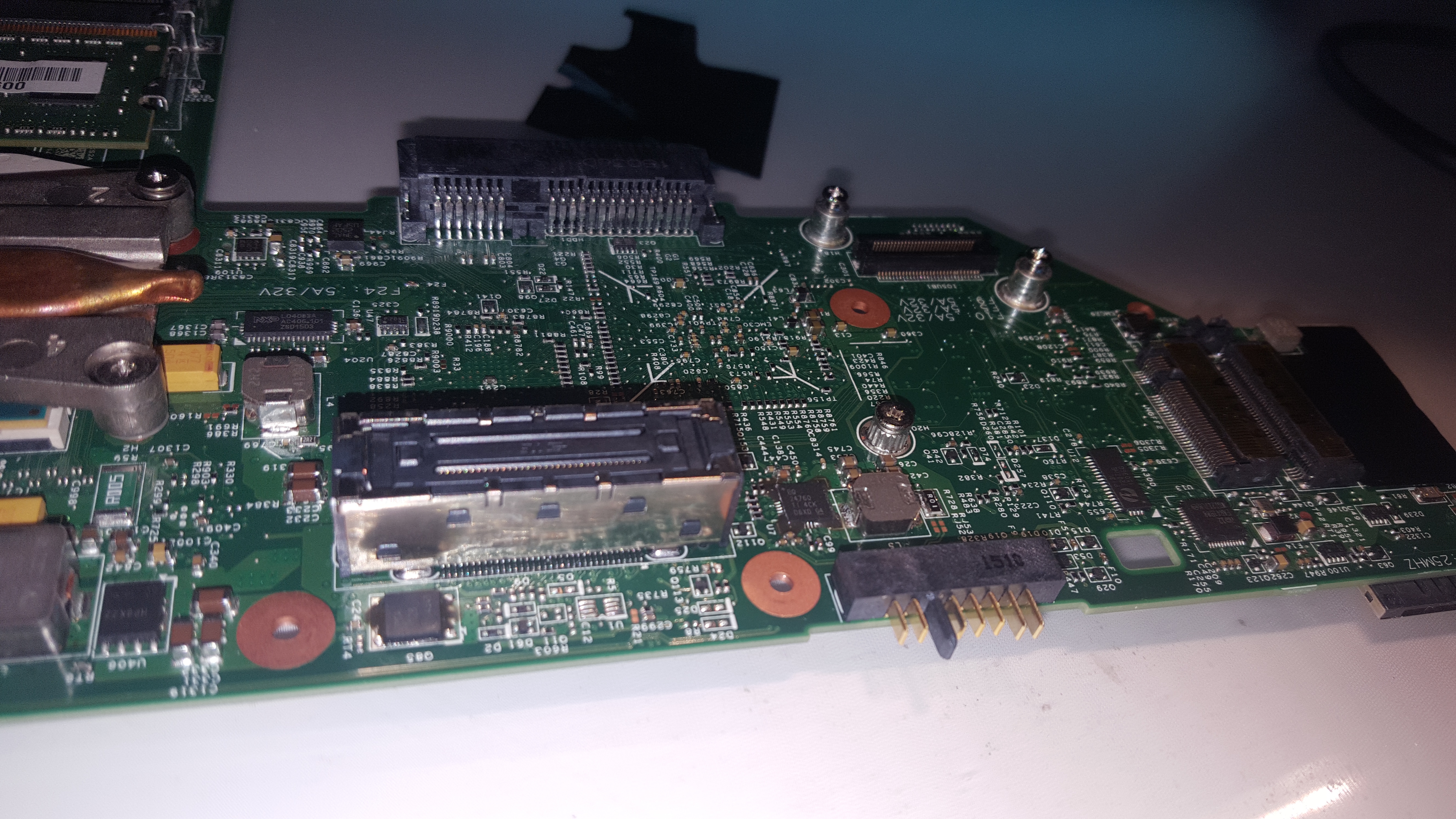

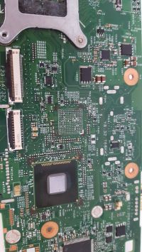

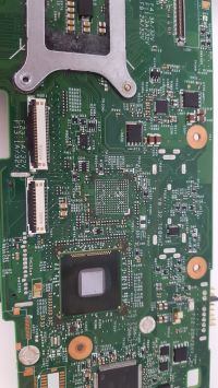

    Hello, I attach photos of the lenovo W541 board. Its designations are: lkm 1 ws mb 12291-2
    48.4l014.021. I was still looking for a list of keyboard pins or a keyboard connector, because I can also program the keyboard connector. Unfortunately, Lenovo Keyboard 04Y2485 KMBL-NOR also can not be found when it comes to spreading paths Seeking MEC1633L Pinout for Programming Lenovo W541: TDO, TDI, SCK, TMS, VCC, GND . Seeking MEC1633L Pinout for Programming Lenovo W541: TDO, TDI, SCK, TMS, VCC, GND Seeking MEC1633L Pinout for Programming Lenovo W541: TDO, TDI, SCK, TMS, VCC, GND Seeking MEC1633L Pinout for Programming Lenovo W541: TDO, TDI, SCK, TMS, VCC, GND Seeking MEC1633L Pinout for Programming Lenovo W541: TDO, TDI, SCK, TMS, VCC, GND Seeking MEC1633L Pinout for Programming Lenovo W541: TDO, TDI, SCK, TMS, VCC, GND Seeking MEC1633L Pinout for Programming Lenovo W541: TDO, TDI, SCK, TMS, VCC, GND Seeking MEC1633L Pinout for Programming Lenovo W541: TDO, TDI, SCK, TMS, VCC, GND Seeking MEC1633L Pinout for Programming Lenovo W541: TDO, TDI, SCK, TMS, VCC, GND Seeking MEC1633L Pinout for Programming Lenovo W541: TDO, TDI, SCK, TMS, VCC, GND

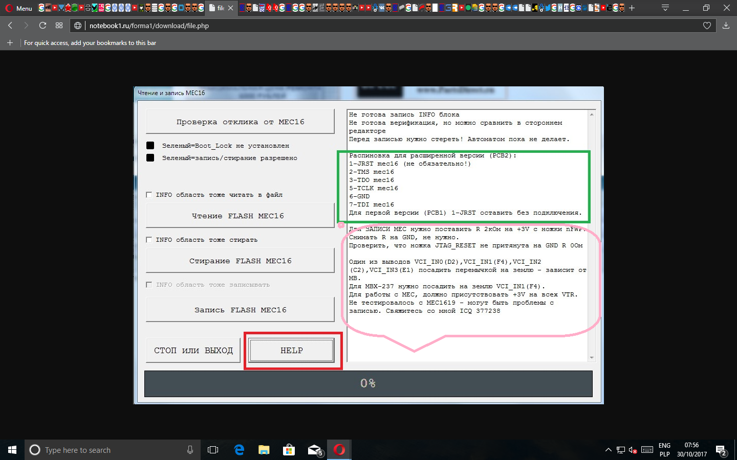

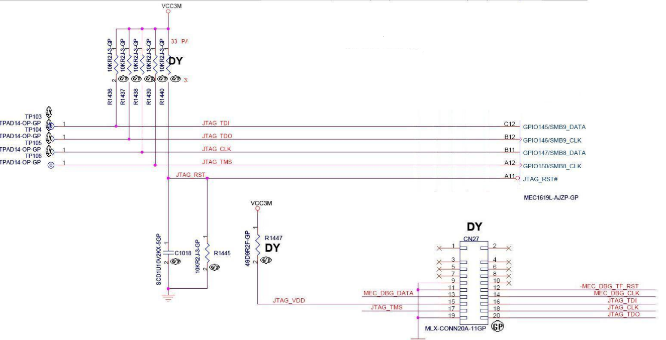

    On Sony notebooks with MEC1609 / 1619/1626 notebooks the case looks like this
    - see pin. F4 (# Boot_Mode)
    * sometimes when reading the MEC ID there is an option that stby (3.3 and 5V) are included earlier by the kbc and then "no cooperation with MEC" vs. the programmer will not be
    * (e.g. MBX-237, ../ or LGS-1 MB 48.4RQ21.011 platform with kbc MEC1619L)
    :!: A complex problem, it was once shown like this for MBX-237
    So described in the Russian computer forum
    :?: How is MEC1633L?

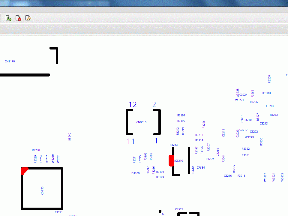

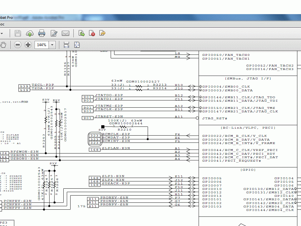

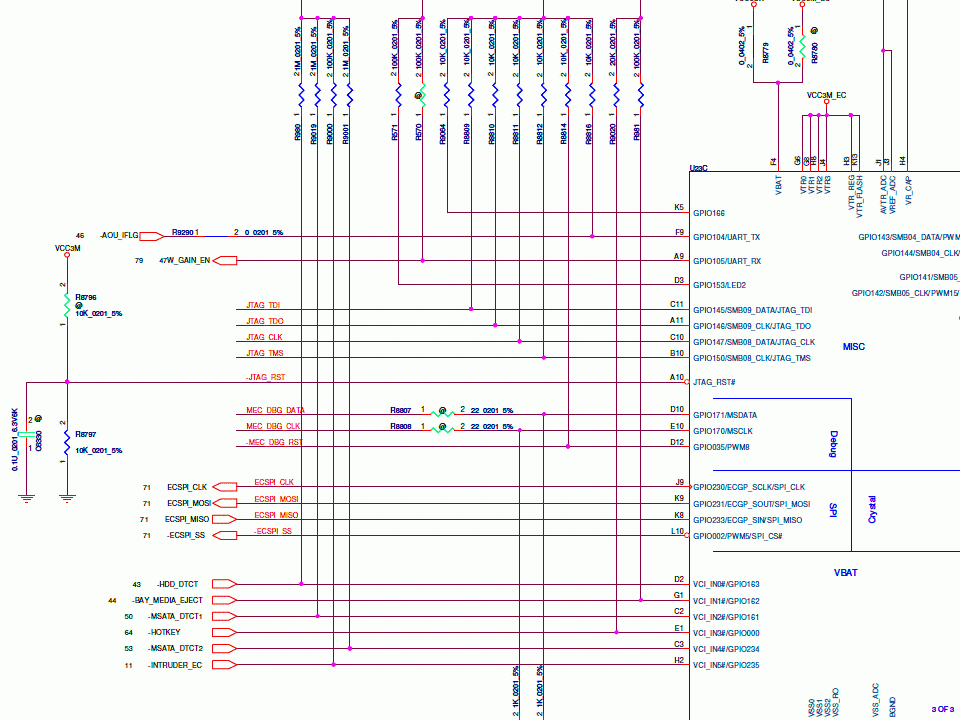

    You have treated the other side of the album with care. I'm most interested in the area where light reflects near the docking plate connector. There are 8 pads looking like I had in toshiba S11 (MEC1609). Similar was the case with MEC5055 in the subject
    https://www.elvikom.pl/dell-latitude-e6230-nie-laduje-nie-reaguje-na-power-t50663.html
    This is the case in S11 in the diagram.
    And that's how it is on boardview. 12 bare pads. Element CN9010 Seeking MEC1633L Pinout for Programming Lenovo W541: TDO, TDI, SCK, TMS, VCC, GND

    :idea: Give me a good photo. steering. MEC1633L.

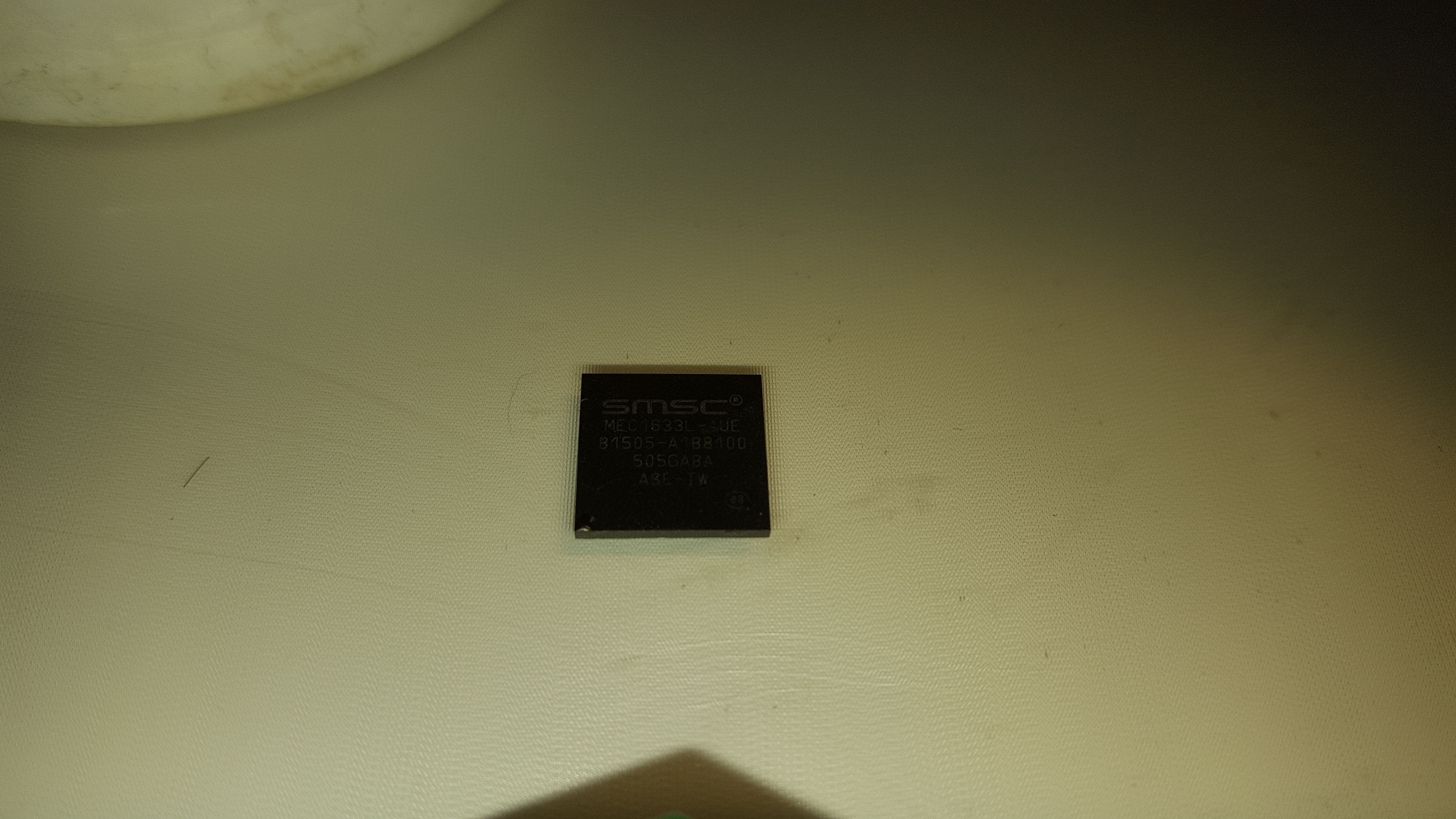

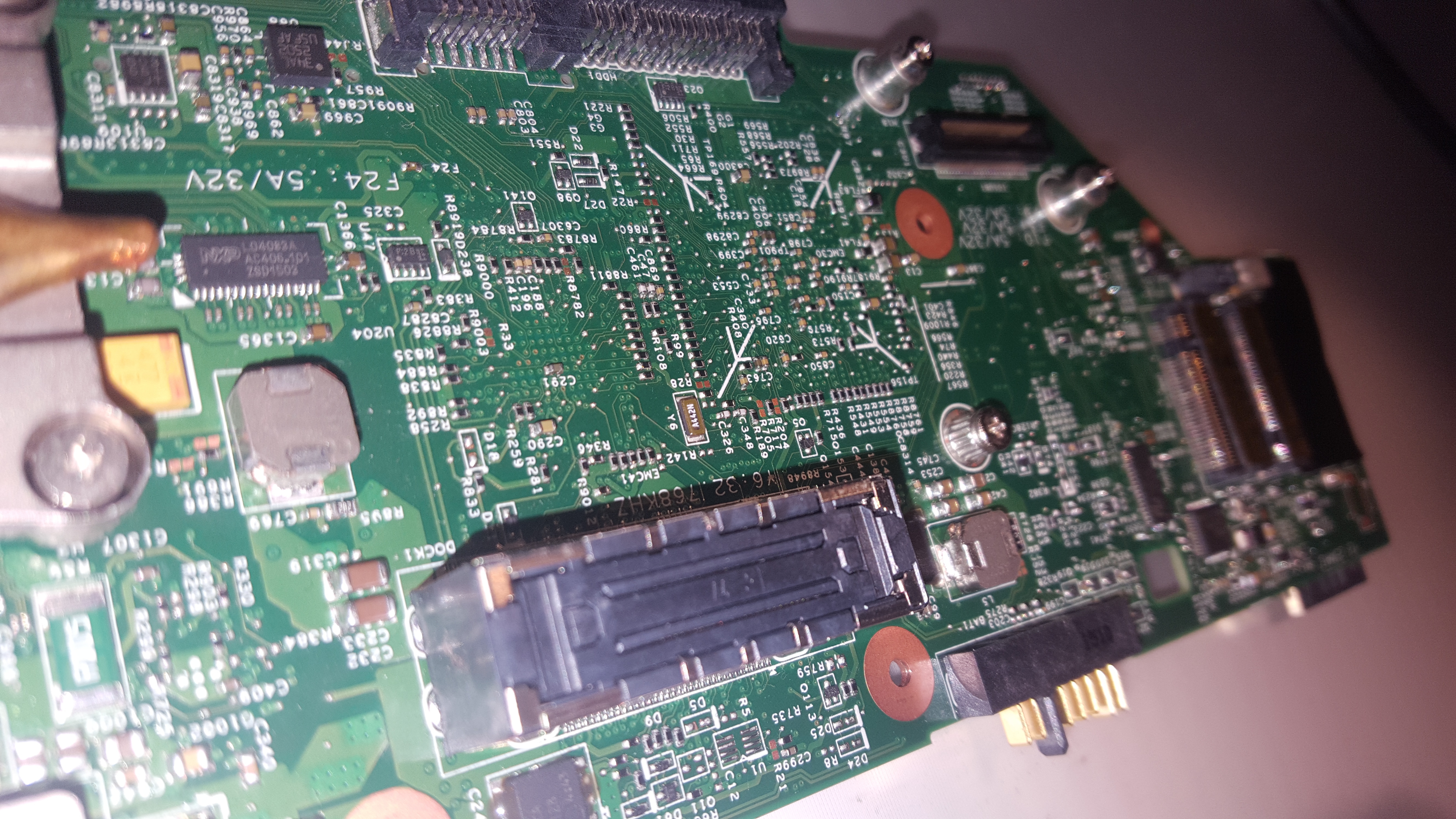

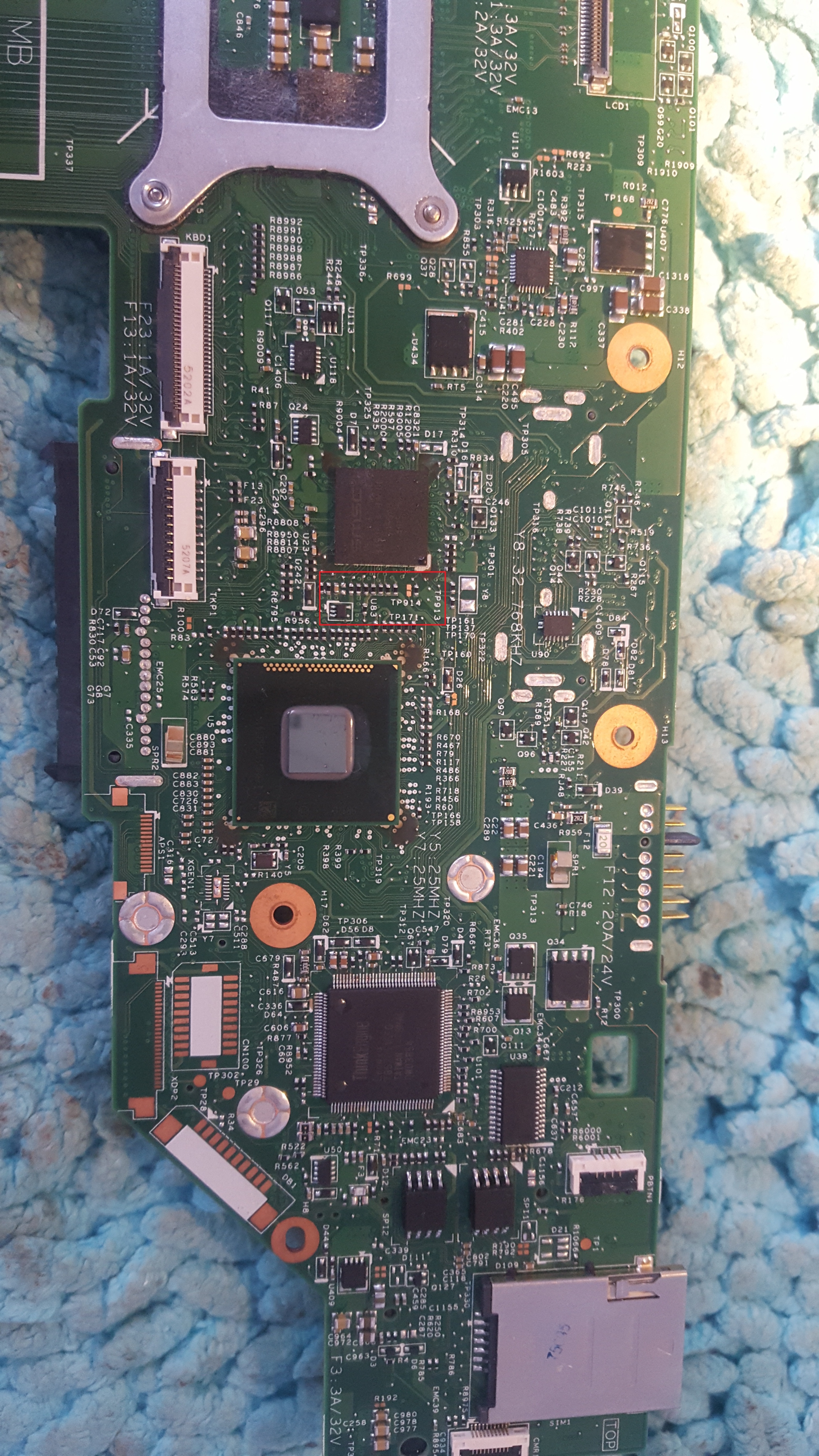

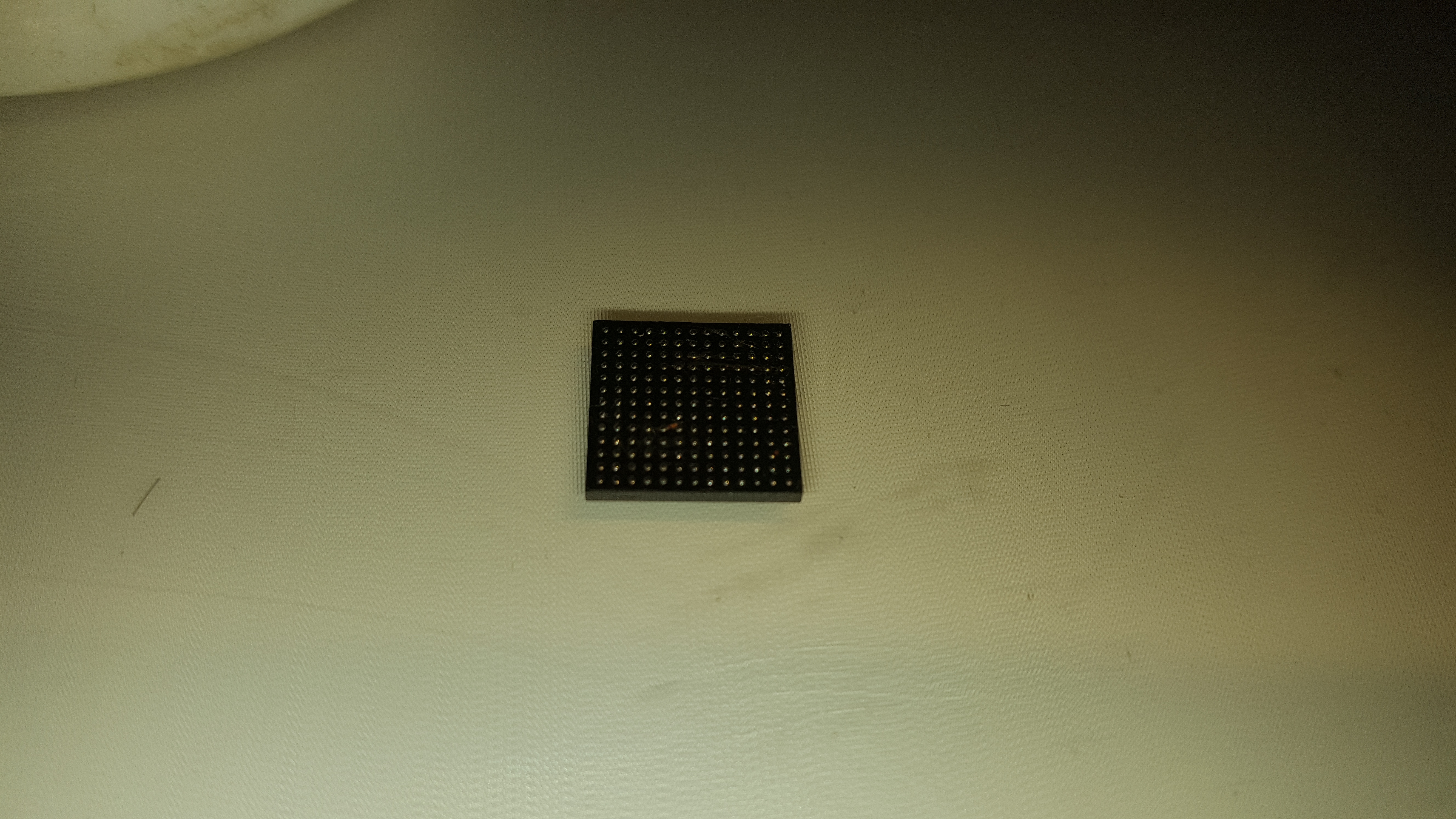

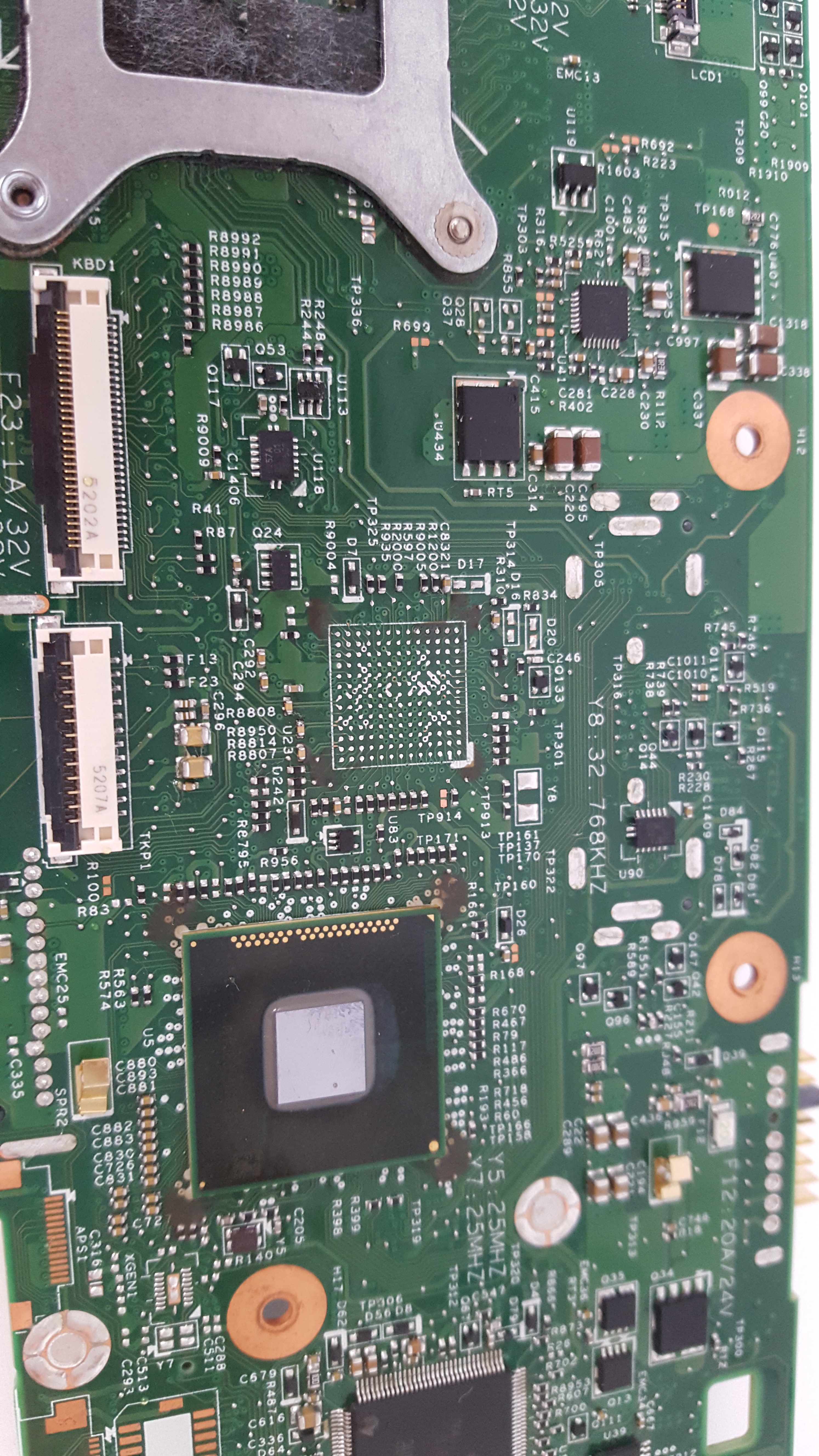

    These pads are for the U1 system. I attach photos of the MEC1633L - AUE system. Seeking MEC1633L Pinout for Programming Lenovo W541: TDO, TDI, SCK, TMS, VCC, GND Seeking MEC1633L Pinout for Programming Lenovo W541: TDO, TDI, SCK, TMS, VCC, GND
    I meant photo. on the plate / or about where this kbc is mounted (or is to be)

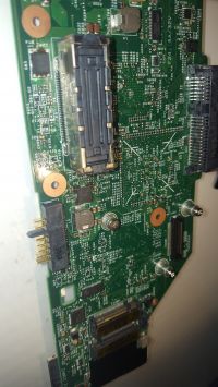

    If it is desoldered from your disc, it would be good to take a photo of the pads without the layout.
    After long and hard suffering:
  • #13 16790836
    lisek
    Service technician RTV
    Posts: 39995
    Help: 6352
    Rate: 6883
    Thanks col. It's from ....?
    :idea: I added points
  • #14 16790916
    Stani12
    Level 28  
    Posts: 1183
    Help: 134
    Rate: 107

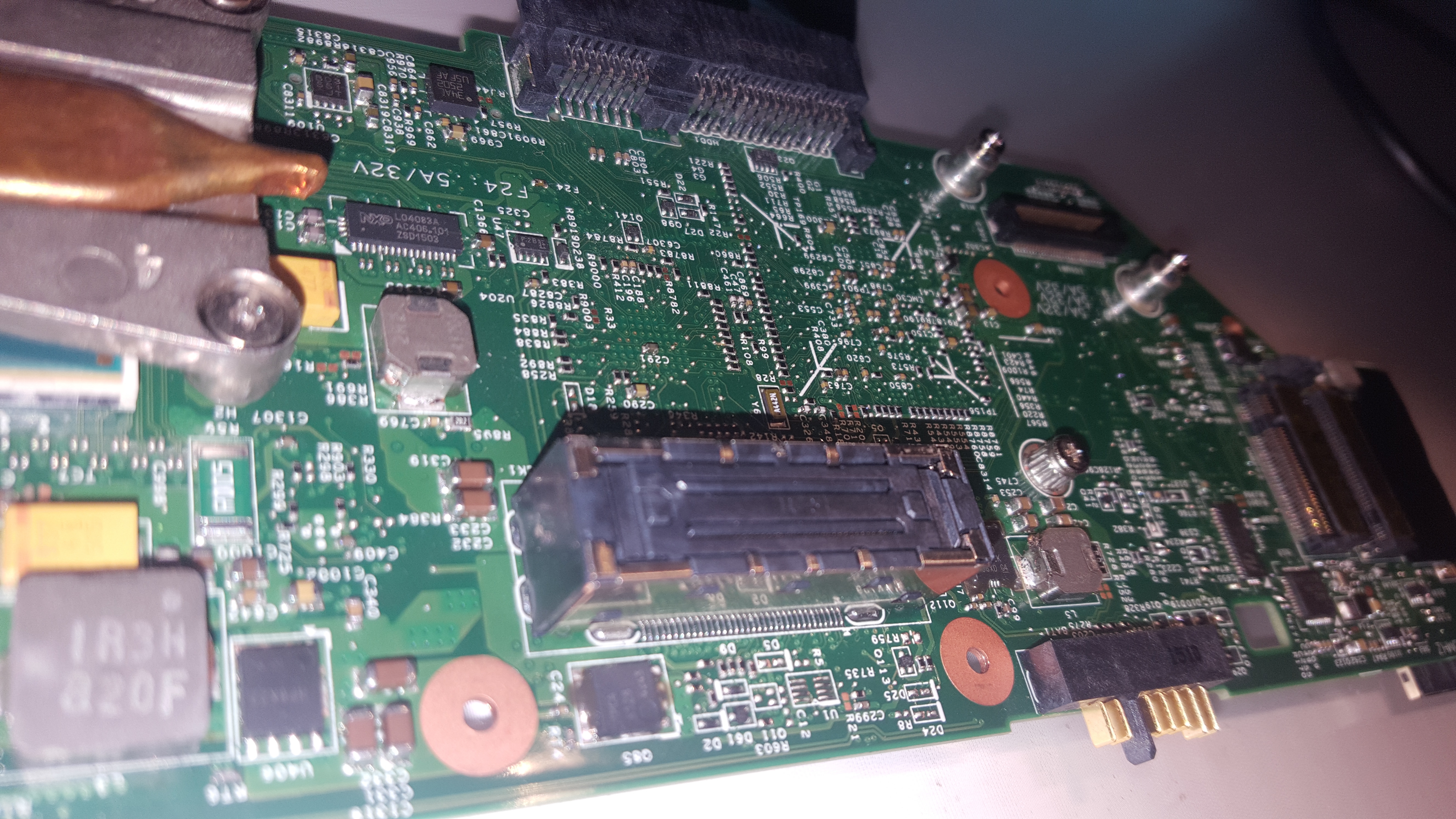

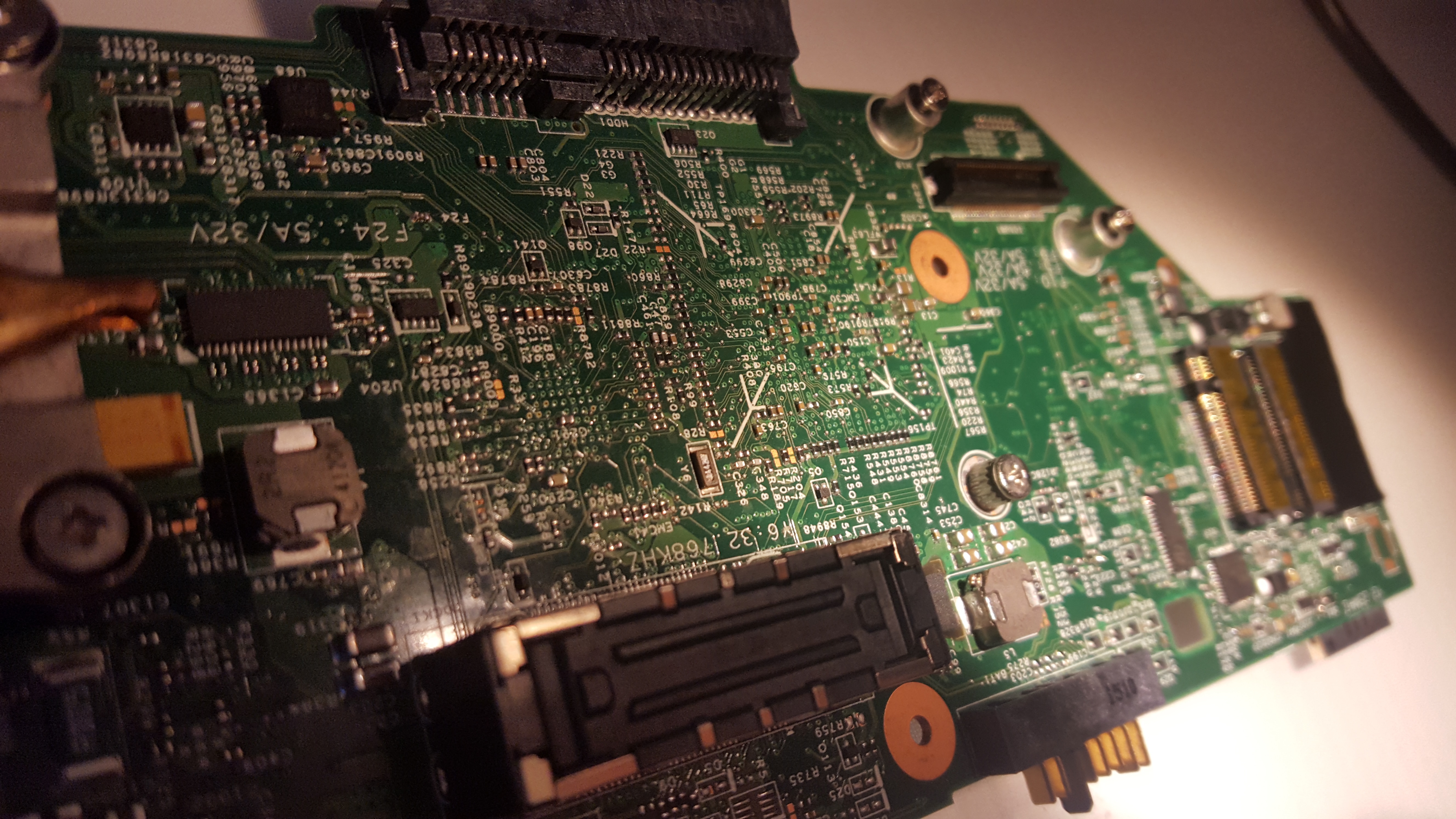

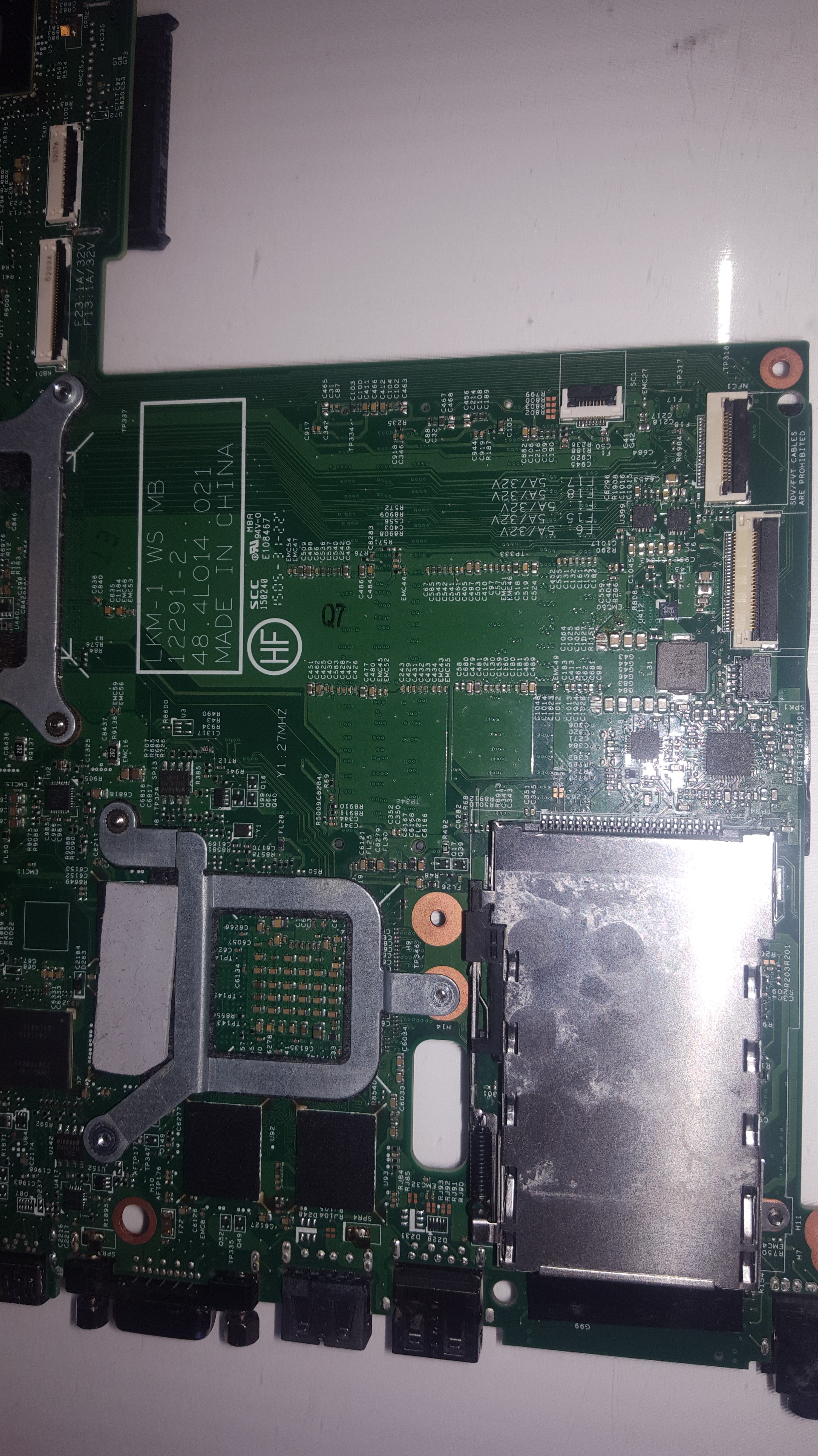

    I bet on the marked area (resistors and TP914):
  • #15 16790944
    danao
    Posts: 949
    Help: 26
    Rate: 19
    Respect. Thank you. I still paste the pads after removing MEC1633L. Seeking MEC1633L Pinout for Programming Lenovo W541: TDO, TDI, SCK, TMS, VCC, GND Seeking MEC1633L Pinout for Programming Lenovo W541: TDO, TDI, SCK, TMS, VCC, GND Seeking MEC1633L Pinout for Programming Lenovo W541: TDO, TDI, SCK, TMS, VCC, GND Seeking MEC1633L Pinout for Programming Lenovo W541: TDO, TDI, SCK, TMS, VCC, GND

  1. Remove main battery and AC.
  2. Short ball F4 (or its test pad) to ground.
  3. Apply 3.3 V and reset; the chip now accepts JTAG commands [Elektroda, lisek, post #16788819]

Can I use the keyboard connector instead of the tiny test pads?
Yes. Lenovo routes the same JTAG lines to the 8-pin block inside the 30-pin keyboard FPC; tracing confirms continuity on W541 [Elektroda, danao, post #16788809]

3-step how-to: re-flash MEC1633L with Vertyanov JIG
  1. Solder JIG to TP914 pads, tie F4 to GND.
  2. Load EC.bin and bootloader merge, select MEC1633L in software.
  3. Click Erase->Write->Verify; look for stable 0x200024B1 ID [Elektroda, danao, post #16801453]
