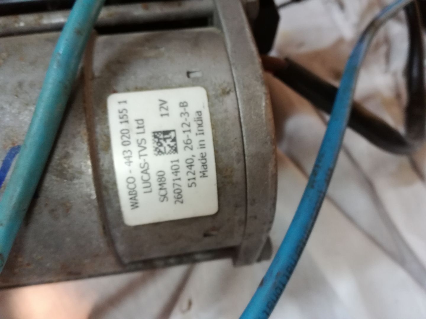

    I have a question
    I have a suspension compressor from Mercedes w211. Wabco compressor model 443 020 155 1
    And what pressure should such a compressor build up ?? I get only 3.5 bar and that's it, and I think it should be more.
    How much does such a car compressor for suspension shoot, if it is broken then what is the reason ??

    Hello. The compressor should be at least 10 bar and the suspension at least 7 bar. On the Mercedes W211.

    In the leak test in W211 it reaches 14 bar.

    The original chamber from MB 211 fills 18 bar.
