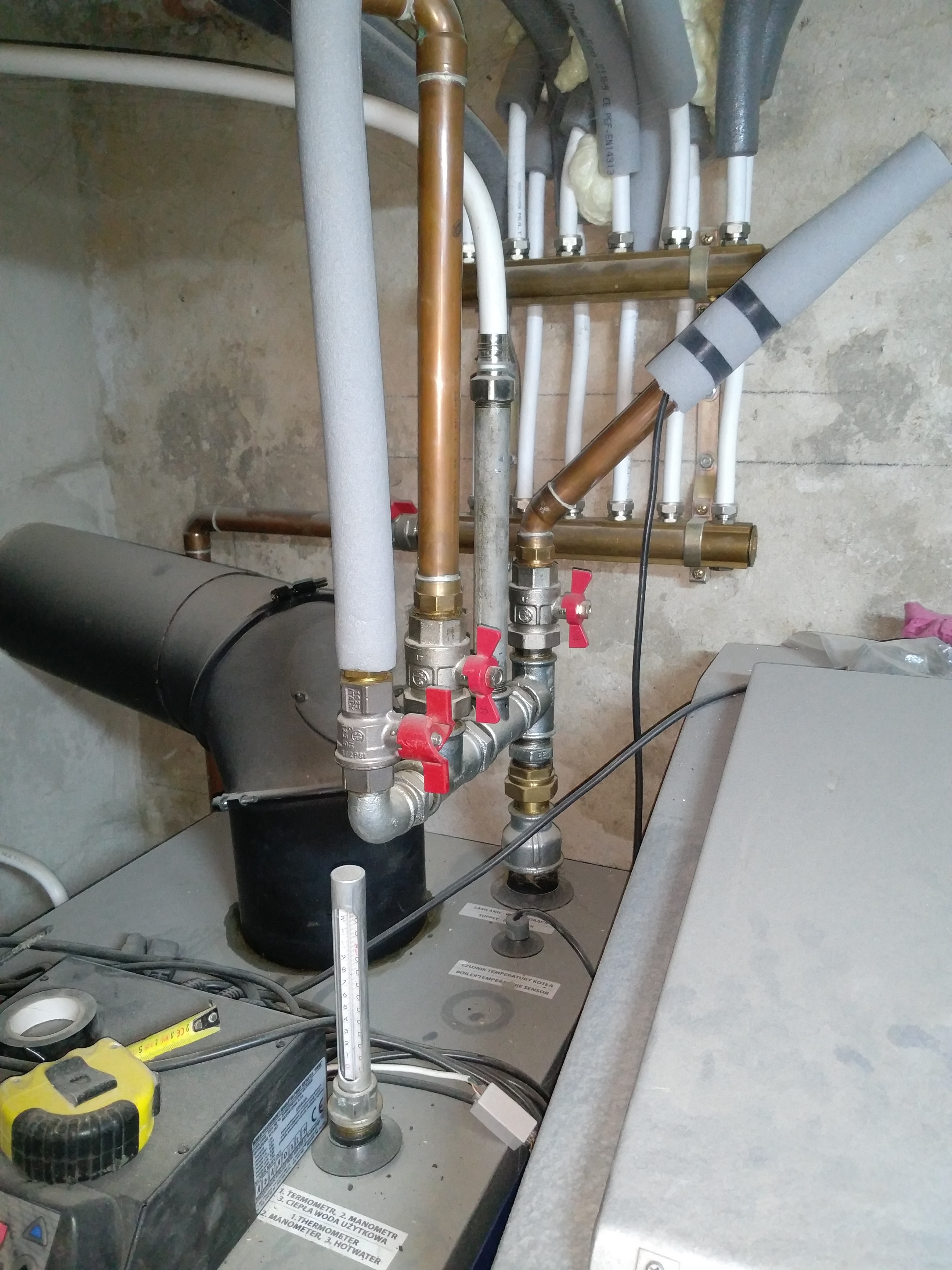

    Hello forum members, I have a 12kw stove as above in a small 70m2 house, I had a new central heating installation with a new stove
    A question for you what can be done in the installation
    And for help in adjusting the controller, the stove is currently operating on the settings
    Which I will present below
    Preset temperature 55 °
    Pump activation temperature every 56 °
    Blower speed 35%
    Blower speed in supervision 35%
    Time between blows 1 min
    Purge time 190
    Multiplicity of administration 2
    Time between feeding 2 min
    Feeding time 10s

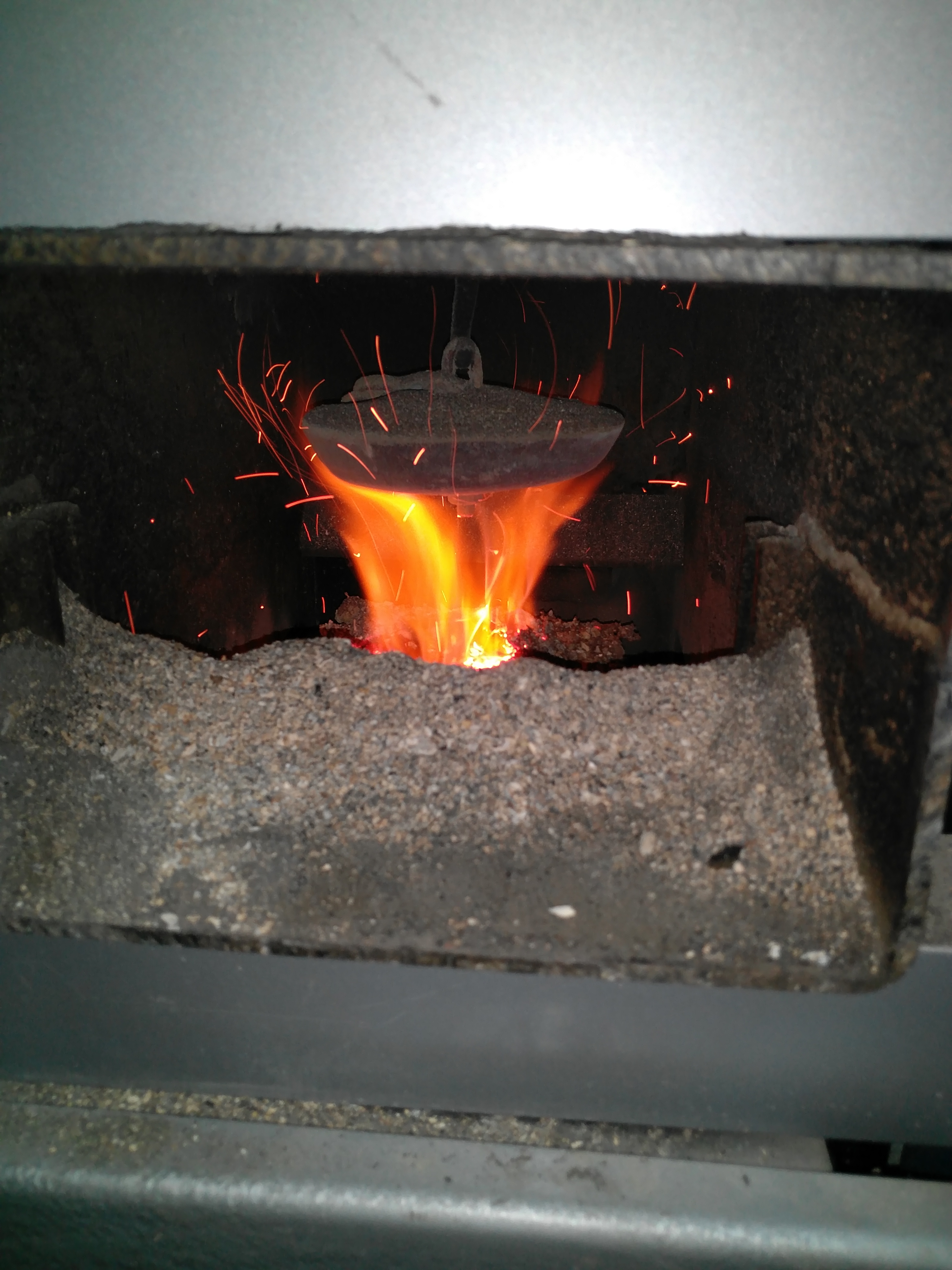

    From what I observed, the stove consumes about 35 kg of eco peas per 24h outside temperature 8 degrees Celsius the flame seems ok but after reaching the set temperature it goes into supervision mode after switching on the pump which the temperature drops very quickly I will add that I tried to set the pump temperature to 50 ° however It did not change anything, please give me all opinions and possible modifications to the installation and controller settings, of course, the boiler room will be tidied up over time :) Thank you in advance for any answers and help with the solution

    Hello. The man from the service, stalkot, was very helpful when adjusting the settings with which the stove works efficiently and relatively economically, it may be useful to someone
    Pump activation temperature every 35 °
    Blower speed 35%
    Blower speed in supervision 50%
    Purge time 5
    Multiplicity of administration 1
    Feeding time 10s
    Gentlemen, I am thinking about installing the 4d valve, some opinions, insights and where to mount for any advice, thank you very much
