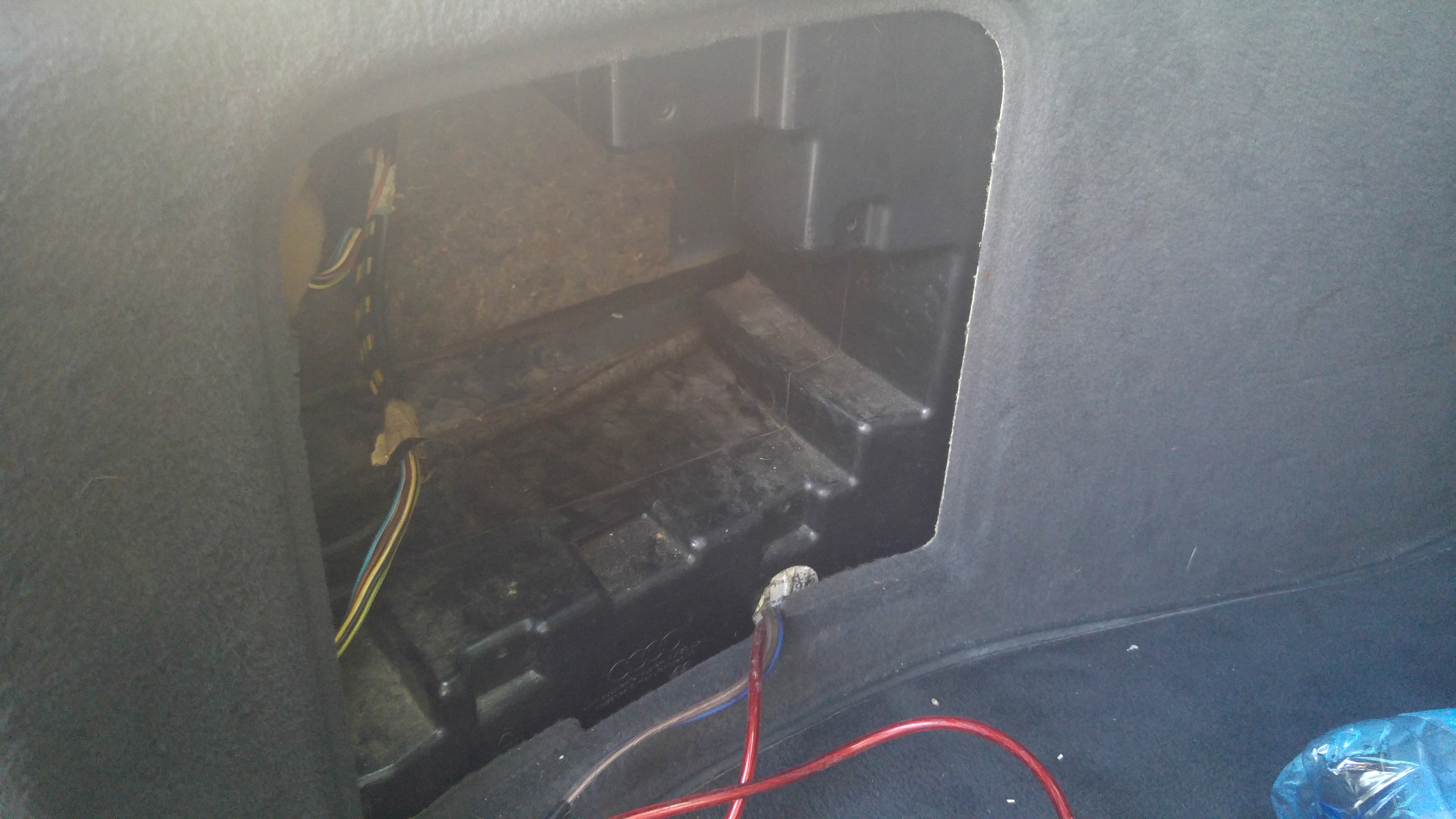

    This is about the cables on the radio, now the subwoofer and here is my next question.

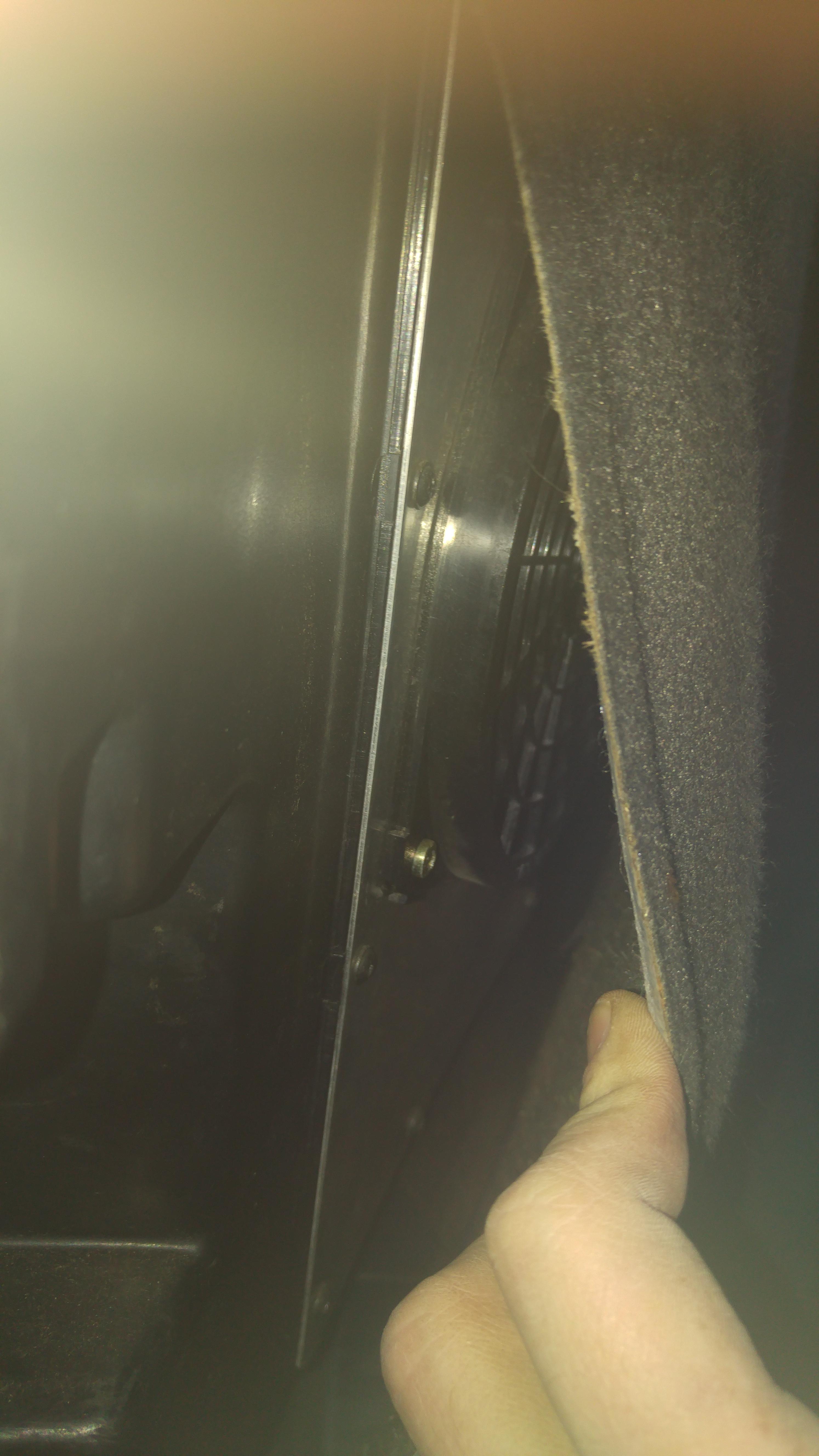

    Is he here at all? According to the pictures on google, it should look like this
    this niche bothers me. I will add that there is a loudspeaker somewhere behind the casing so it may be true (I attach photos:
    Audi A4 B5 Rear Speakers and Subwoofer Connection Guide with Dibeisi DBS006
    And cables next to the subku:
    One I found loose, here he:
    I think I could see all the cables, it's clear that a couple from the subwoofer are led forward to the radio. No. 2 is an antenna, I think, and I do not know the rest. I am asking for help and thank you in advance.

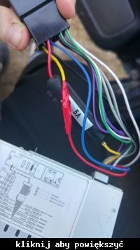

    In my opinion, there was another amplifier connected in this car than the original one because many of these cables are made up. So if there is a sub, rather you have to buy an external amplifier. I will write the ones I am sure:
    2. FM antenna
    3/4 - 7/8 - these are RCA cables for connecting an external amplifier. Black is the left channel, red is right. You connect the radio with the amplifier
    3.5 / 9 - this is a remote cable. You connect the radio with the amplifier so that the latter will start and go out together with the radio (there must be a second end in the trunk)
    5. I think it is not needed, probably some remnants of the original radio
    The brown and black cubes are power supply and loudspeaker outputs. It seems to me that black is exactly power but I'm not sure. You connect these cubes to this jack on the radio, which is on the cable. You can not mistake these cubes. They have a different shape and you can not put the loudspeaker under the power supply and vice versa.

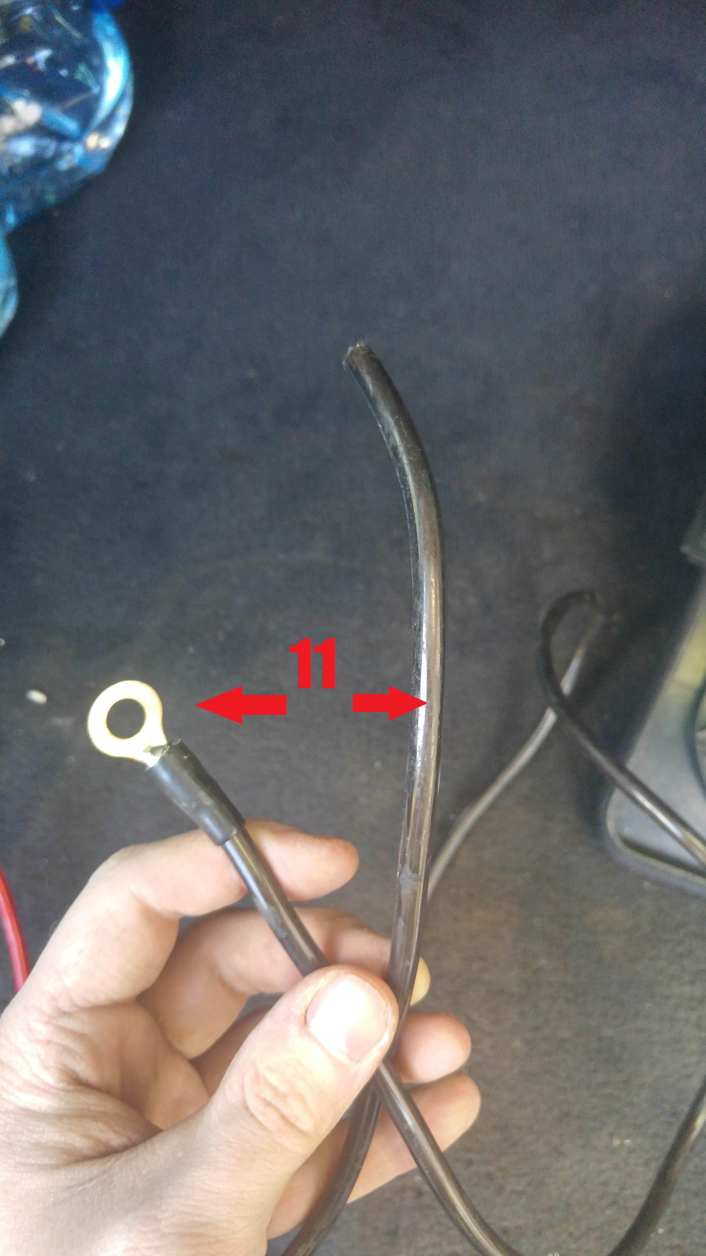

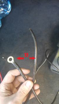

    10. Power cable for the amplifier. It should go from the battery and a fuse close to it
    11. Amplifier mass cable. Connect one end to the amplifier and the other end to a mass point. For example, under a screw

    So this bay near the subwoofer is the remnant of the amplifier like this? The next purchase is waiting for me ...
    Will it match any I find on the A4 B5 allegro? Do I have to look specifically for my radio or something else?

    I and II, I connect my ankle black and brown and radio, but I do not know what about III (red)
    I will add that I noticed the replacement of the yellow and red cables:
    Does it change anything? I heard that it could be from the power supply. In the end, I would now ask for a precise description of how to connect everything (as I mentioned, I am a layman). I talked to a friend, it's probably that the subwoofer can work without an amplifier but it is not fully powerful and there is a risk of burning the radio. I do care, however, to check if it will work at all, if I manage to do it, I will double up and make it sound as it should.
