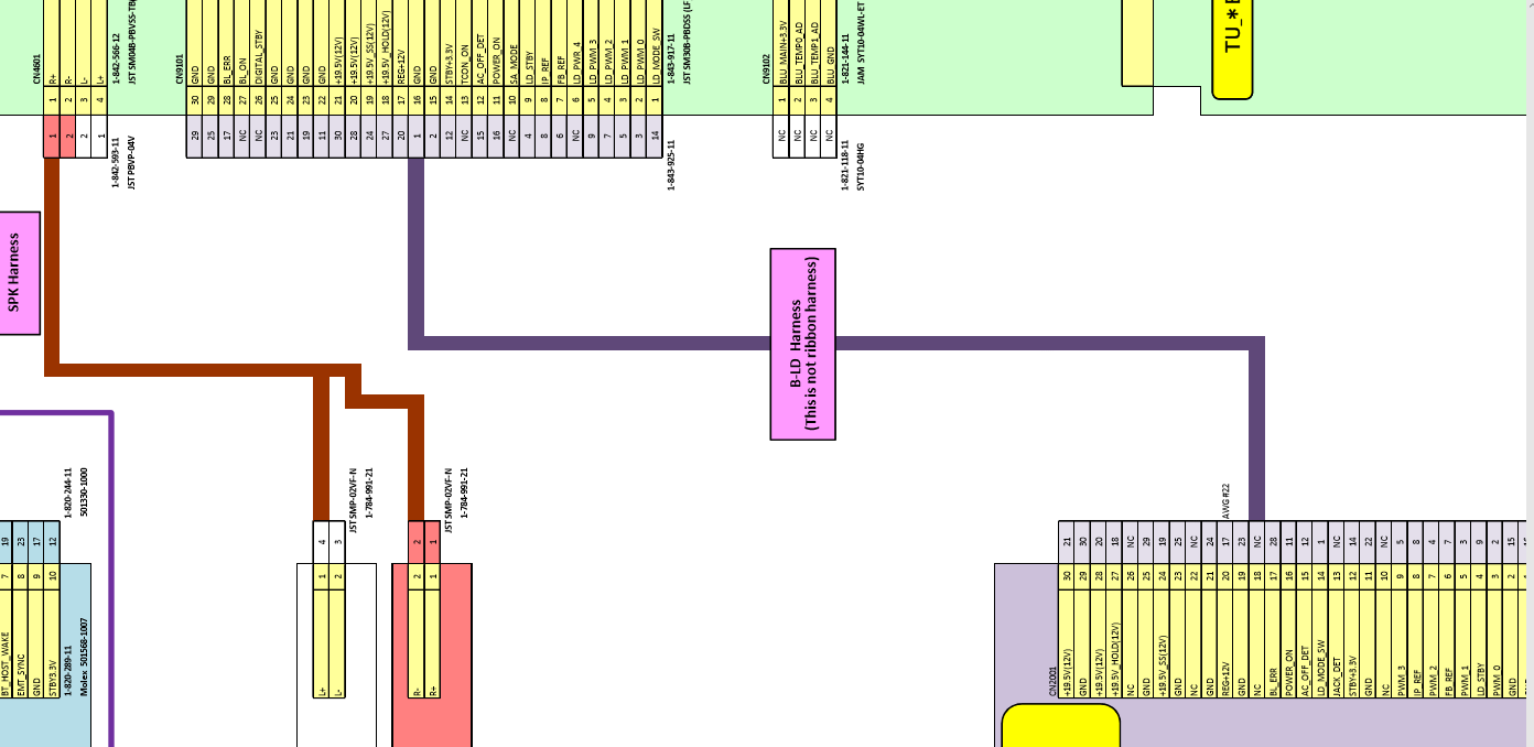

What voltage should be applied to the LED driver power connector on a Sony KDL-42W706B?
The LED backlight needs at least 144 V at the connector, because the strip has 40 LEDs and each LED is about 3.0–3.6 V [#16797053] This board is for the KDL-42W706B / KDL-42W705B family with LED driver 14STM4250AD-6S01, and the backlight strips are T42-40-R / T42-40-L [#16792817][#16797053] It is not meant to be run properly “on the table” without the required control signals from the main board/inverter section [#16796918]

    Someone tell me how much should be the voltage at the power connector. Сan't understand how much he needs to give power.
    • 14STM4250AD-6S01.jpg (2.22 MB) You must be logged in to download this attachment.

    Yes, I do not need a purchase and find out what voltage is on the connector circled in red. And you bought me where to buy immediately. It is better to write where and how many volts on what legs or pentacles that's what I need

    The fact that the picture power should the driver issue without lane or mainom? The driver is tested individually without lane or run on the table?
    and there is no one to answer the question of how to make a stop with the lanes or without it ???? and you can run it without a TV

    :cry: It's impossible, let's see, after the signals necessary for proper operation of pcb inv.

    Yes, here I am restoring bp after a short circuit and I wanted to know how much voltage should be. Only it is unclear from the mine to measure or without it?

    Because eq. KDL-42W650A have LED strip T42-40-L (left) / and T42-40-R (right)
    All strip have 40-Led"s , each LED Uf=3-3.6V
    ... that is, the voltage must be at least 144V
