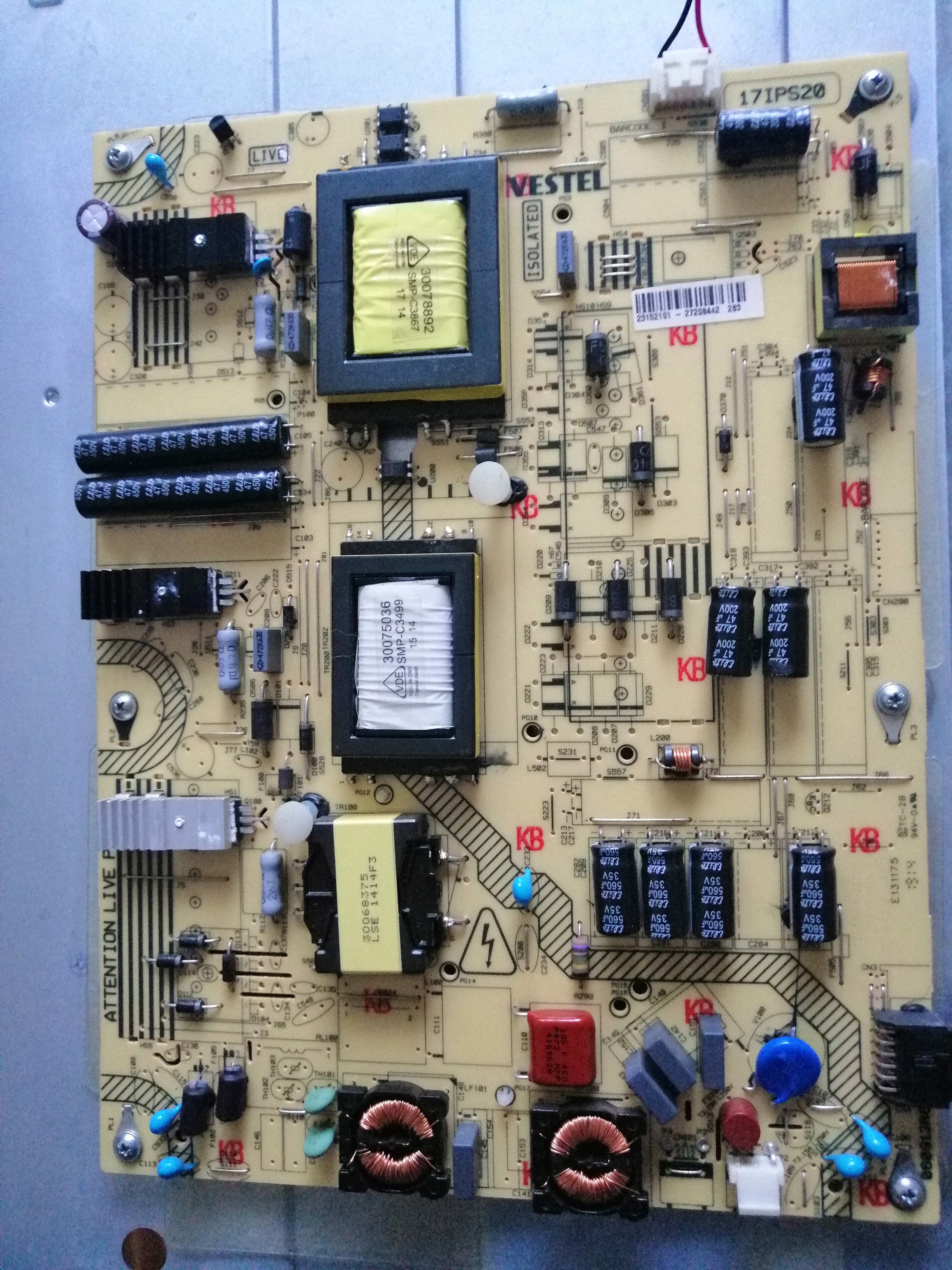

Is 99 V on the LED power supply of a Funai 40FDB7514/10 with a 17IPS20 board normal, or is it too low?
99 V is too low; on this 17IPS20/40" setup the VLED+ line should briefly rise to about 160 V at startup, and a steady ~100 V suggests a fault rather than normal operation [#16487272][#16490126] Mirex noted that such a low reading may mean BL_ON is missing, so the backlight driver is not being enabled [#16487272] He also advised checking the T-CON supply voltage as part of the diagnosis [#16487272]

    Hello, as in the subject I have only a small question, is the LED 99 V power supply correct or not too low? 17IPS20 power supply.
    Please help.

    mirex
    Posts: 21794
    Help: 1950
    Rate: 1990
    Foretell?
    And what matrix? And which version of the power supply with a characteristic number?
    And this is the maximum voltage appearing, measured after blocking? ;)

    Sorry, I give matrixes-VES400UNDS-03 regarding the power supply, I have 060913R3-E131175 voltage after disconnecting the plug from the panel I have 108 V as I have a multimeter plugged in including the TV, I have only a jumping 5-8V but when I highlight the matrix with a flashlight, I don't see any image - empty and dark matrix.
  • #6 16487272
    mirex
    Posts: 21794
    Help: 1950
    Rate: 1990
    AWJR1951 wrote:
    voltage after removing the plug from the panel I have 108 V
    I understand that measured between mass and D501-503, marked as V_LED +.
    Little. There is probably no BL_ON. ;) And by the way of the T-CON supply voltage. ;)

    Hello, I connected the multimeter between the A-Mass point and the B-point when it comes to LED voltage regarding T-con, the voltage measured on the fuse relative to the total mass on both sides of the fuse, I have 11.5 V.

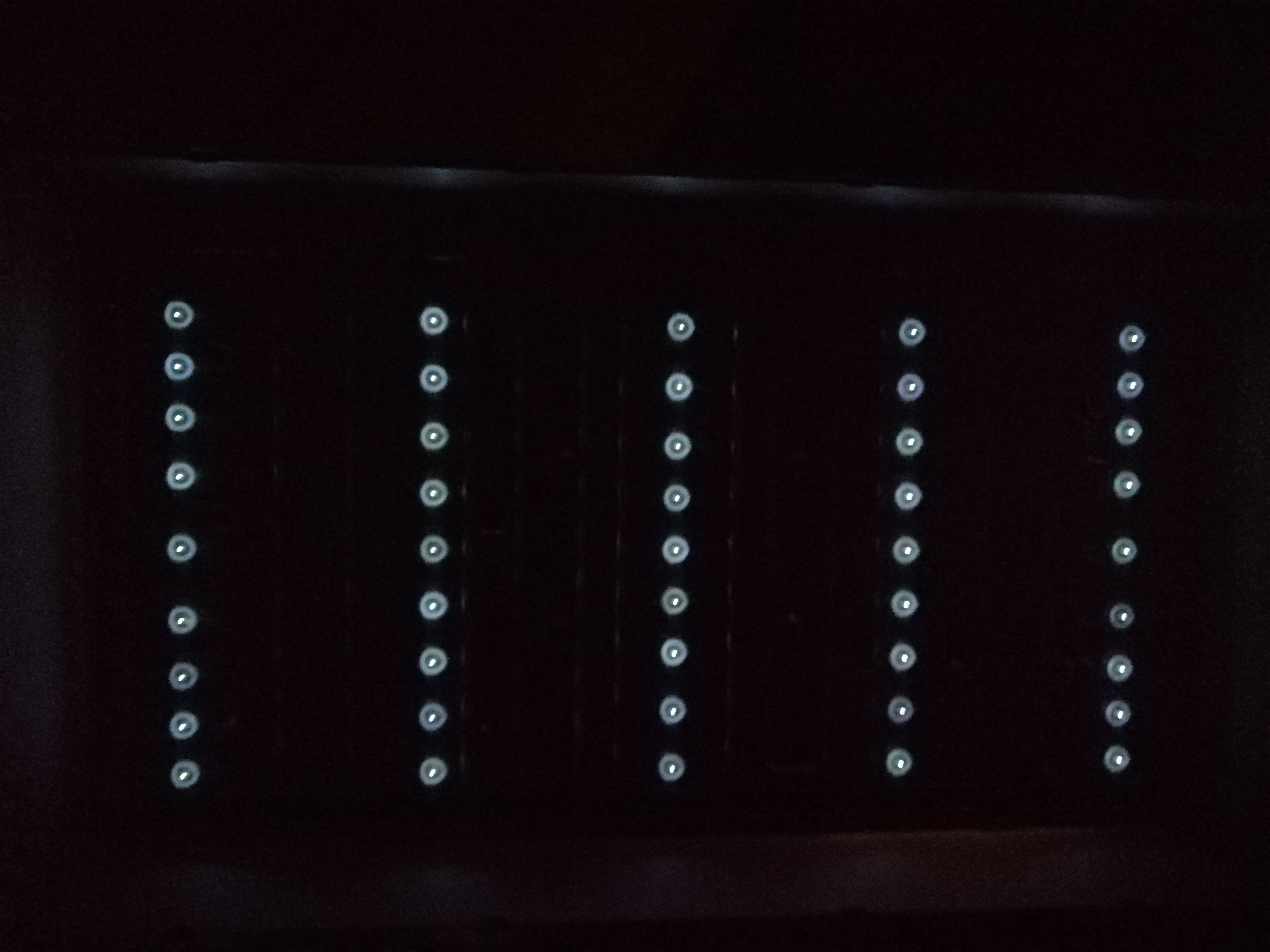

    Hello everyone, it seems that I am patient for so many years. Going back to the topic I bought a backlight set in China I pasted the strips and the TV turns on only the LEDs are barely lit I will add that the voltage on the LED power supply is 116V LEDs are connected in series symbol on the strips is 40 NDV REV1. 0 strips that I peeled off are VES400 UNDS 02 strip with XY284 GHB tester so new and old strips indicate 25V power supply. If you can ask what else, you can check if these straps are appropriate.
    Thank you in advance.

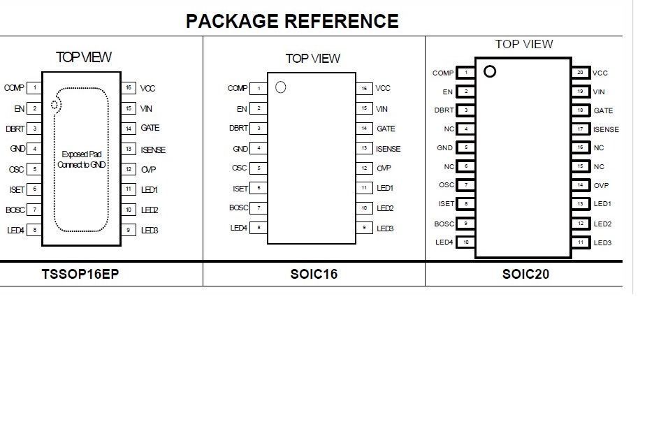

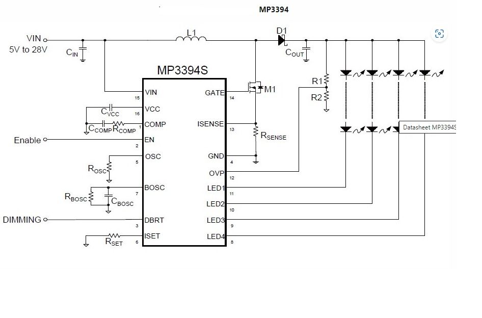

    17IPS20P uses MP3394S 4-string 200 mA driver

    * matryca 40" VES400UNDS-01 , VES400UNDS-02 , VES400UNDS-03 or VES390UNDC-01 > TV 40PFL3008H/12, 40PFL3008K/12, 40PFL3018K/12 ,LT-40TW51
    * 5 pasków po 9xLed (3V)
    Skoro zasilacz
    17IPS20P
    PWM Power: FAN7529 (PFC), SG6742HR
    LED driver: MP3394S
    * :!: 4-String, Max 200mA/String WLED Driver
    Funai 40FDB7514/10 TV: LED 99V Power Supply, 17IPS20 - Correct Voltage or Too Low? Funai 40FDB7514/10 TV: LED 99V Power Supply, 17IPS20 - Correct Voltage or Too Low?
  • Controller replacement gave no LED response

    Hello, thanks to everyone, especially to the fox who led me to the fault, the led strips that I mentioned are ok, I will add that the TV earlier after switching on the power supply without the motherboard, the LEDs only turned on 5 percent as I wrote and at the moment, after replacing the controller, no reaction, if I put out the motherboard after fastening the tv disc, maybe I haven't discovered America or maybe it will give someone something to think about.
    Regards.
