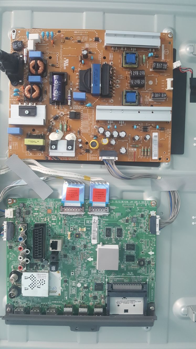

    In the TV set, the matrix backlight turns on and off periodically every 1s, and at the same time the sound is correct and the picture is also correct.
    The voltage of 3.5V, 12V and 24V on the EAX65423801 (2.0) rev.1.0 module is completely correct, the power supply voltage for the LEDs is about 140V (it floats between 135 and 142).
    My question is whether this is due to the unstable operation of the power system or damage to the LEDs in the backlight. This knowledge is so important that it can save me from disassembling the matrix.
    Maybe someone has a diagram of the power supply board?

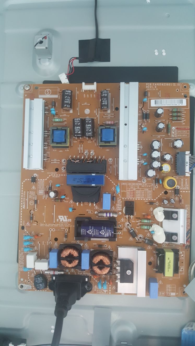

    #3 16669486
    marian 1
    Level 19  
    Posts: 581
    Rate: 46
    Matrix T500HVJ03.0, LED driver on BL0202B board. The voltage at the outputs of the leds are 135-142 when connected, while when the leds are disconnected, the first output is 162-172 and the second is 135-142; measurements relative to common mass.
    I do not know anymore whether to disassemble the matrix and make sure that any of the diodes is shorted and therefore protect turns on, or to look for BL0202B.
    • Unstable Power System or Damaged LEDs? LG 50LB650V TV Backlight Issue and EAX65423801 (2.0) Module 2.jpeg (126.07 KB) You must be logged in to download this attachment.
    • Unstable Power System or Damaged LEDs? LG 50LB650V TV Backlight Issue and EAX65423801 (2.0) Module 1.jpeg (176.22 KB) You must be logged in to download this attachment.

  • #5 16670639
    marian 1
    Level 19  
    Posts: 581
    Rate: 46
    This driver is slightly warm, but it is probably caused by normal operation, the warmth is only slightly perceptible. However, I will probably have to disassemble the matrix.

    Disassemble the matrix and see if all the LEDs are on
    - of course with the difference in lighting, because the voltage is "unstable)
    If so (they are all lit), change the layout!
    The VCC supply voltage of the BL0202B chip, stable (not pusing)?
    Read the datasheet and the role of the pins responsible for OVP, pin 13/17 and the start operation
    Link_ by Sanken

  • #8 16713182
    marian 1
    Level 19  
    Posts: 581
    Rate: 46
    Disassemble the matrix, a few diodes will be burned, you will replace the diodes or strips themselves and it will be ok, that's what I did. It would be best to replace the entire backlight, but the cost in the north is PLN 300 net
    With one or two lit LEDs, the backlight is still on, with a larger number it does not; the backlight flashes.
    In my case, the TV fell 1 month after the warranty.
