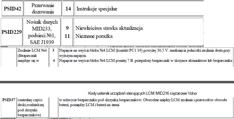

    Hello ! I am asking for help in reading faults according to codes / VOLVO FH 420 from 2008 /
    - MID 128 PSID 42 FMI 14 OBD / SAE J 1939 data link
    -MID 128 PSID 229 FMI 9 OBD
    -MID 216 PSID 37 FMI 4
    -MID 216PSID 78 FMI 12
    I will add that there is a problem with AD BLUE - it doesn't dose, and the front right lens / fuses is not lit, the filament of the lens OK /

    That's what I found:
    • Volvo FH 2008 Fault Codes: MID 128 PSID 42/229, MID 216 PSID 37/78 - AD BLUE Issues & Lens Problem mid.JPG (54.16 KB) You must be logged in to download this attachment.

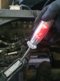

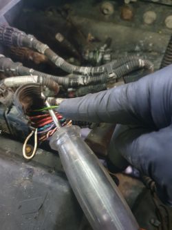

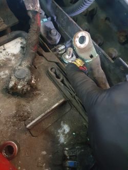

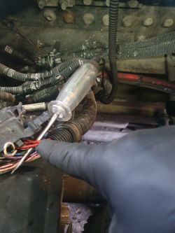

  • #9 18328602
    Piterr2212
    Posts: 25
    Rate: 27
    Check the voltage at the fuses,not the fuses themselves.
    Check the power supply at the plug to ADBLUE,pin3,4 DC voltage from the battery,red cables.
    Check voltage after ignition pub 24 ,green cable
    Check for corrosion on cables
