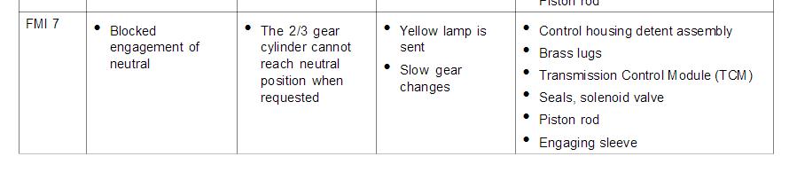

    WELCOME FOR ANY TIME, I HAVE A PROBLEM WITH VOLVO V AUTOMATIC DISPLAYS MID 130 PSID26 FMI 7 FAILURE WHEN I FIGHT VOLVO AFTER BREAKING THE AIR I WILL DRINK THE AIR WHEN I WANT TO TURNLESS I HAVE WRITTEN TO WRITTEN EVERYTHING COMES BACK TO THE STANDARD. THIS OPTION WILL APPEAR ONLY WHEN THE TRANSMISSION IS COLD, THE KIDNEY VALVE HAS BEEN REPLACED ON THE RIGHT SIDE AND THE MODES WILL BE MADE ALSO.

    First of all, correct your spelling and turn off Caps, because you actually don't read well.
    I understand that the gearbox selector is regenerated? After replacing the clutch and the rest of the procedures, the calibration passed? Done at all?
    Here are some hints (ENG), translate yourself:
    MID130 Transmission Control Unit, Fault Codes MID 130 PSID 26 Gears 2/3 Engagement System
    • Volvo FH 13 JShift: MID 130 PSID26 FMI 7 Failure, Air Braking Issues & Valve Replacement FMI 7.JPG (24.67 KB) You must be logged in to download this attachment.

    yes, everything done, calibration, also piston rod, complete set of sealants, all the new original clutch happens only after a pause and a long stop when the car is cold, as if the crate is calming, you can hear the air on the crate escaping and then the error pops out, I extinguish and it's ok but I didn't think that maybe under the coils of the selector which drum is jamming because it has no option and after re-ignition the error disappears

    If you can hear the air from the box vent, the pistons under the electronics for repair.

    It was possible to repair it quite by accident, the piston rod was cracked on the roller and it broke, but the whole cartridge was cleaned and new o-rings were replaced.
    The crack was in such a place that it was not visible until it cracked, it became clear. The costs are about PLN 700, the car now drives for 3 years and nothing
