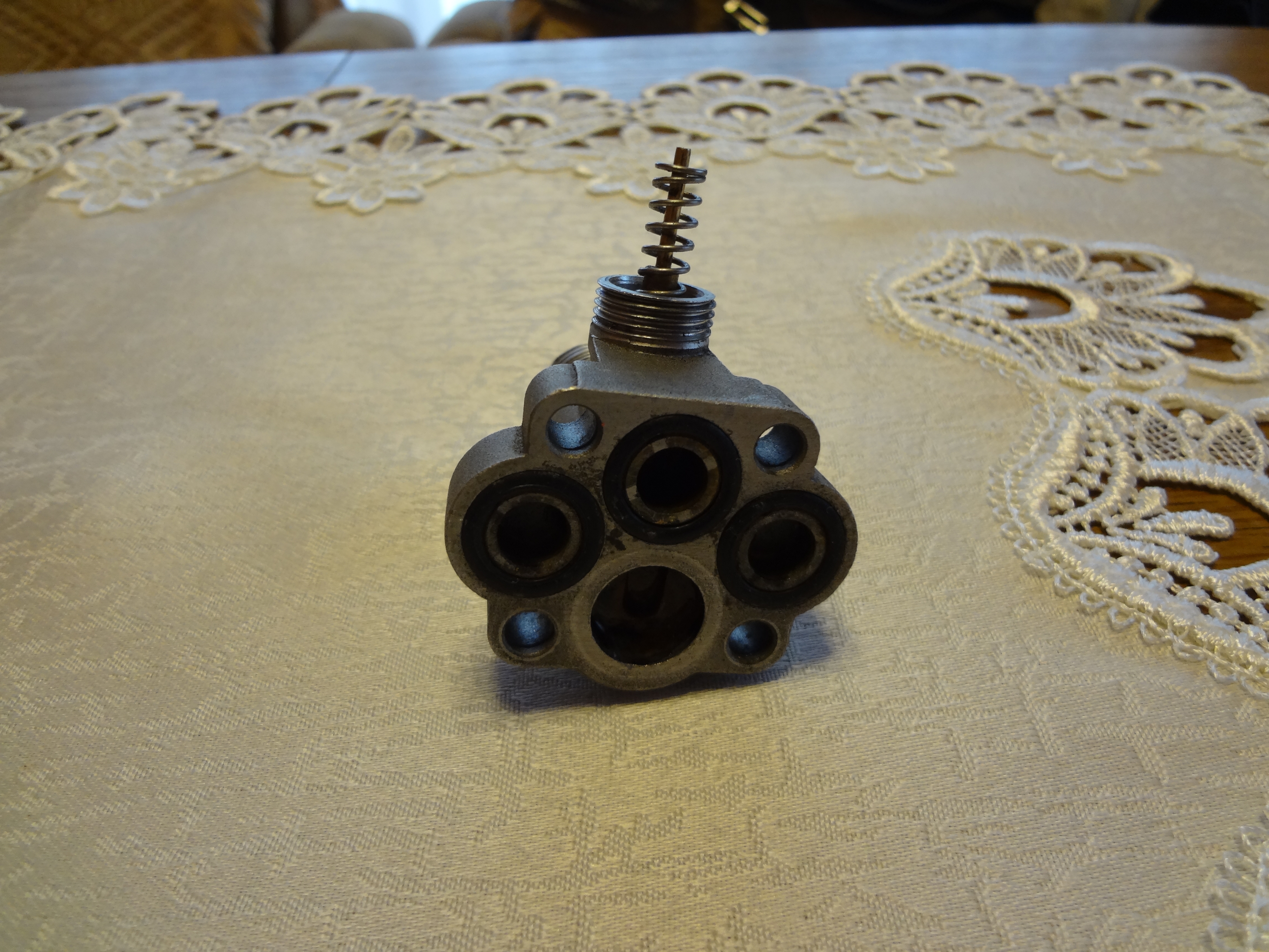

    I got a karcher washcloth from a friend, which once fell there and the housing fell apart. The housing would be added, there is only a problem with turning off the washer. The washer did not turn off at all and the lance was still pouring. I dismantled the lance and it turned out that the o-ring was torn off, so I replaced it, but after replacing the o-ring, it was torn off immediately. I dismantled the outlet stub and there was a plastic plunger with an O-ring that was "canted". I corrected, put it together, now it turns off, but after a few times it tears off the o-ring in the lance and I do not know what the problem is. I don't even know the karcher model.
    Does the valve in the outlet port stop accidentally at too high pressure? The spigot could be replaced but I don't know the model. Karcher Washer's Persistent Operation: O-Ring Tear and Unknown Model Identification Karcher Washer's Persistent Operation: O-Ring Tear and Unknown Model Identification Karcher Washer's Persistent Operation: O-Ring Tear and Unknown Model Identification Karcher Washer's Persistent Operation: O-Ring Tear and Unknown Model Identification Karcher Washer's Persistent Operation: O-Ring Tear and Unknown Model Identification Karcher Washer's Persistent Operation: O-Ring Tear and Unknown Model Identification Karcher Washer's Persistent Operation: O-Ring Tear and Unknown Model Identification
