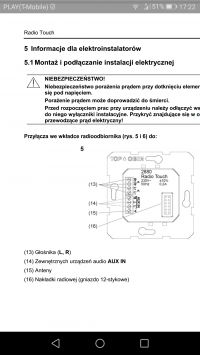

    Hello. Probably a trivial topic, but it wants to save time for experiments.
    I have installed the Hager Berker radio at the client's place, unfortunately the reception from the built-in antenna is practically none. The rado has an output to an external antenna, but has no screen. I would like to use an external antenna with an amplifier because after connecting a meter cable as an antenna, the reception is already satisfactory. I have both the UTP and the concentrator installed to the place of the antenna installation. I am asking for hints.

    Do you have a link to this receiver?
    Some photos..?
    The company is known to me for its electrical equipment, but I have not encountered their receiving equipment.

    This receiver is sensitive, but if it is to be installed, for example, in Węgrów, there will be such interference inside the building that with weak radio signals it will not be ...
    When writing about the pictures I meant the "back wall" or a plate with power terminals.
    Is there a clamp for the PE wire?

    Device in the second class of insulation,
    so only LN and L for the start signal. The radio works in the vicinity of Węgrów, where there is a great problem with the reception of any station in the room, and leaving a meter cable sticking out of the cans does not enter the game, it is a room with a strong emphasis on aesthetics. FM Antenna Options for Hager Berker Radio: Improve Reception with Amplifier & External Antenna

    Oki, that explains a lot, I have come across a similar device from a different company.
    I suggest:
    - bring a cable near the "radio" at the end of which an external antenna in the form of a simple dipole will be installed;
    - at the end of the cable we put an F plug and install a simple RF transformer used as a galvanic signal separator:
    http://www.dipol.com.pl/izolator_galwaniczny_5-2400mhz_signal_R48605.htm
    Its task is to fully protect both the antenna installation and the power supply and the receiver itself.
    The other end of the galvanic isolator is connected to the receiver as follows:
    - ground to the ground terminal at the AUX-IN input - the second terminal from the top (it is connected to the "electrical ground" of the receiver, common for audio and antenna inputs),
    - "hot wire" to the antenna terminal - the first terminal from the bottom in the same AUX-in input.
    If the signal is too strong - which is likely - we will put on an appropriate attenuator.
