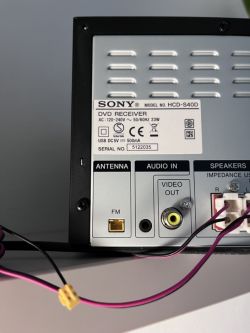

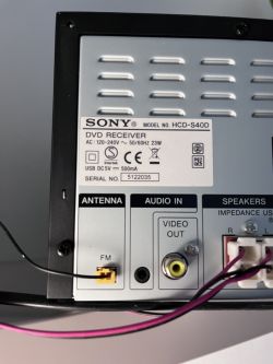

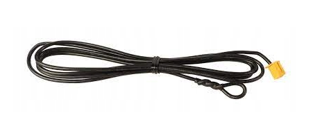

    I'm piggybacking on this topic because I have a Sony tower from the same CMT series (CMT-S40D). The set includes a piece of cable like this:
    Black cable with a yellow plug.
    The output in the tower looks like this:
    Back of a Sony device with connections, including an FM antenna socket. Antenna connector on Sony HCD-S40D stereo.
    The signal on some stations is weak (there is noise in the background), but when I move this cable or move the tower, it sometimes improves, how to improve this "antenna"? I don't want any external ones.
    Thanks in advance for your answers

    DIY antenna cable with male plug.
    Something like this, but it's not an antenna - you can make such a calculated DIY antenna yourself.
    From the electrical side, in this Sony, the second pin of the socket is grounded..

    It should be connected to the outer ring of the RF plug.
    I don't know if there is any adjustment in the plug to the 75Ω wave impedance of the antenna inputs, but in the case of this tower there is nothing at the antenna input - simplified as much as possible
