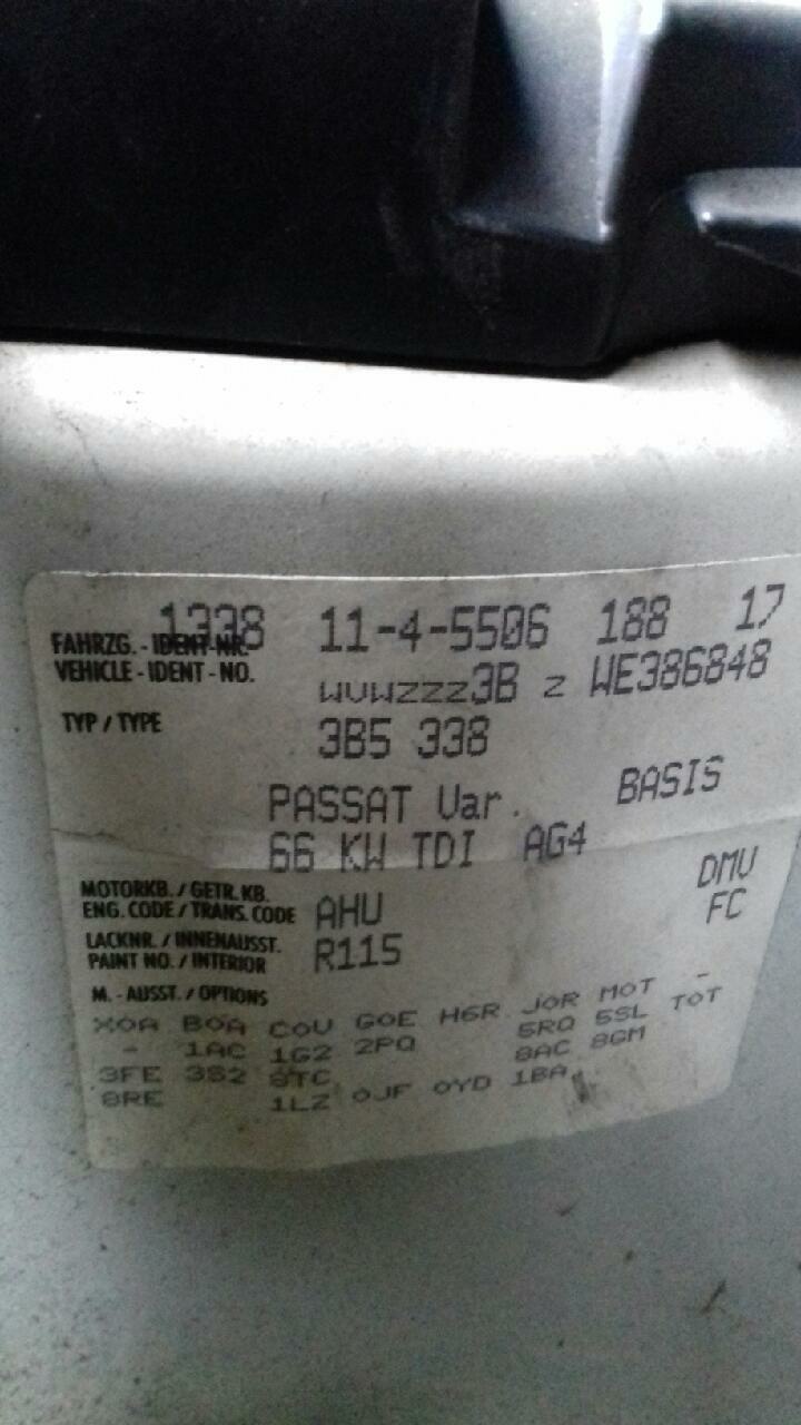

Where can I find the 3-letter designation of the automatic gearbox for a Passat B5 1.9 TDI 110, and which gearbox code fits it?
The gearbox code is a 3-letter mark, and you can find it on the sticker in the trunk near the spare wheel; it should also be on the gearbox area by the engine code on the right [#16807861][#16807947] For the Passat B5 1.9 TDI 110 hp, one reply gives DMX as the transmission code, and another says DMX is the 110 hp version while DMV was used on the 90 hp AHU engine [#16814568][#16824408][#16815315] EPV is also mentioned as a 110 kM version, and one reply says a car with DMX can use DMX, EPV, EPU, or DMU depending on the version [#16824408]

    I need your help and I have a passata b5 1998 1.9 tdi 110. with an automatic gearbox a 4 speed gearbox needs the mark of this gearbox because I have to replace it and if someone would have such a gearbox I would ask for contact and I may buy back. Thank you for your help

    I will check tomorrow and more or less how this marking will start
    thanks, I'll check back tomorrow

    DMX or EPV

    and I still have such a question tiptronic to fit my engine and whether it would be a lot to modify

    This is the designation of the ag4 box yes
    • where to find the designation of the passat b5 1.9 110 automatic gearbox IMG_20171110_120258.JPG (167.35 KB) You must be logged in to download this attachment.

    The gearbox marked DMV was mounted on AHU 90kM engines, not 110kM as you mentioned in the first post. 1 kW = 1.36 HP

    SORRY . THIS IS A CAR STICK WHAT SHOULD I BUY BOXES .... and I have this question because I have the DMX mark c and the box with the DMU mark. will fit my car
    Added after 57 [seconds]:
    SORVES DMV

    If your car has a DMX gearbox installed, it means that you have from 110hp. You can mount DMX, EPV (version with 110kM), EPU or DMU (version with 90kM).
