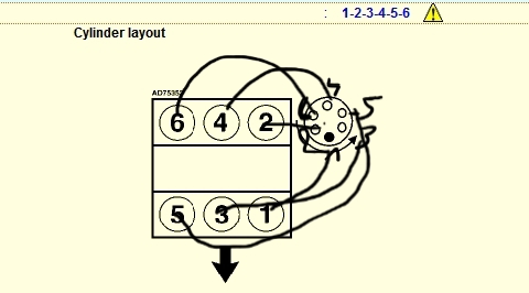

    Hello. My problem is that the car does not start after replacing the head gaskets. I have already checked everything, fuel valves spark, everything is fine, the suspicion is the order of ignition on my dome, the markings are 135462, i.e. the left head is burning while facing the car and the right one then separately ??

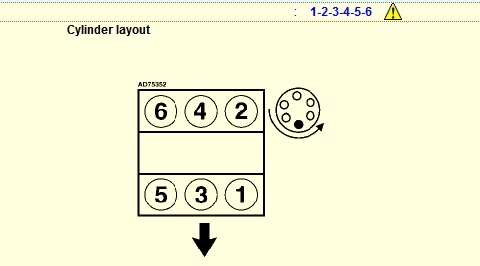

    Sonata G6T 3.0 V6 has this:

    From what is written on the Internet, the code of my engine is G6AT. I have drawn what is wrong with your attachment and for me it looks like this according to the dome, it smokes 1 3 5 and then 4 6 2, that is, as if the first left head would smoke, and probably it should be alternately? I'm not a michanik, but for common sense, something does not suit me, aha and one mechanic tells me that I look bad at the heads that the first cylinder is the one on the right, the first one at the ignition? I connect the wires as I drew, but is it good?

    #4 16811555
    DriverMSG
    Posts: 44094
    Help: 3984
    Rate: 4883
    The order of the cylinders is recorded as their order on the crankshaft.
    Set the shaft to the marks (top position) and check which piston is up.
    In addition, check the position of the finger under the manifold cap.

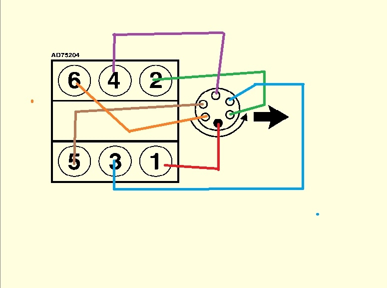

    Connect like this:

    #9 17153268
    DriverMSG
    Posts: 44094
    Help: 3984
    Rate: 4883
    After the firing order, do you connect the cables to the ignition device correctly - the domes?
    Check the position of the manifold finger with the first piston in the up position.
    From another V6 engine:
    As you can see, the ignition is 123456, but the pins in the dome are swapped.
    Check your dome with a meter - maybe it is similar.
    Galloper 3.0 V6 Won't Start After Head Gasket Replacement: Ignition Order Query (135462)
    Cables on the sides (heads) come out 3 next to each other

  • #13 17156693
    Kosimazaki123456
    Posts: 9
    I connected it as in the photo from you And the reason was the wrong ignition device I set up 1 cylinder And it was 3 now everything is fine and buzzing ?
