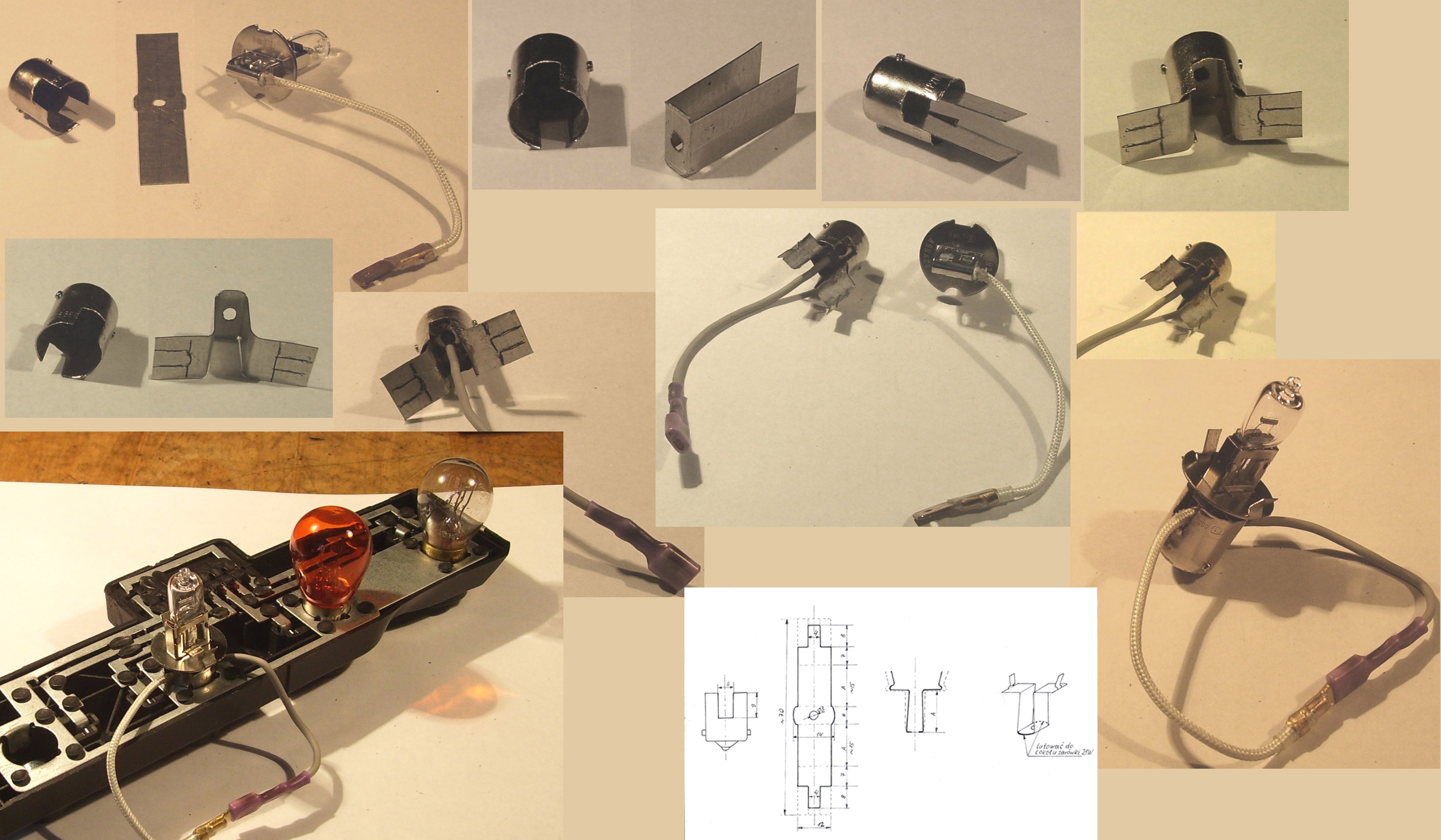

    As I "worked" a problem with this topic:
    https://www.elektroda.pl/rtvforum/topic2517258.html#12029654
    I will tell you that all these "additional" LEDs around the webcam are just so-called "marketing trick".
    Nothing replaces a decent bulb in the reversing lights. The bulb (or bulbs if there are two) should be at least 50W, as in the passing beam. Then there is no problem with visibility when reversing both with and without the camera. 21W bulbs typically used in reversing lights are actually just reverse gear indicators.
    Here is an example of how you can make an adapter for the H3 (55W) bulb for the base of a typical 21W bulb, usually used in reversing lights.
    LED vs IR LEDs for Reversing Camera: Comparing 4 IR LEDs vs 8 LED Lights for Night Vision
    There are also ready bulbs of more power with this plinth, for sale (already reworked).
