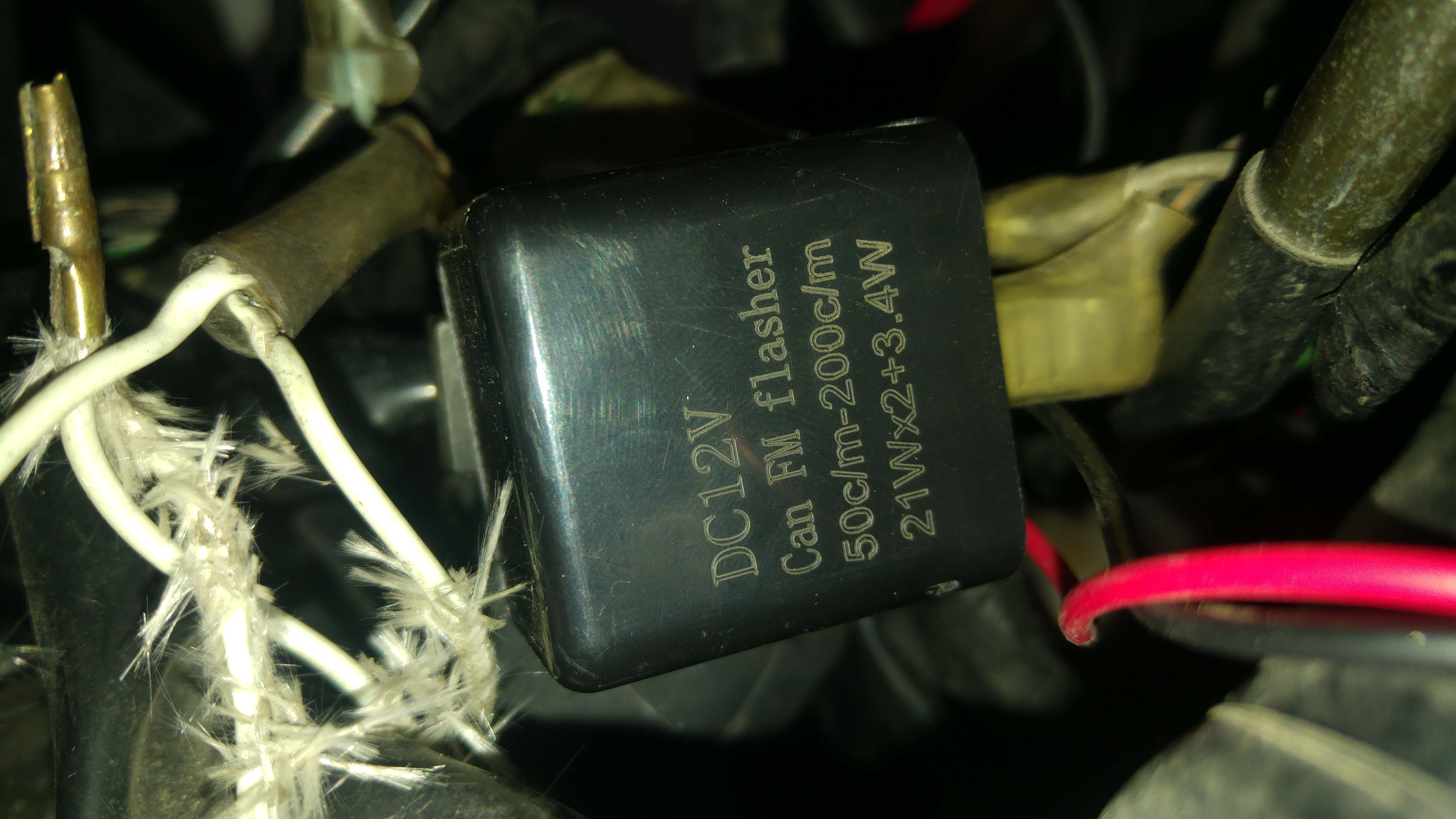

    I have a motocylk mail mounted ordinary bulbs in the direction indicators I changed them to LED_y SMD 12V / D35, in one direction there are these leds 11 directions are 4 pcs I changed the chopper to 50c / m-200c / m 21W x2 + 3.4W standard chopper used for directions the LED. However, this interrupter did not help the directions work incorrectly I read that you can use resistors, resistors and I just don't know in what parameters they should have
    • LED Turn Signals: Choosing Correct Resistor for Motorcycle SMD 12V/D35, 50c/m-200c/m 21W x2+3.4W 20170703_164757.jpg (4.9 MB) You must be logged in to download this attachment.

    I will add that 12V 23W bulbs were installed

    This will not be a dedicated led interrupter. Look for a dedicated interrupter, it will be the best and the cheapest.

    Well, maybe I also wrote to the writer, he wrote a new one because maybe this one doesn't work properly

    I have already got a new chopper works everything great, I just had to take out the light bulb informing about starting the directions, I think it is enough to change it to LED, but there is a small problem 2 diodes in the directions work non hundred, i.e. when I turn the left direction, the left turn signal lights all the time 2 diodes and the rest blinks as it should
