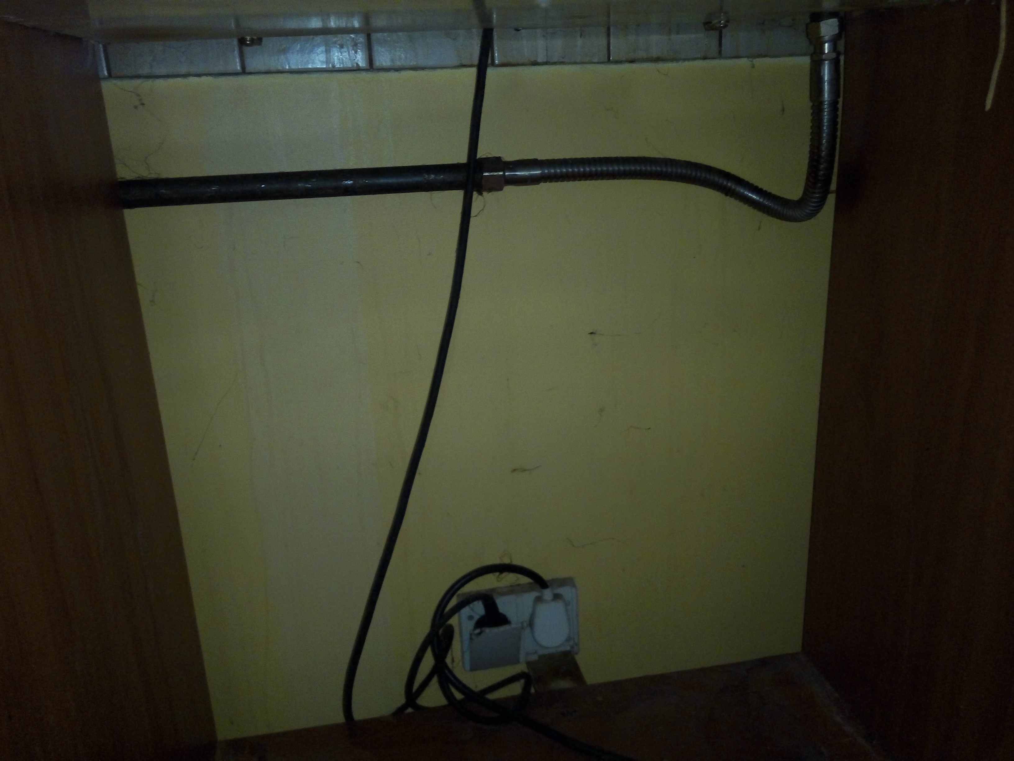

    I can't find a built-in electric oven up to 50 cm deep. I have gas under the burners so that only to such a depth can I slide the oven, at least from the right. The drawing may not be professional, but it more or less shows the picture. The depth I am writing about concerns the contribution without protruding elements. What I'm looking for ovens are 54-56 deep.
    Please help

    I understand that the gas supply pipe to the hob is disturbed. What is the total depth from the front to the wall ?.

    The depth from the front to the wall is 59 cm, except that there is electrical contact in addition to this gas supply. It is like this:
    from the front to the wall - 59cm
    from the front to contact - 54 cm
    from the front to the gas pipe - 49-50 cm
    just like in the picture.

    I did a market tour today. At Euro AGD I was able to pull out only one oven, the rest built-up. I managed to measure all the built-in media, even one of them. Only in MediaExpert they were built but loosely and together with the seller I measured a few. And we managed to find that maybe they will be good.
    These models are not what I wanted but because of the lack of sealing wax in something you have to bake :)
    What should be ok is:
    BEKO BIM32301XMS - although it may be in contact
    BEKO BIM22301X
    BOSCH HBA43S150E
    That's all it was possible to match.
    If someone had the opportunity to measure the depth of the ovens it would be nice.
    The middle back of the oven can be bulged up to 54-55 cm
    The most important is the right side. A lot of ovens, as I can see, have a sort of cut top and only the center is a few cm deeper.

    The only problem is the socket. Amica ovens have such a structure that the pipe should not be disturbing.

    Posts: 19
    Unfortunately, I did not match the oven perfectly. I bought BEKO BIM22301X 71L. I'm happy with the oven itself. Good price for quality
