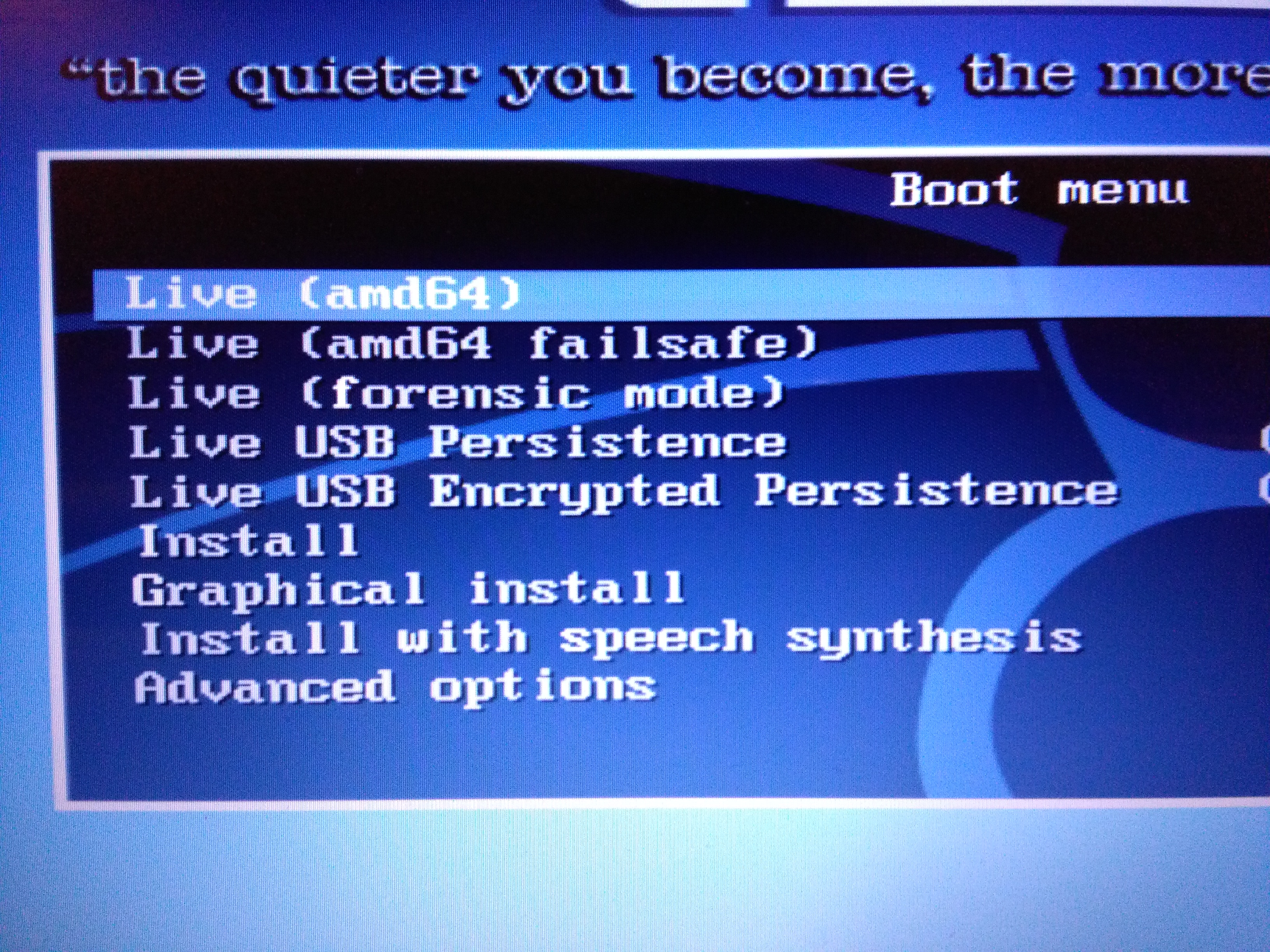

  • #15 16818473
    Adam Cisowski
    Pupil
    Posts: 174
    Rate: 9
    Foxtrott wrote:
    When starting at the very beginning you choose, if I remember correctly, from the menu: safe, live, persistance, install .....
    I only have install live (64 ...)
    and such different versions. I have nothing else. (There are no Polish characters because I'm on linux)
    Added after 6 [minutes]:
    In addition, there is nothing about automatic saving in the general settings or the disk.
    Added after 17 [minutes]:
    When I turn on linux
    • Launching and Saving Kali Linux Session on USB Pendrive: Prevent Reinstallation & Resume Later IMG_20171112_174501.jpg (3.78 MB) You must be logged in to download this attachment.
  • #16 16818663
    Foxtrott
    Posts: 1965
    Help: 253
    Rate: 944
    Live - without saving to usb
    Live failsafe - the so-called Safe mode of the Live version
    Live USB Persistence - it is possible to save progress on the USB flash drive.
    these 3 should only interest you.
    First, start Live alone (amd64).
  • #17 16819094
    Adam Cisowski
    Pupil
    Posts: 174
    Rate: 9
    Ok, I started live (amd64) and what next?
