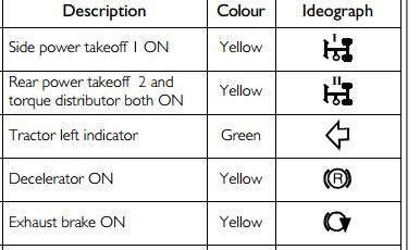

    What is the Iveco Eurocargo 2017 Indicator Function? Control Panel Explained Hello, can anyone help me with this control in Iveco Eurocargo which means>

    Engine brake in use. What is the Iveco Eurocargo 2017 Indicator Function? Control Panel Explained

    The friend is right. You can attach it in 2 options.
    1 when you press the brake it will activate
    2 when the accelerator pedal is released.
    The switch is in the center cockpit above the air vents.
