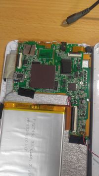

  • #6 16858400
    Noixer
    Posts: 145
    Rate: 13
    Overmax Newbase2 (ET) GR Tablet: Pattern Lock & Hard Reset Solutions, Firmware Inquiry
    photo of the motherboard
  • #7 16858532
    gradek83
    Posts: 9109
    Help: 930
    Rate: 2104
    Take off this thermo pad or heat sink because you can't see what's most important, if you manage to detach it.
  • #8 16858917
    Noixer
    Posts: 145
    Rate: 13
    86S V2.2
    28 May, 13
    that is under the thermopada
  • #9 16858935
    gradek83
    Posts: 9109
    Help: 930
    Rate: 2104
    It is about the marking on the integrated circuit
  • #10 16858937
    Noixer
    Posts: 145
    Rate: 13
    ATM7023A processor

    In that case, you download the file to which the link was given to you by your friend nomudrek in the post # 2 you download the file
    NEWBASE II.zip is unpacked and you have files there:
    NEWBASE_2_SOFT.zip
    Pad Product Tool_V1.2.04.zip
    Universal Adb Driver Setup.zip
    Driver_Auto_Installer_v1.1208.00.rar
    And now you need to unpack Pad Product Tool_V1.2.04.zip and install Pad Product Tool via setup.exe, run setup.exe file as administrator I don't know what operating system you have on XP you normally install. (During installation, the program may let you know that it wants to install the drivers, you agree to install them, if there is any error, the system will have to be run in no digital signature and then it should move)
    After installing, if the tablet is normally detected and does not call drivers, ok, and when it does, you have these two Universal Adb Driver Setup.zip files and Driver_Auto_Installer_v1.1208.00.rar, after unpacking, you will find the drivers there.
    If you have installed drivers, start Pad Product Tool in this program, your tablet should be visible, choose NewBase2.fw file from the previously unpacked directory NEWBASE_2_SOFT and upload.
    This OV-Newbase 2.pdf manual is for tablet but with Rockchip RK2928 version, so don't even read it.

  • #12 16871751
    Noixer
    Posts: 145
    Rate: 13
    gradek83 wrote:
    To initialize the tablet in the program, turn it off, press VOLUME + completely and while holding it connected to USB
    this tablet has no vokume buttons ... just power and reset
    USB recovery by shorting pins 7 and 8
    #13 16871802
    gradek83
    Posts: 9109
    Help: 930
    Rate: 2104
    Open the tablet as shown in the picture, connect the USB 2.0 cable in the PC and under the tablet.
    Put the needle between the pins marked in the picture, counting from the top 8 and 7 pins, short-circuiting them.
    Press the reset button for 3s, release it and after a while it will initiate the detection of a new device on the PC, release the needle from the pins.
    Next, as in the description.
    Of course, this option does not necessarily work for this tablet model.
  • #14 16871974
    Noixer
    Posts: 145
    Rate: 13
    Thanks! It works!
