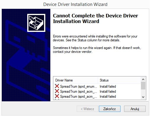

    I have a problem downloading firmware to the tablet.
    I am forced to upload new firmware because I have a virus on my tablet that cannot be removed.
    The tablet itself turns on the WiFi network, if it gains Internet access, pop-up windows with Chinese subtitles.
    Reset to factory settings does not help.
    I downloaded the software from the manufacturer's website.
    The "UpgradeDownload.exe" program can see the device but cannot start uploading.
    I tried different combinations with the '+', '-', 'reset' and 'on' keys.
    Does anyone have a proven solution?

    I don't know what instruction you mean.
    I downloaded the program, soft.
    I installed 'USBrwSCI-android-usb-driver-jungo-v4'
    I started the program, loaded soft (Qualcore 1020.pac), start downloading, connected the turned off tablet and turned on the tablet by key combination.

    Added after 15 [minutes]:
    There are no errors in the device manager.
    Immediately after connecting the tablet, "SPRD COM Enumerator" appears, but then disappears.
    At this point, you need to install the drivers and then it should get it. If the driver is already installed, try vol- plus vol + and power.

    Drivers installed.
    I also tried this key combination (vol- vol + power).

    Hello. Did you deal with this tablet? I bought the same dad. He used it several times, and that's how it lies. The annoying thing is that windows were popping up all the time. Today he wanted to use but the message "Sorry, shell application has stopped" popped up. I called the service, they told me that the system has crashed and you need to upload a new one. I pulled out the memory card and now the green android man is lit on the white screen. It cannot be turned off or reset. After pressing the reset turns off, but in a moment turns on again. I tried to follow the instructions but I was already stuck on the USBrwSCI-android-usb-driver-jungo-v4 'installation.
    Tablet Overmax Qualcore 1020 3G - you cannot upload the firmware
    Installation error keeps popping up. Has anyone had such a problem?

    nutergsm wrote:
    I cannot connect a device (tablet) before installing the USBrwSCI-android-usb-driver-jungo-v4 'program. The tablet is not visible. Has a damaged system. I have already reinstalled windows in my laptop but the problem persists. I will have to check on another laptop. Maybe the older one will go?
  • #20 18208645

    The device manager does not completely detect the thread? Maybe the USB socket and the tablet is damaged or the cable.
  • #21 18212064
    billy1979
    Posts: 141
    Rate: 35
    nutergsm wrote:
    The device manager does not completely detect the thread? Maybe the USB socket and your tablet is damaged or the cable.
    Detects device unknown and yellow question mark.
  • #22 18212135
    nutergsm
    Posts: 8429
    Help: 1034
    Rate: 1665
    Well, I gave instructions on how to find and install drivers. Enter the device ID.
  • #23 18213020
    billy1979
    Posts: 141
    Rate: 35
    Device ID: USB \ DEVICE_DESCRIPTOR_FAILURE. From what they told me while talking on the phone, I must first install this program USBrwSCI-android-usb-driver-jungo-v4 'to be able to install a new tablet operating system from a laptop. Unfortunately, but I could not install this program on my computer or on my brother's computer.
