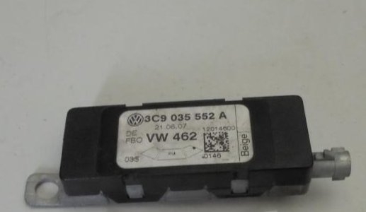

    Later I read that there are still some amplifiers in the side pillars in the car and they look like this
    Passat b6 sedan - poor FM reception after replacing the radio with non-factory
    Now somebody tell me which amplifier the radio should give these 12V to?

    I would leave those in the pillars looking at the diagram I have, I think you should look in the antenna from the rear window. In addition, I would review cable TV. best regards

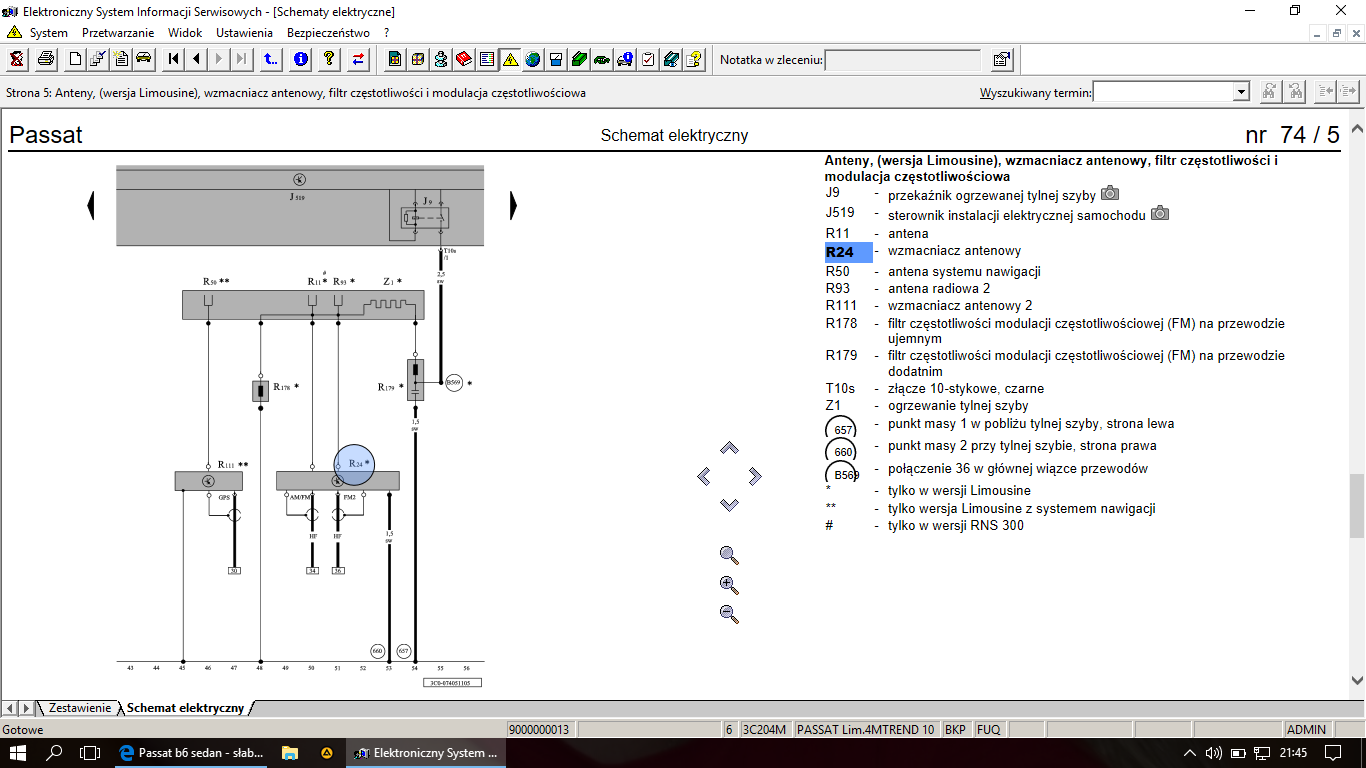

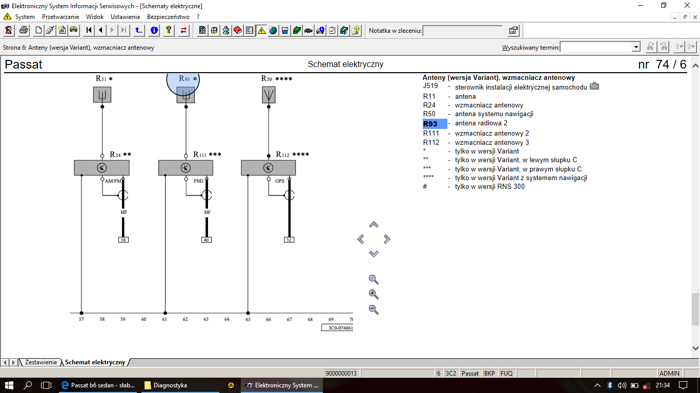

    Wait wait, I found something else .... passat b6, variant?
    • Passat b6 sedan - poor FM reception after replacing the radio with non-factory Zrzut ekranu (6).png (106.25 KB) You must be logged in to download this attachment.
    As in the subject, this is a sedan
  • #11 16830748

    Correct if bad data but it seems to me that I thoroughly checked ...
    • Passat b6 sedan - poor FM reception after replacing the radio with non-factory Zrzut ekranu (8).png (124.68 KB) You must be logged in to download this attachment.
