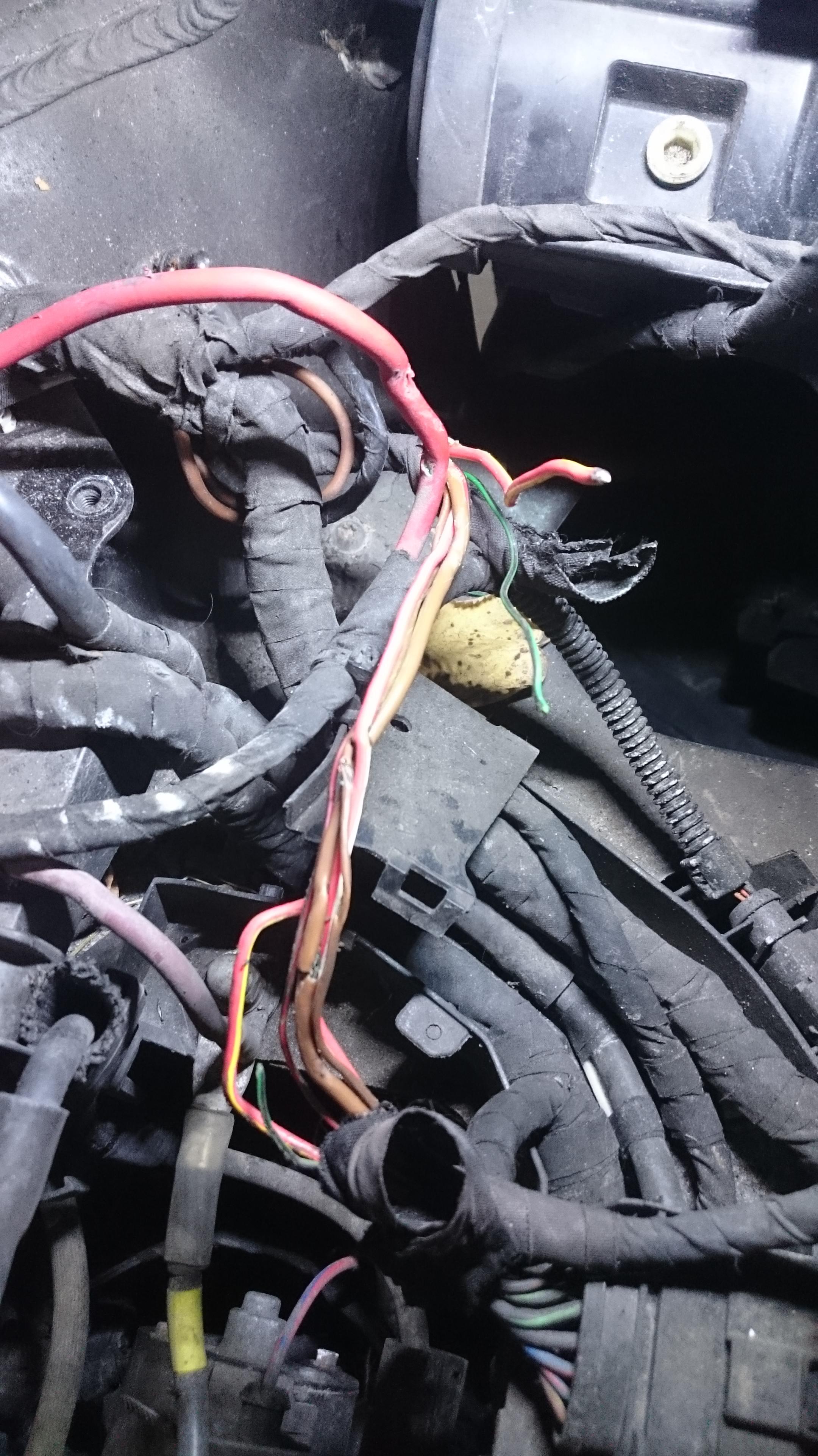

    While driving, the radio turned off for a split second. Later, the whole board started to turn off together with the radio (speedometer, tachometer, etc.). Currently, the radio is dead and the clock board is dead (speedometer, tachometer, mileage etc, nothing displays). All fuses OK. Is this a typical fault with this model? Can someone suggest where the power cables go to these components?
    Best regards.
    Added after 6 [hours] 26 [minutes]:
    There is only 6V on the radio power plug (RNS315EU) on both the + and Ub + terminals (with the radio disconnected). Is there any stabilizer on the way? Does the F7 fuse under the hood next to the battery only power the radio or the clocks?

    Can you take a picture of this stabilizer?
    I decided that from the box in the engine compartment, there is a plus to the cabin, which powers the radio and clocks, and it leaves, but does not reach the cabin.
    Plus it should be constant, no ignition.
  • #5 16313528
    d.j.k.
    Posts: 8
    Photo in the attachment. The cable for the radio goes na 100% from this module. The module is mounted in the left front wheel arch. Passat B7 2.0TDI 4motion - No power to the board and the radio

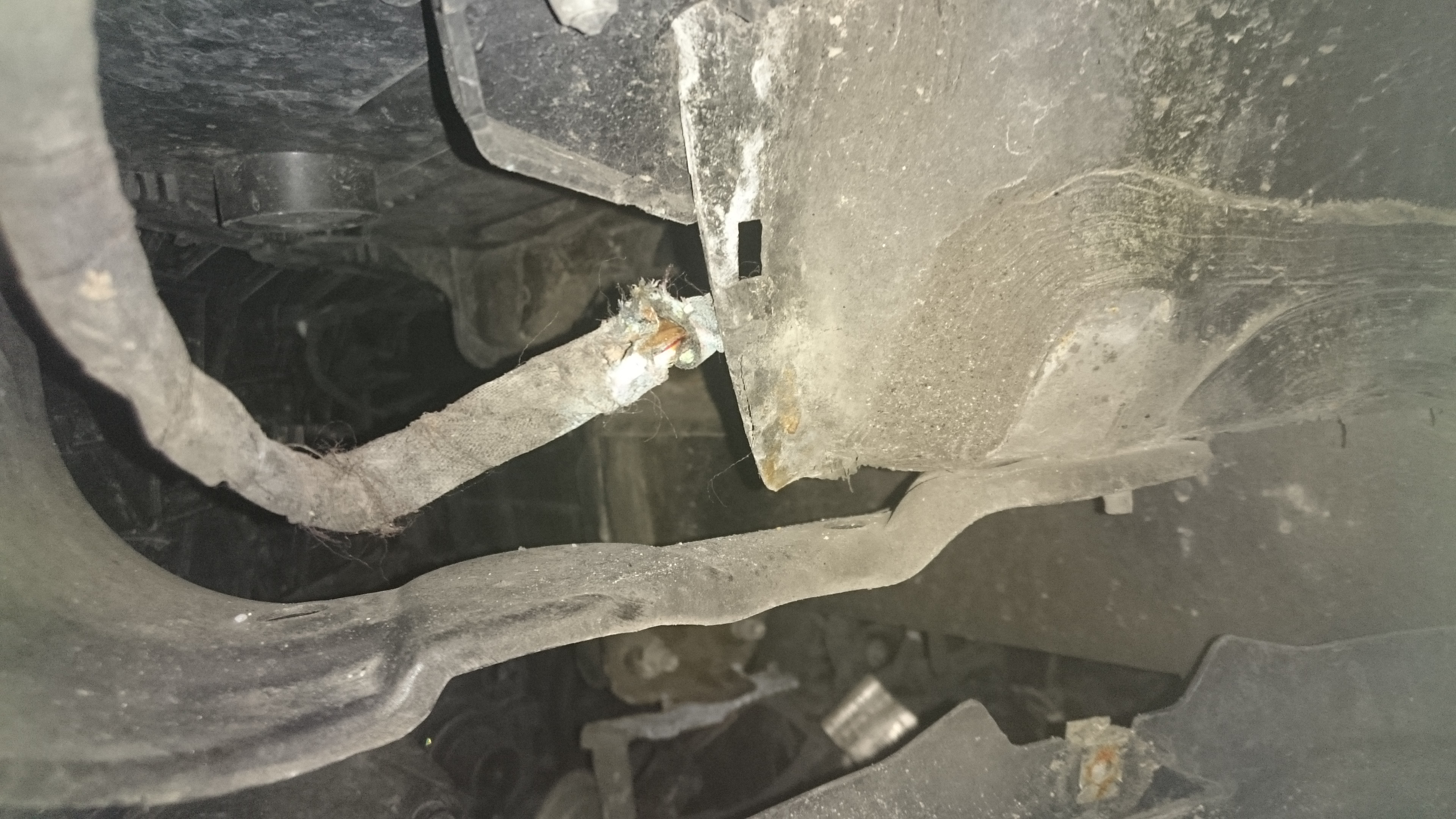

    Defect found.
    Wires to the module crushed against the chassis members and rotten.
