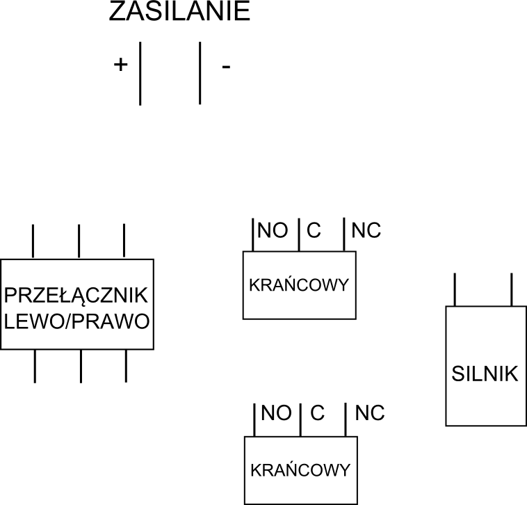

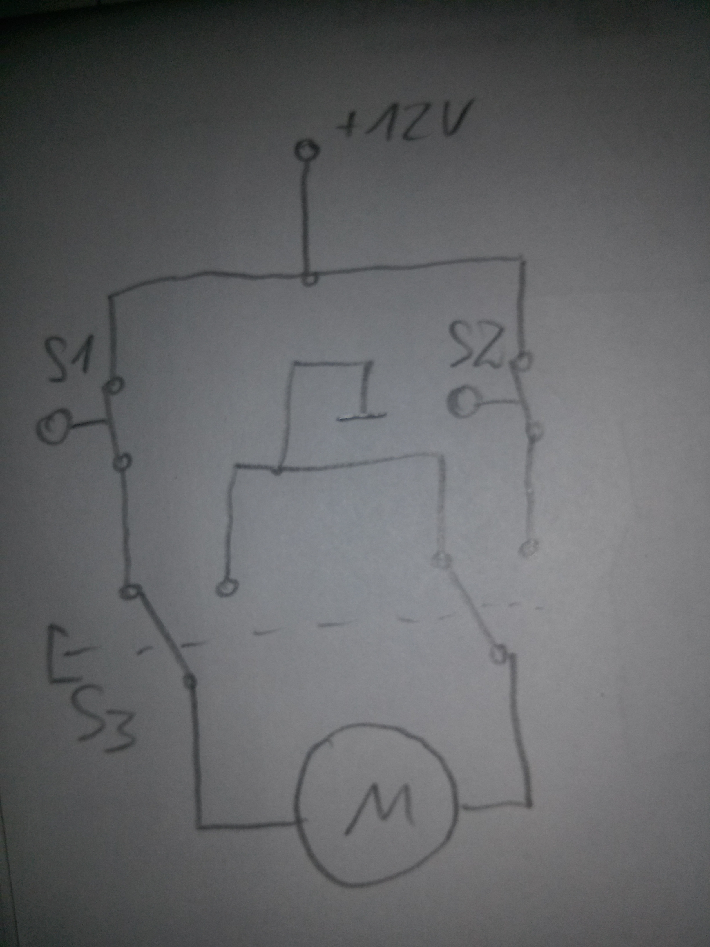

    Forumers can I ask you for help in connecting the wiper motor system to the left-right switch (photo in the attachment) and two limit switches.
    I also attached a picture with the layout elements that I would like to combine.
    Thank you in advance.

  • #2 16831005
    dioda1000
    Level 28  
    Posts: 833
    Help: 143
    Rate: 132
    Describe how it should work.
    And try to connect if something goes wrong it will improve.

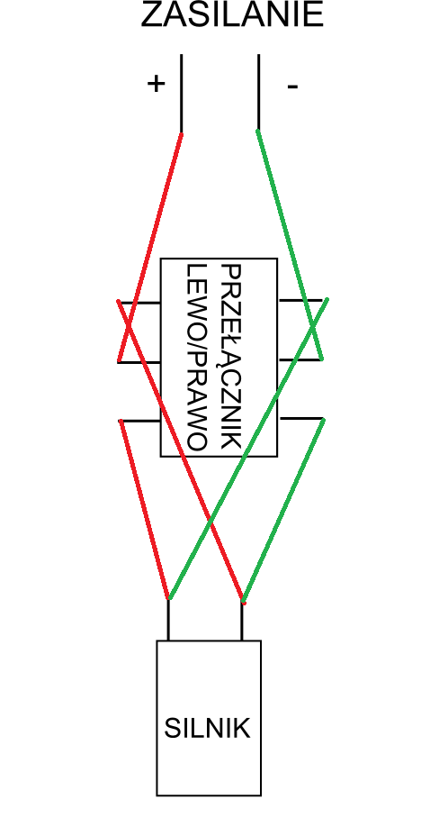

  • #3 16831011
    kana23
    Posts: 372
    Rate: 69

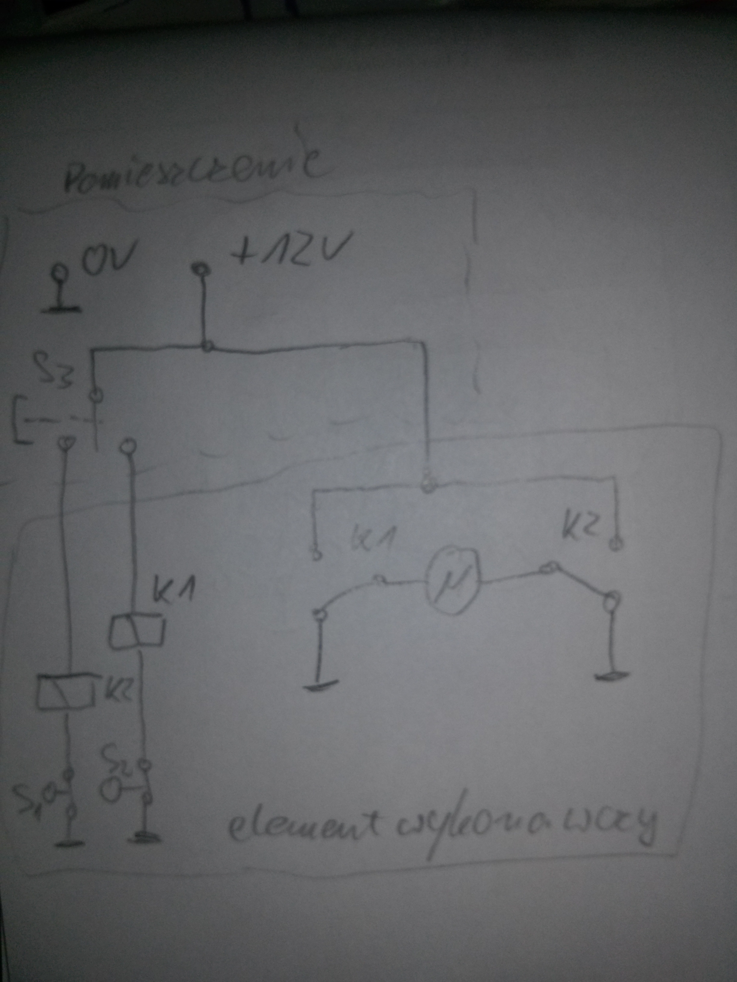

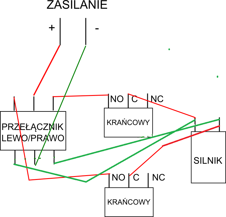

    The motor will be connected to the screw moving the nut. Limit switches are to stop the nut at the left and right end of the screw. And the left-right switch will control the engine.
    Would such a thing pass the exam?

  • #4 16831032
    michalek1988
    Level 26  
    Posts: 675
    Help: 68
    Rate: 181

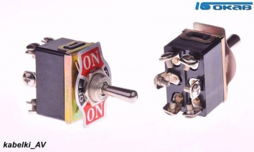

    Maybe at the beginning, draw it yourself without the limits, and then include them. It will be easier for you to understand how it works.

    ok, if I put on a switch like that, something will change?
    Without extreme I would submit it like this.

  • #6 16831072
    michalek1988
    Level 26  
    Posts: 675
    Help: 68
    Rate: 181
    This is the same (in electrical terms) switch as from one post. They differ in casings. In addition to NO (normally open) and NC (normally closed) contacts, limit switches are also provided. You haven't used the latter in your diagram, think about why, what role it plays and what would happen if you connected in the way you drew. In which direction the engine will spin, which will happen when a nut reaches one of the ends. As a hint, analyze how the limit switches work, maybe you have some, e.g. removed from the printer and the meter, you can measure what happens in such a situation. Instead of giving the P / L switch, the PS may be enough for you with the switch and limit switches, then the motor, after receiving the voltage, would rotate to the left and then turn back. The direction of rotation would be constant, regardless of the starting position.

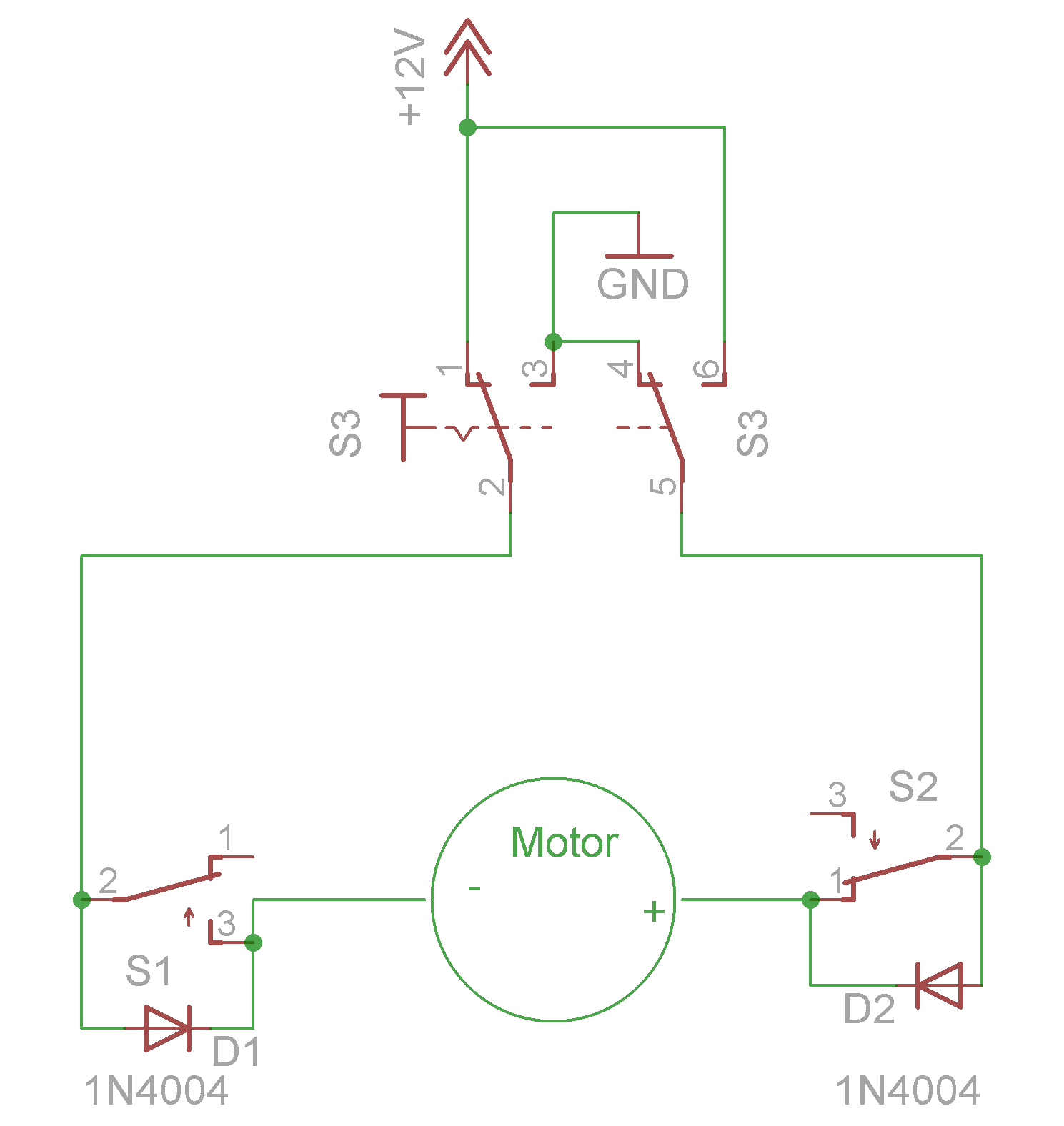

    Wiper Motor System Connection with Left-Right Switch and Two Limit Switches
  • #8 16831255
    dioda1000
    Level 28  
    Posts: 833
    Help: 143
    Rate: 132
    Diagram of colleague REMUR. work :) . With a small 'but' the wiper motor draws a little more than 1A. So use a suitable diode. Limit switches also for the appropriate current.

    The operator must be able to choose whether the engine will turn left or right. The system will not work often and long. The whole will be mounted in one room on one machine. Will the Art.B solution "without diodes and oddities work or do I have to have something else? Alternatively, how strong diodes should I use?"
    I have such ones: http://lispol.com/produkt/przelacznik-krancowy-mikro-z-dzwignia-18mm---80100

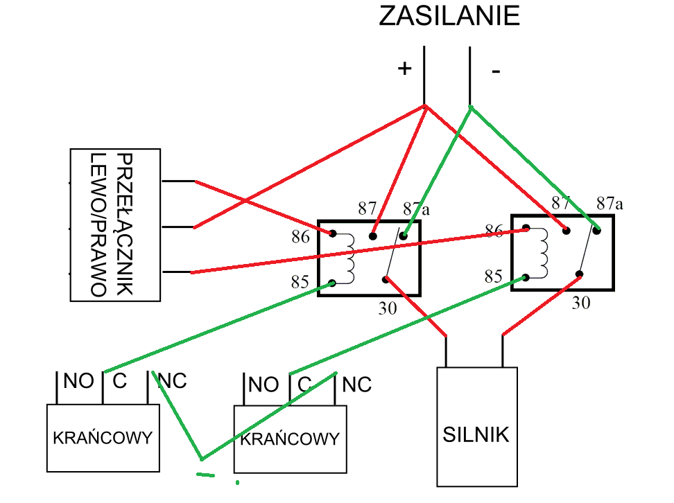

    I think I'm starting to understand, I think :) is your schematic with relays to be connected as I have drawn it? I'm not sure if I did the right thing -.

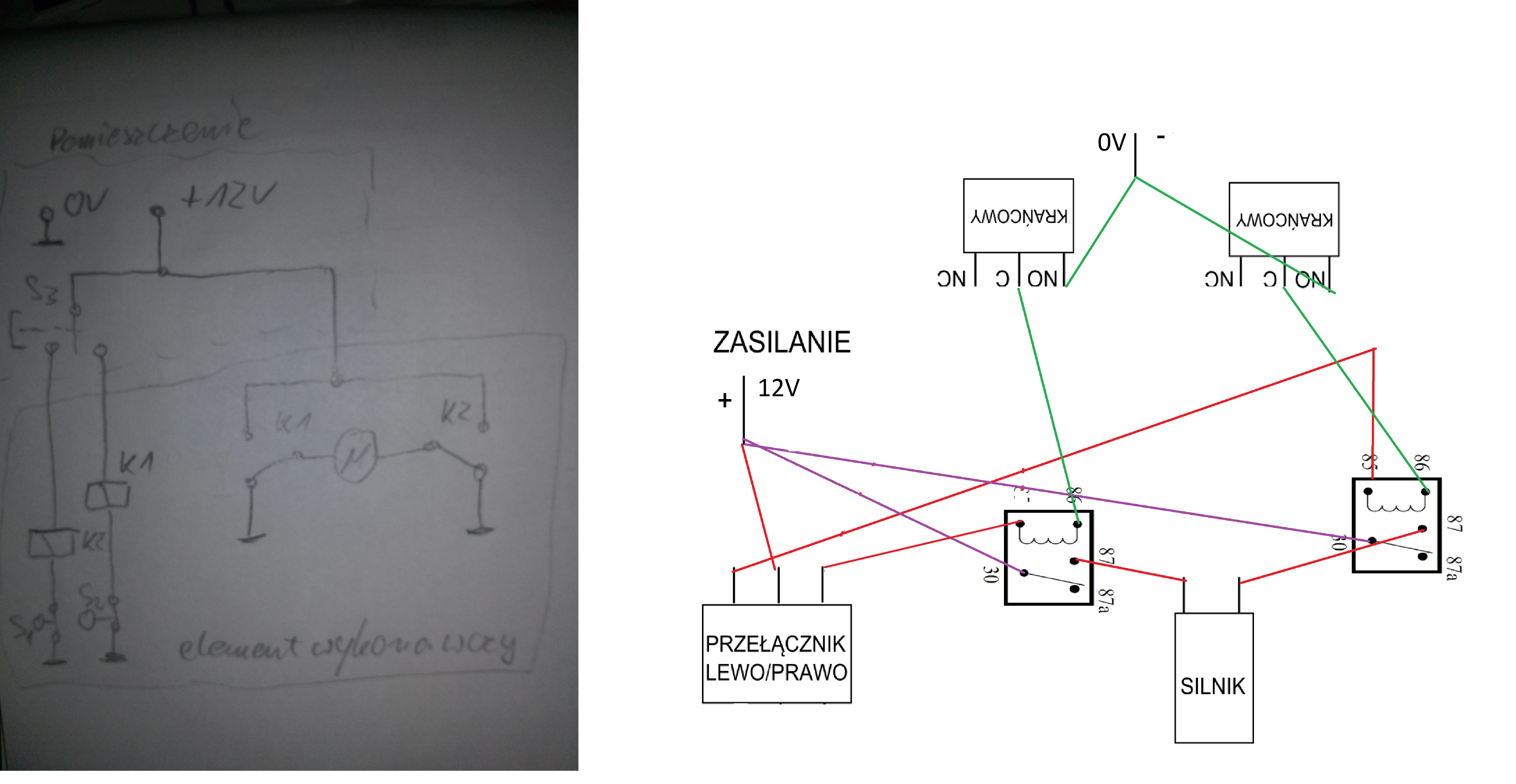

    I corrected, please check. I have analyzed and understood the action.
