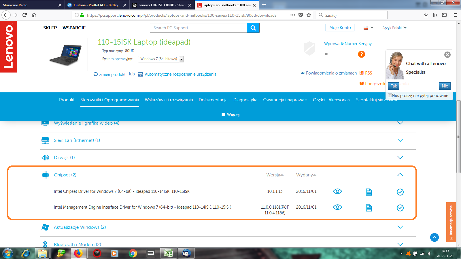

    Looking for drivers from the topic. Unfortunately, the drivers from the manufacturer's website do not work.
    PCI Simple Communications Controller
    PCI \ VEN_8086 & DEV_9D3A & SUBSYS_381917AA & REV_21
    PCI \ VEN_8086 & DEV_9D3A & CC_078000
  • #3 16836982
    fonexpl
    Level 4  
    Posts: 430
    Rate: 68
    Board Language: polish
    This is what is marked in the frame in the picture.

    What do you mean by it? Have you downloaded, unpacked and installed from the device manager? Do you get a message?

    I have an unrecognized device "PCI Simple Comunications Controller" in the device manager. It installs the driver from the frame, I get an error.

    I installed the file from the link and still the same. And after installing the drivers from the manufacturer no error pops up (sorry for the mistake). The drivers are installed normally, a message about restarting the computer appears, and then the driver is still missing.
