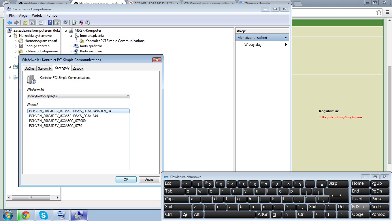

    Hello, I have a problem with installing the "PCi simple Communications controller" driver and I do not have a voice, red cross next to the sound icon?
    Identifier: PCI \ VEN_8086 & DEV_8C3A
    Windows 7 64bit.
    • Problem with installing the driver for PCi simple Communications. 5.jpg (228.88 KB) You must be logged in to download this attachment.

    Download what you have on the site, you have written that the driver also works under w7, which you pasted!
    Why are you posting this useless manager screen?
    PS. Start thinking a little and do what is written to you.

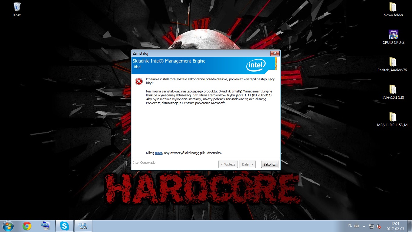

    There was an error installing realtek? Problem with installing the driver for PCi simple Communications.
    When I was installing from the disc, the same message was displayed.
    Unable to install: ME (v11.0.0.1158_MEI)
    Only this driver I uploaded INF (v10.1.1.8)
    • Problem with installing the driver for PCi simple Communications. Bez tytułu.jpg (218.77 KB) You must be logged in to download this attachment.

  • #18 16249735
    Kasek21
    Posts: 45497
    Help: 4960
    Rate: 3501
    Board Language: polish
    Install SP1.
  • #19 16249777
