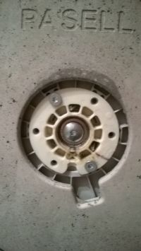

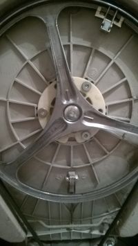

    I found similar threads, but in practice came out discrepancies and replacement of bearings failed. Problem - spinning noise. I replaced the shock absorbers, there is a small improvement, finally, with the advice of the forum, I ordered bearings with grease on both sides. I used this thread, but there are differences that I have not gone through link
    First of all, I have central TORX 40 screws on the belt side logical that I have to unscrew it to get to the bearing, and from the passive side is this a necessary condition? How do you unscrew it, and specifically how to lock it, because the whole drum turns when you try to unscrew it? I have a fairly tight belt, take it off forcefully from a large wheel, right?

    #2 16838365
    Paw_el
    Home appliances specialist
    Posts: 3503
    Help: 592
    Rate: 1551
    Artiks wrote:
    from the passive side is this also a necessary condition?
    Yes
    Help from another person will be useful to you
    Yes.

    #3 16838389
    dzi_dziuś
    Posts: 2046
    Help: 341
    Rate: 1170
    Slightly slide it off and by turning the wheel it will fall by itself, assembly in reverse order. Then you will be able to make sure about the condition of the bearings - visually (although this is a poor indicator) there is no tragedy. Screw out the same way from the passive and active side, but stock up with a decent wrench, the screws screwed in the axles will probably be reinforced with glue. As for rust. Tear all this bladder off the enamel, clean the metal sheet and renew the bath tubs with enamel, it will be almost like a new one :)

  • #5 16840488
    h jaworski
    Posts: 4786
    Help: 466
    Rate: 717
    For this rattle it can be a good piece of extension tube.
