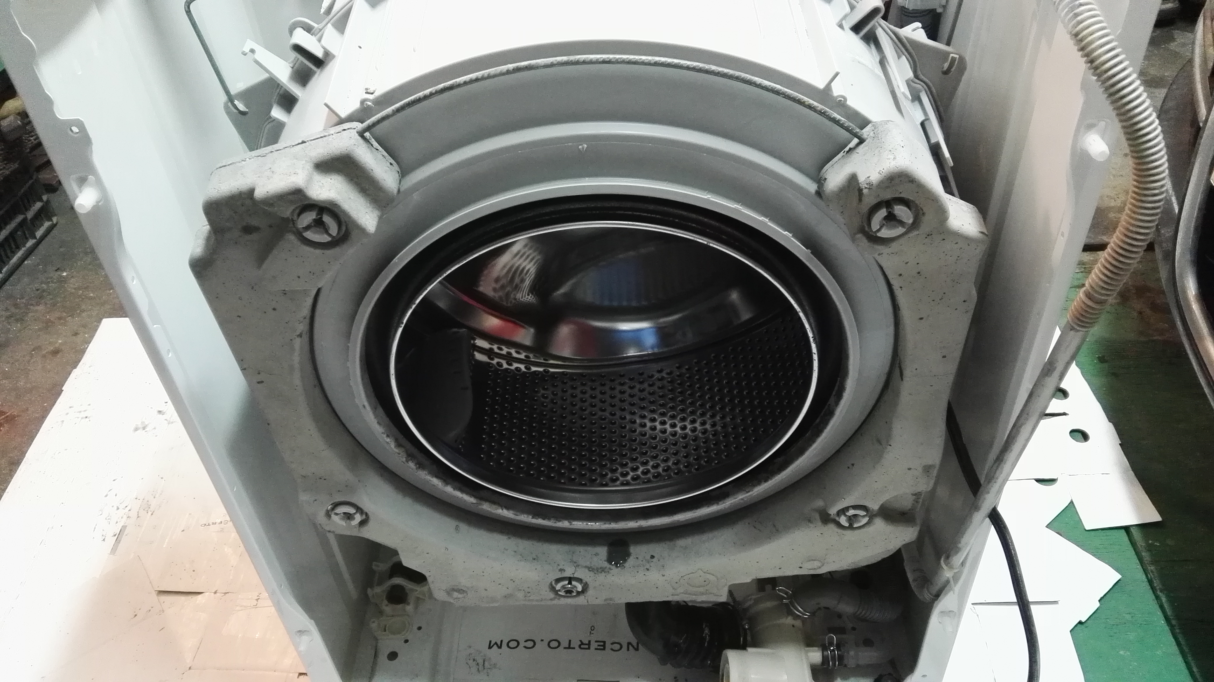

    Unfortunately, in my washing machine the drum bearing has probably fallen. The washing machine began to rumble quite heavily when spinning.
    After a few phone calls to the warehouse, I learned that it is impossible to replace the bearing itself (despite the fact that it is available for purchase) because the drum tank is glued and it is not possible to remove the drum and knock out bearings without cutting it.
    Is any of the forum members able to confirm this information ?? Perhaps there is a mania, how to undress the tank ??
    Is it possible to cut it on the weld line itself, and then glue with silicone to the glass?
    Out of curiosity, I took the back of the washing machine, unscrewed the wheel and everything looks quite straight like any other washing machine. The bearing used is PPL Poland 6304Z. In the warehouse for one bearing (and from what I've learned there are two), they're screaming 40 zlotys. I do not want a PPL bearing anymore, so at Allegro I found the SKF 6304 2Z (ZZ) bearing for PLN 30 a piece. Is it the same?
    The model of the washing machine is Electrolux EWS 126540W NO 9145292207/01
    Attached photo of the back of the washing machine:

  • #9 16228984
    Szef22
    Posts: 79
    Rate: 28
    The washing machine is pulled down, the washing group is cut with a saw blade (fleece or multitool is not suitable for this), holes for 5mm screw drills, bearings and sealant stamped
    External is 6304ZZ
    Internal 6206 ZZ
    Sealant 35x62x10 / 12.5
    The brass ring of the sealant on the cross was full, without scratches, rubbed it with only a paste to remove rubber and dirtiness
    Drum unit glued with adhesive for Boll glass. After 4 days of gluing the washing machine folded and unfortunately disappointed. The reale syndrome is leaking. The glue did not combine with the plastic even though it was ground with a paper and degreased.
    Currently, approach No. 2 with CX 80 Hybricx hybrid
    http://www.cx80.pl/nasze-produkty/kleje-hybrydowe-cx80/cx80-hybricx-premium-detail.html
    Today, the leak test
    Below the photos from the disassembly Maybe someone will be useful

    If I see correctly, then there are too large gaps between the screws.
  • #11 16230054
    Szef22
    Posts: 79
    Rate: 28
    The screws are every 20 cm. It was not possible to go deeper because of the tank's riffling. It simply was not like a drill or a tank rim was too small to be drilled safely

    In my opinion, it leaks because, at the beginning, you have squeezed the two halves too much and the glue melted away from the sides. I did it the first time. Now I connect the two halves, leave for a few hours until the glue catches a little and then I screw it.
  • #14 16231357

    It seems that the basic mistake is to twist the bathtub with too few screws. From the pictures shown it appears that you first cut the tank first and then you drilled the screw holes. These carpenters also made their deformation, which deformed from the bottom. Both the types of glue used for car windows and the ones used by you are good, the silicone is also good roofer which also has a grip for wet ground. Good luck.

  • #17 16284348
    Szef22
    Posts: 79
    Rate: 28
    A few notes for posterity.
    After cutting the container from one of the halves I dropped a plastic pen (the halves are connected like a paneling with a tongue-and-groove). Before proper gluing, I suggest to first glue the resulting groove and leave it for one day to dry it dry. When gluing on the so-called once glue in the groove was not bound even after 4 days (I checked because I split the tank twice).
    Screws every 20 cm are enough. When screwing the engine to the tank, I advise you to take a close look at whether it extends the tank halves.
    For me, after cutting the tank, about 3 mm of the weld escaped, which caused that after tightening the engine, its handles stretched the glued halves of the tank (two times over the engine I had a leak). If this problem occurs to someone, I suggest using washers. It should be selected so that the body (mounting) of the engine squeezes the two halves of the tank.
    Thanks to the above repair I have two efficient washing machines. The new Amice TAWE6123LSLDS with a demountable tank and replaceable bearings and the old Electrolux EWS 126540 W
