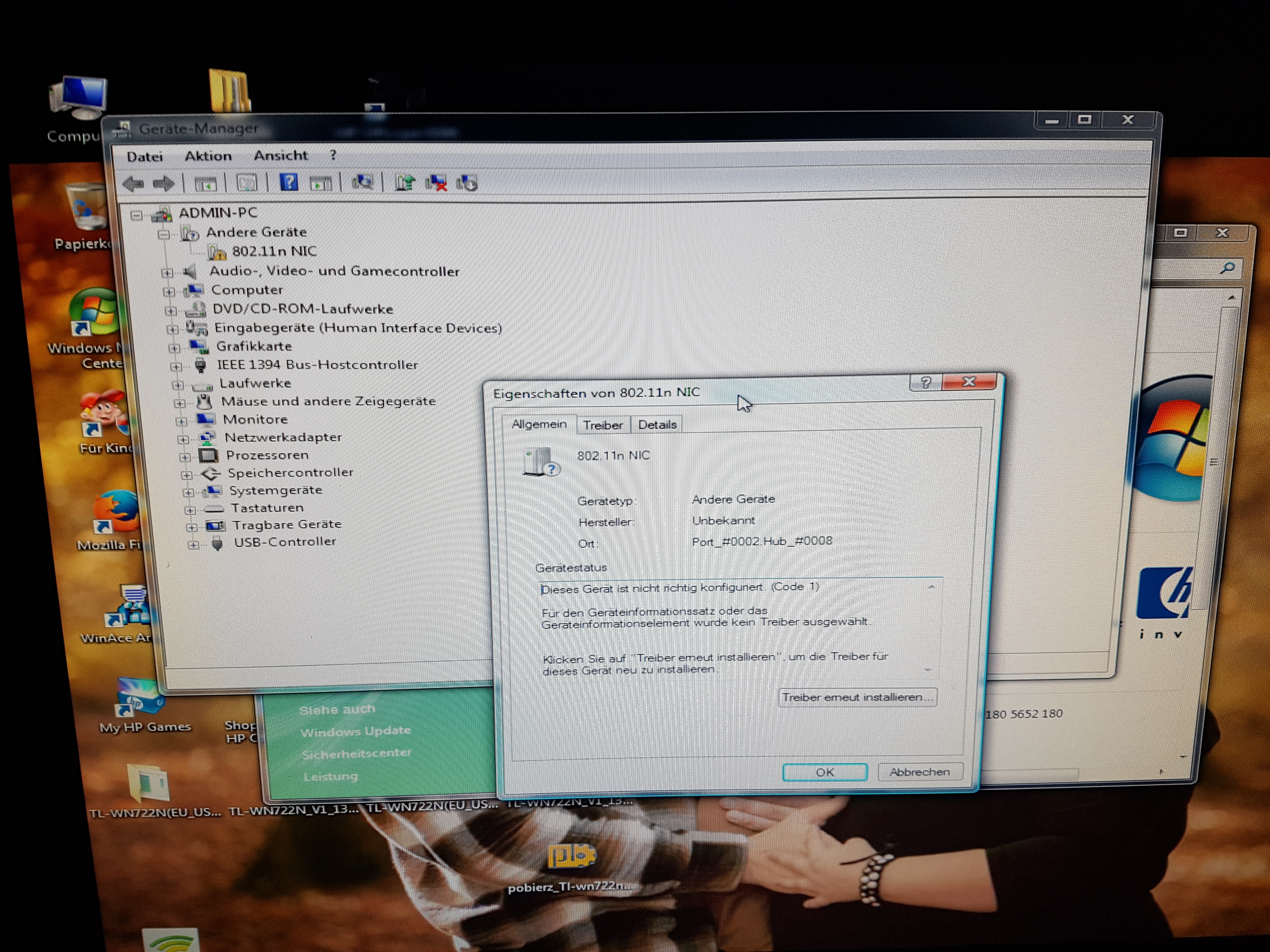

    I warmly welcome. At the beginning, I am sorry to repeat the topic, but after installing the drivers, Win Vista does not see a wireless career. Anyone have an idea what can be done in this case? In the attachment he adds a fote, maybe there is someone who has an idea what to do next to make Visa flicker. I will add that it works fine on a laptop with the win7 system

    win Vista after installing drivers does not see wireless career.
    And what is the hardware version of this card? - because only v1 is compatible with Vista, versions v2 and v3 are not.
    Although you can try to install the driver for v2 / v3 in the XP compatibility mode (although I do not bother that it will work and there will be no problems with it).

    I have ver.1 with me and "swims" on win xp and win 10.
