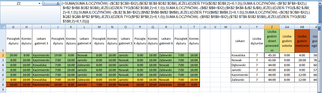

    If you change the layout of the table a little, and modify the definition of the roster ("Saturday" - this beginning on Saturday and "Sunday" on Sunday :| ) you can use quite simple table formulas to get the effect like on a screenshot:
    Schedule - counting hours - Counting hours of the schedule, weekdays, Sat and Su2017-11...png (71.97 kB)You must be logged in to download this attachment.
    Very important in this sheet is the appropriate custom "temporary" formatting individual data columns.
    The whole can be analyzed in the attached file. :spoko:
    grafikPr...xlsx (14.65 kB)You must be logged in to download this attachment.

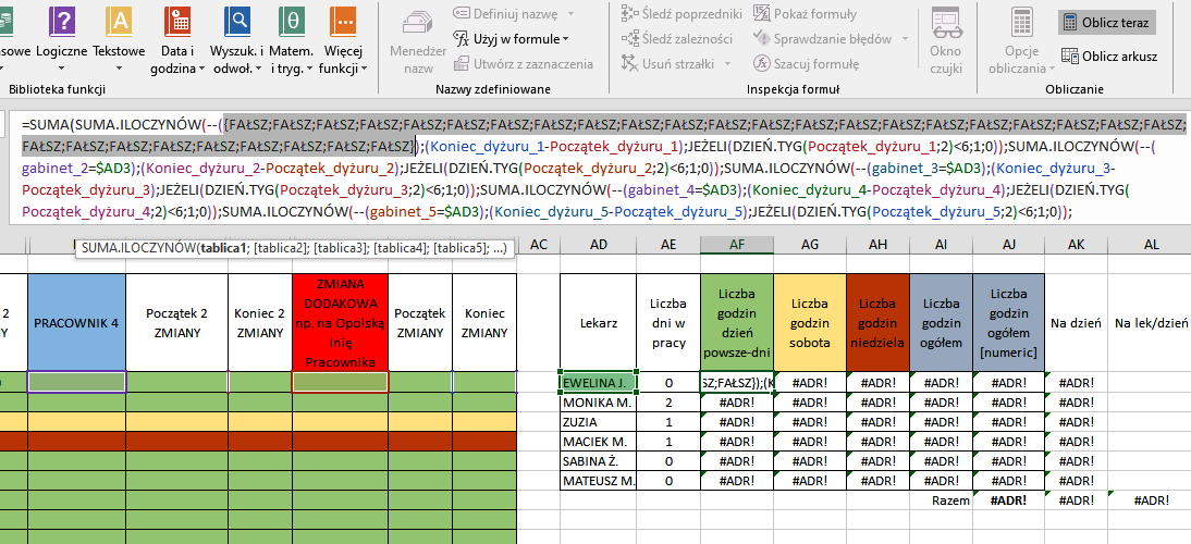

    I have been a forum user for a long time. I found an excel file regarding the schedule. I changed a bit to my needs, but now I am not counting the hours in the table. Could someone have a peek what is wrong? I can also have this sheet corrected for a fee.
    greetings
    • grafik z moimi poprawkami(1).xlsx (18.94 KB) You must be logged in to download this attachment.
    You haven't noticed, buddy, that there are a lot of so-called dynamic names (that is, names of self-adapting ranges :idea: ) :cry:
    I suggest you either go back to the original layout :!: or modify all names and adapt the formulas accordingly (by entering new names :D ).
    Generally speaking, these formulas are built as array formulas (sum of the products of arrays verifying the occurrence of a criterion and arrays with the number of hours) :idea: and when modifying these formulas you have to analyze (using the button calculate now :ok: if all tables are generated according to your needs.
    Schedule - counting hours - Counting hours of the schedule, weekdays, Sat and Su2020-10...png (76.5 kB)You must be logged in to download this attachment.
