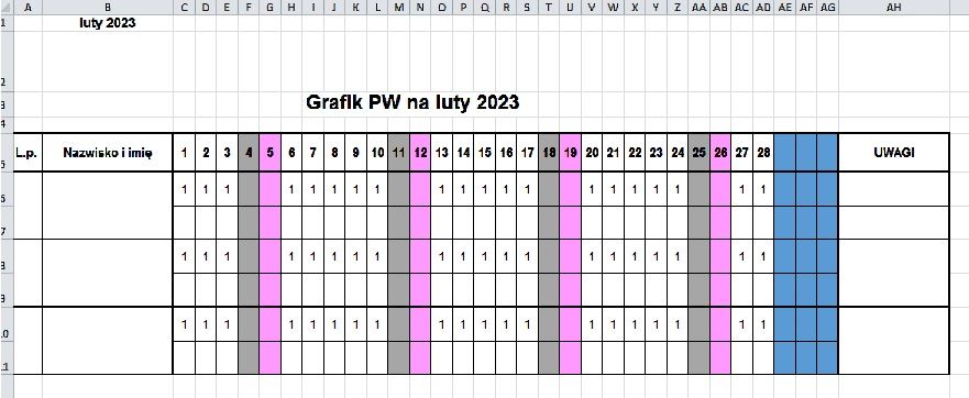

    And is there any other simple possibility, without auxiliary tables or scripts, to automatically enter in the schedule that if it is not a weekend or a holiday, then to enter 1 in the cell? As in the screen below.

    Is this supposed to be a formula?

    As it would be possible to do so.

    This would be a reversal of the formula used for conditional formatting:
