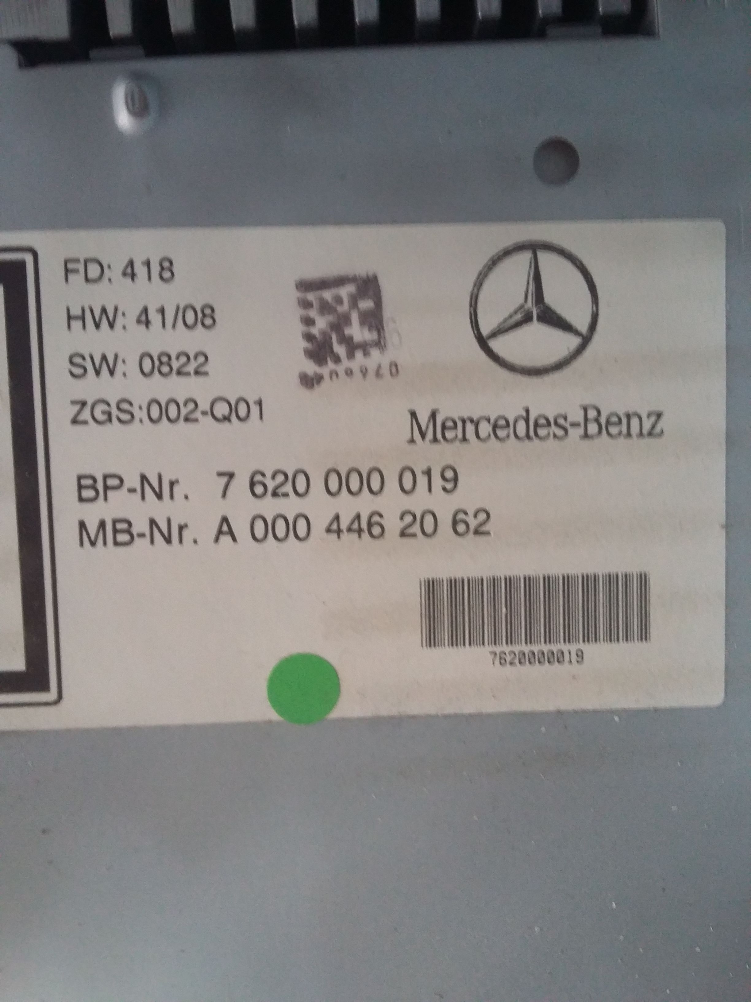

    How to unlock the Mercedes Benz Blaupunkt FD 418 car radio? The display shows BLOCKED. I have the correct code for the radio, but I cannot enter the code entry mode. All the time the word BLOCKED.

    Show a photo of this radio, you can not pull out to give the full marking from the nameplate?

    I found something. Maybe it will help .:
    "If the code is entered incorrectly three times, the display shows BLOCKED. The CD radio is locked for one hour. Only after this time has elapsed is it possible to re-enter the code. Do not switch off the CD radio during this hour. Otherwise, the lock time will be counted from the beginning."
    the photo gives at all.
