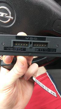

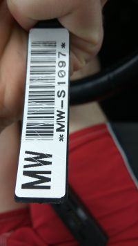

    Hello. Such a car:
    https://www.autocentrum.pl/dane-techniczne/op...hback/silnik-benzynowy-1.6-8v-75km-1998-2000/
    Purchased recently. And a problem with the radio. Radio, probably original. Somehow it started somehow (but after 15-20 clicks on the enable button). Now it does not work even after 50 clicks, but something the radio reacts to. When I press "code" (that is, pull out the panel), the display says "panel", when I press the "turn on" button and turn it clockwise, it looks as if it was happening and the display says "safe". I have no idea what this is about. This is a radio malfunction, can't I turn it on?
    • Activating Opel Astra G Original Radio: Understanding Safe Mode & Entering Correct Code IMG_20170507_122933_HDR.jpg (5.65 MB) You must be logged in to download this attachment.
    • Activating Opel Astra G Original Radio: Understanding Safe Mode & Entering Correct Code IMG_20170507_122658_HDR.jpg (4.89 MB) You must be logged in to download this attachment.
    • Activating Opel Astra G Original Radio: Understanding Safe Mode & Entering Correct Code IMG_20170507_122612_HDR.jpg (4.48 MB) You must be logged in to download this attachment.
    • Activating Opel Astra G Original Radio: Understanding Safe Mode & Entering Correct Code IMG_20170507_122533_HDR.jpg (4.06 MB) You must be logged in to download this attachment.

    You must enter the radio code

    Okay. I found something like this:
    http://forum.opel24.com/topic/1591-jak-odkodowac-oryginalne-radio-w-astrze-ii/
    And the code can be entered, but where is it? Is it somehow on the back of the radio panel or a note attached to the keys? (I tried with a key card, because there are four numbers, but this code probably does not match - I tried in the second place 0 and 8, no option matches, so it's probably not the code). Activating Opel Astra G Original Radio: Understanding Safe Mode & Entering Correct Code Activating Opel Astra G Original Radio: Understanding Safe Mode & Entering Correct Code
    Can the code be found in the car's documents?

    There should be a book from the radio and there is a code in it

    The code is for the radio to be started by the legal owner (who has the radio documents).
    The manufacturer never gives the code on the housing.
    The code is in the radio's memory. Experienced electronic engineers can read it.

    Okay, I found some code in the papers. There's this (I think) radio book. And now I'm a linden, because I don't want to enable the procedure of entering the code. I turn on the ignition, the lights are on, I hold the AS button, turn on the radio and again I see the mean "7 SAFE" inscription instead of the fields to enter numbers. Probably these radio buttons are somehow eaten ... that once they catch and once they don't. Well, that's my problem.
    PS 7 because I already used 3 tests.

    Wait calmly on the radio and ignition on until "- - - -" appears instead of SAFE

    In the video you can see that the radio switch is working properly. Since you entered the wrong code three times, you must now wait for some time to think about whether you have the correct code.
    - switch on the ignition and holding the AS switch on the radio. After the "7 SAFE" lights up, leave the radio in this state until "7 ----" appears on the display. Then set the correct radio code and confirm by holding down AS> 3sec. The waiting time for 7 ---- is 14 minutes. If the code turns out to be incorrect, then 6 SAFE will appear and then the waiting time will double (28 minutes).
