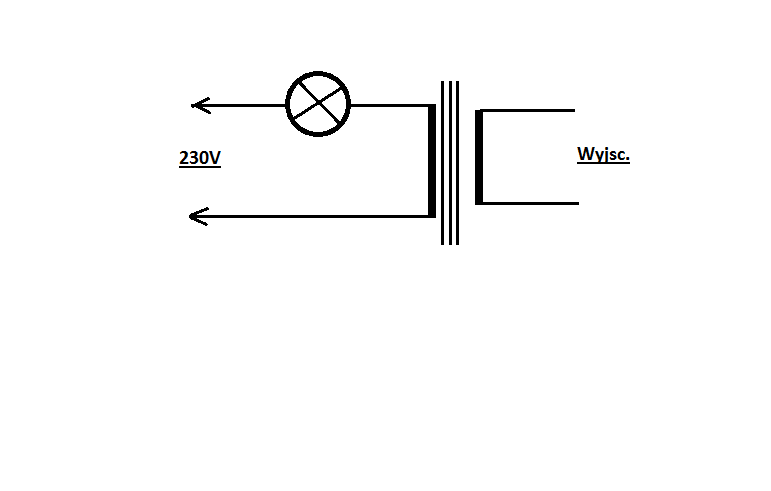

    Hello, I need a quick and reliable answer. I have a 230/24 V 2.5A transformer and 4 wires come out (2 red and 2 black). I have no idea which of the wires goes to the primary winding and which to the secondary winding. By its name is written 230V voltage next to it is written "black", it is not written whether black is a secondary or primary winding. Will someone help? I will also add that the red wires are thinner. I have no way to check the resistance, I do not have a meter. Regards

    All you need is a 40W / 230V light bulb connected in series with the transformer winding. Secondary it is in combination with which it shines brighter.
    Nice method. I would add far-reaching caution to stay away from the second pair of transformer wires when checking :D The differential will not work ...

    If you do not have an ohmmeter, then you can connect the transformer to the network through a 230V 40 - 100W light bulb. The original winding will be the one when turning on the light bulb to turn on, and for a part of a second the brightness will decrease to barely noticeable. When connecting the secondary winding to the network, the bulb will glow bright all the time. Transformer Winding: Identify Primary & Secondary Wires (230/24V 2.5A, 2 Red, 2 Black)
