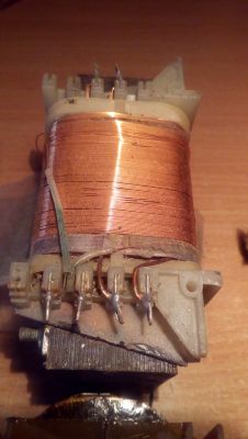

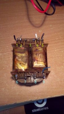

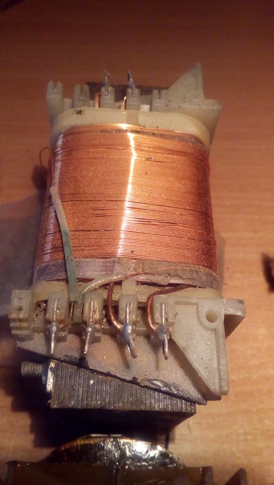

    Hello, I know there were similar topics but I don't know how to do it. I'm going to do something like in the video:
    The photo is marked with numbers. The connection is there between: 1-2, 4-5, 7-8
    Please tell me between which pins should I measure the resistance (high resistance = primary winding?) To know which winding is primary?
    Where there is the primary winding, I will remove it and there will be a wire, and where the secondary winding is, I will connect it to the electricity. Should it work right?

    The thickness of the wire at the bottom of the photo speaks for the secondary winding 6, 7, 8, 9.
    Don't be surprised, because the primary one can be wound under the secondary one.

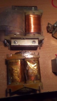

    I'm afraid it is a transformer as I write "Justyniunia". I have a second transformer of this construction, but it seems like it would be the opposite, i.e. the primary winding is first and the secondary winding below it (photos). I was wrong to remove the primary winding because you have to remove the secondary one. As the gentlemen from the movies say:

    There are no symbols except numbers.

    As shown in the pictures.
    Rezystor240 wrote:
    Let me put it this way, the pity of our domestic unitra-brand transformer will be lost to such crap.
    How will it apply, will you burn the wires like in a (stupid) movie?
    Waste of time.
    If you care about high current and low voltage, use the transformer soldering transformer.
    It will release about 200A at 0V5.
    I feel sorry for the transformer soldering iron. These transformers were to be dismantled anyway. Okay, I'll try first with a small transformer (see what the results will be).

    Primary winding can be checked with an ohmmeter
