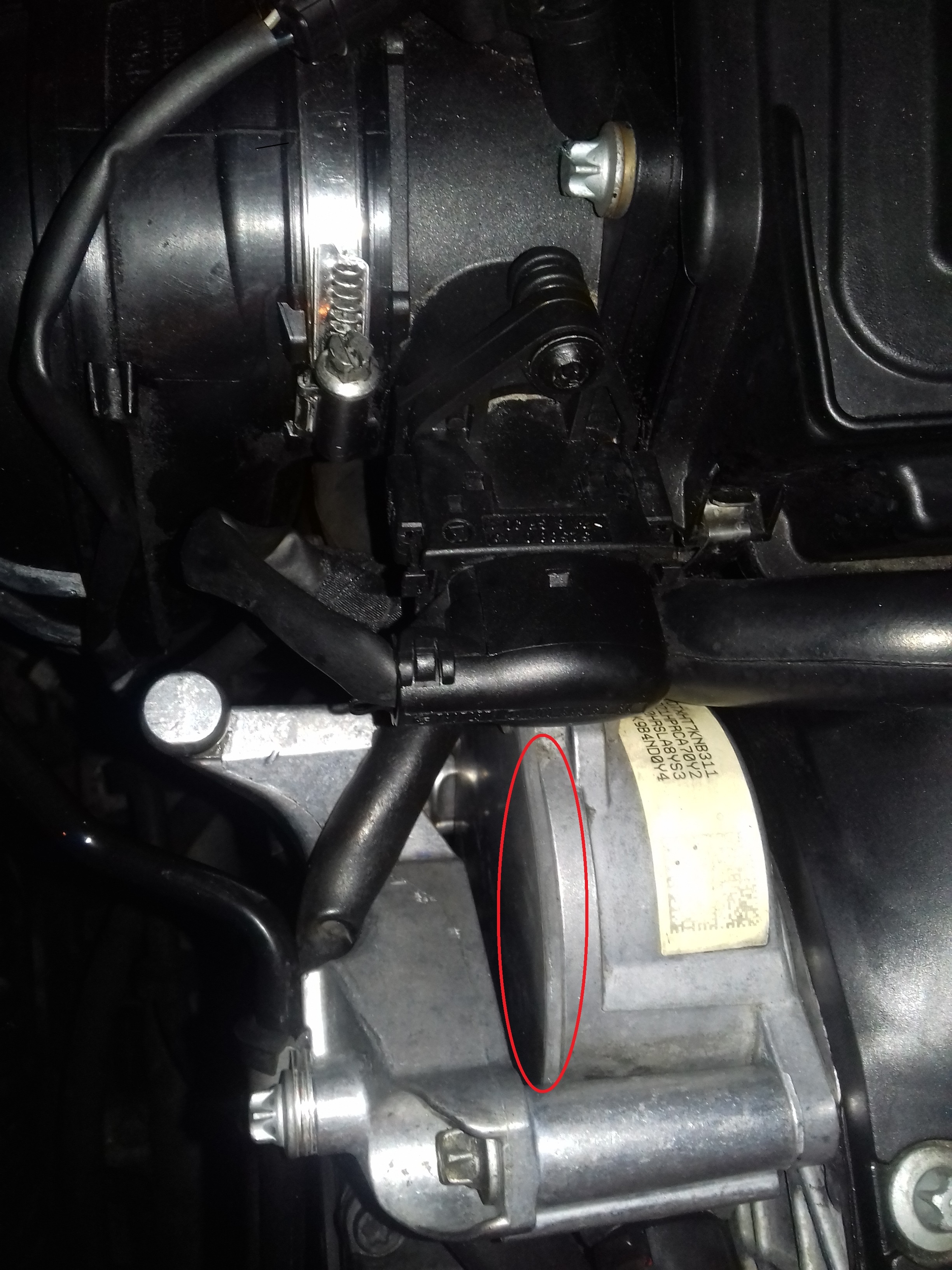

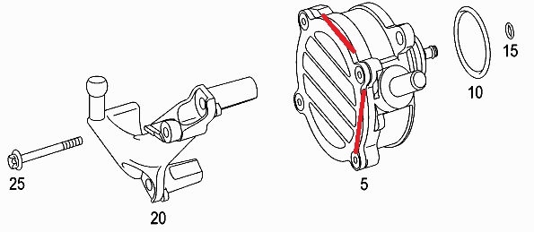

    Hello, can the Vacum pump be sealed with silicone?
    I replaced two O-rings available at the Dealership, but unfortunately it is sweating in the Vacum pump cover.
    In the photo below.
    W204 Vacuum Pump Seal: Silicone Sealant Use, O-Rings Replacement & Lid Removal on Car W204 Vacuum Pump Seal: Silicone Sealant Use, O-Rings Replacement & Lid Removal on Car
    PS.
    Can I unscrew this lid on the pump on the car? I am asking because I do not have 2 new O-rings and ASO can only come in a week.

    You can on the car, silicone - a questionable matter.

    diabeel
    I think it cannot be disassembled ... it is impossible to unscrew this cap ...
