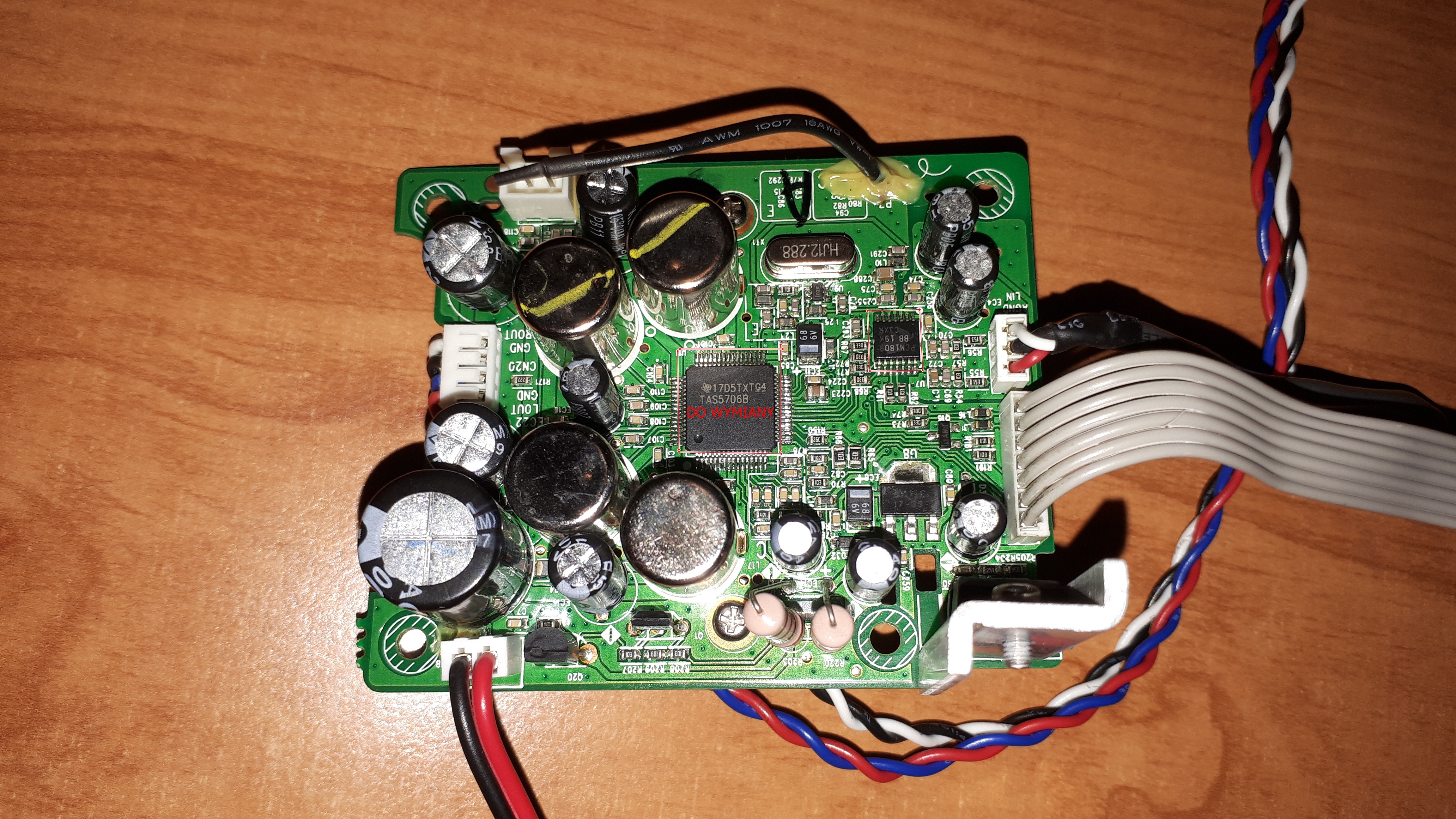

    Hello, I have a problem with the Bosch GML 20 radio, so this is how the radio turns on, everything works except the sound, it works on the headphones, but you cannot increase it very quietly, although the voice control on the display increases and decreases. I am adding a photo of the PCB with speaker terminals, if someone would advise me how to fix it, I would be grateful, thank you in advance for the answers.

    I gave the radio to a colleague who deals with car electronics, his diagnosis shows that the SMD TAS5706B chip, the so-called power amplifier, is damaged, a fairly popular fault in these radios, if the ordered part arrives, I will take a few photos of the soldering process.

    Hello colleagues. If you have not solved the problem with this equipment, I advise you to check the PCM1808 analog-to-digital converter on the amplifier module, I already got 3 pieces for repair and they all had the same replacement and it flashes.

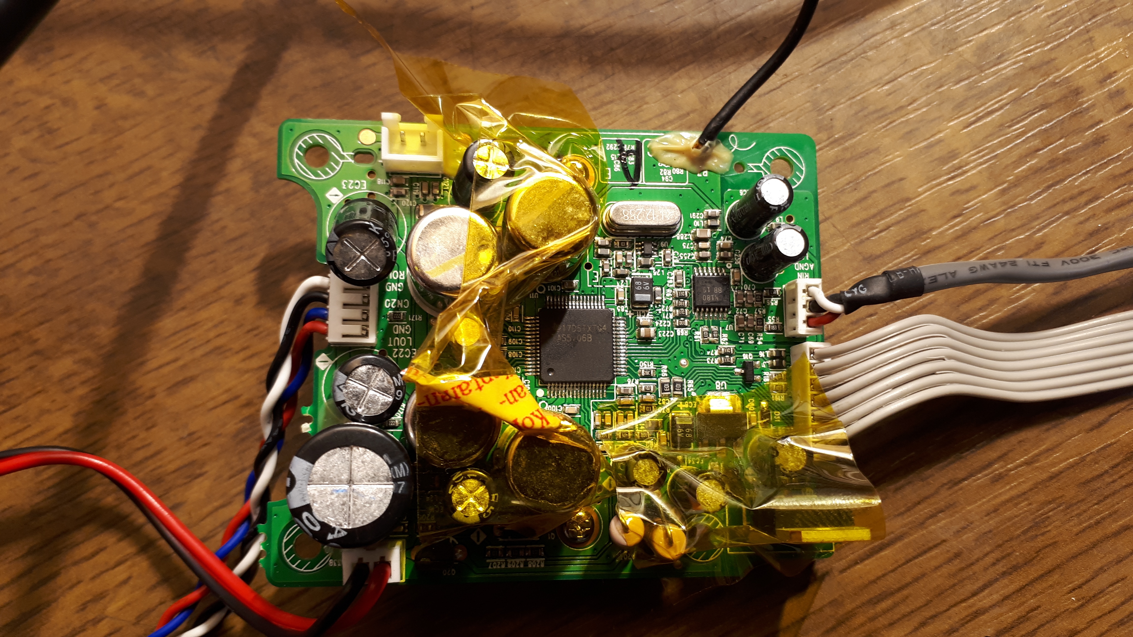

    Hello, I am sorry that I did not speak for so long but I had an urgent departure, but to the point the radio, of course, was the fault of the PCM1808 digital anologically repaired system. Of course, the radio worked for a few days during the tests and then it turned out that the TAS5706B power amplifier was also damaged, I do not know how many cases, but a short circuit in the PCM1808 circuit also damaged the TAS5706B circuit. So, to be calm and enjoy the radio, I would advise you to replace the systems marked in the photos, the repair of the radio was PCM1808 - 5 pcs - 30 PLN, TAS5706B - 1 pcs - 50 PLN. Bosch GML 20 Radio Problem: No Sound, Low Volume on Headphones & Speaker Terminal PCB Images Bosch GML 20 Radio Problem: No Sound, Low Volume on Headphones & Speaker Terminal PCB Images Bosch GML 20 Radio Problem: No Sound, Low Volume on Headphones & Speaker Terminal PCB Images b.jpg [/ img] [/url]

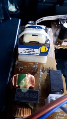

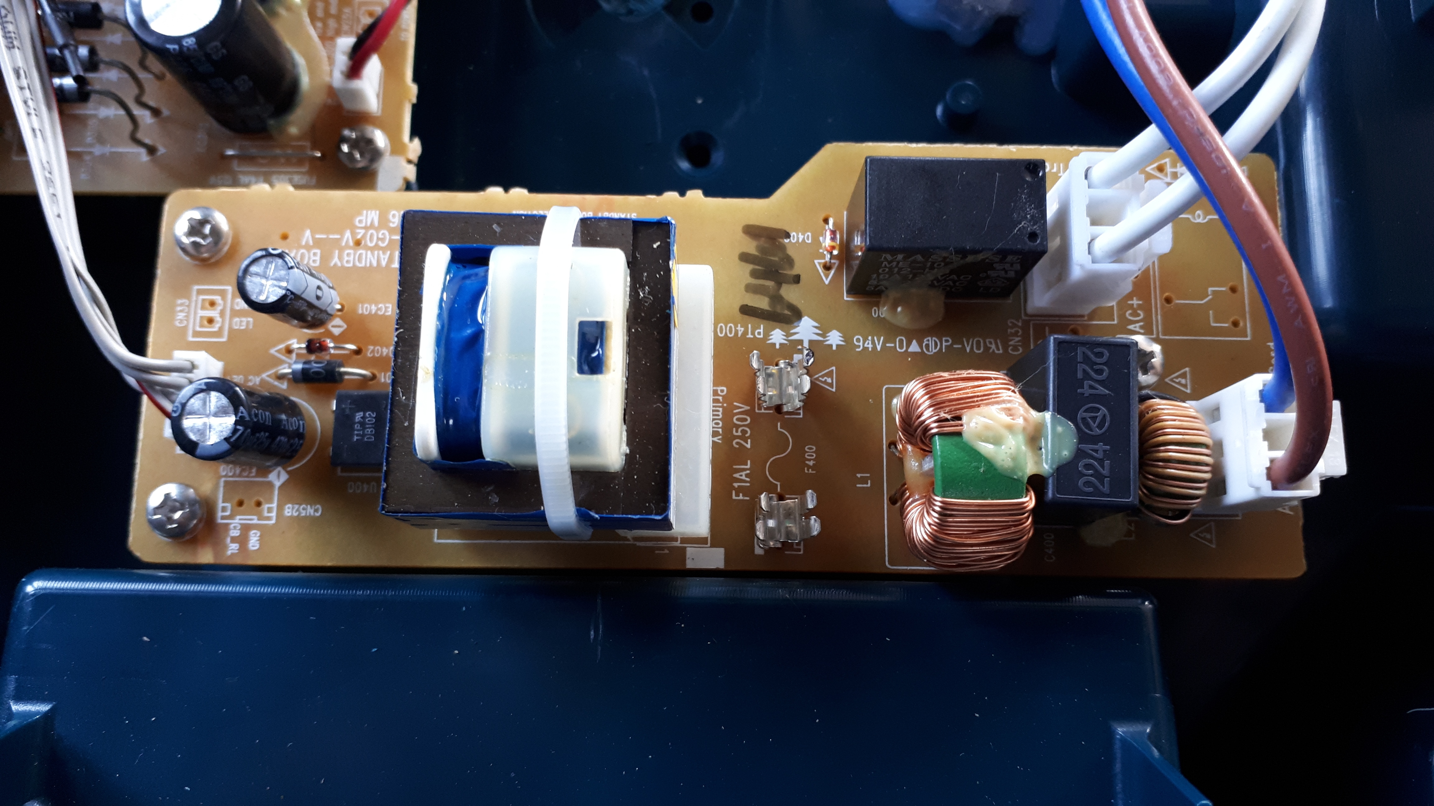

    I brought another radio from abroad and I have a problem with the power supply, maybe someone will tell you where I can find a transformer like in the pictures. After disconnecting the wires from the board, the transformer has a short circuit and heats up quickly and the fuse blows. Bosch GML 20 Radio Problem: No Sound, Low Volume on Headphones & Speaker Terminal PCB Images Bosch GML 20 Radio Problem: No Sound, Low Volume on Headphones & Speaker Terminal PCB Images Bosch GML 20 Radio Problem: No Sound, Low Volume on Headphones & Speaker Terminal PCB Images

    From what I can see it may be a transformer from the St-By system. It should be around 3-5W and voltage around 8-9V. What kind of radio is this?
  • #14 17126975
    Kob82
    Posts: 47
    Radio to BOSCH GML20
