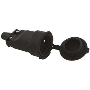

    At the beginning I will write that I am green on the subject of electrics / electronics, but I need to hook up, and at the output to have 230v.
    I know there are small switchboards to buy that would do the trick.
    Creating a Safe Adapter: Convert 4-Pole 400V to 230V using 3-Wire Cable and 4P Plug (DIY Guide)
    But why overpay over PLN 100 if it is possible to make an adapter out of the available materials?
    I have a 3-wire external cable to which a 230V socket is already mounted.
    Can I install a 4p plug to the other end of the cable?
    According to this scheme:
    So L3 would not be connected to anything.
    The question may be stupid for someone who knows each other, but will such "extension" work and is it safe?

    Maybe it is PEN. I need to make sure and if the socket was 5p then can the cable be connected to L1, PE and N? And then there is no problem?

    Since, as you claim, you do not know each other, I suggest: link

    jawamdam wrote:
    maybe it's actually PEN. I need to make sure and if the socket was 5p then can the cable be connected to L1, PE and N? And then there is no problem?
    We bet you are gone?
    Kraniec_Internetów he really doesn't know what he is writing.

    Of course, he does not know, because the PEN cable can be connected only in the 63A socket. :)
    Ps. Other adapters (e.g. from a 32A socket) with a fuse are also produced.

    Even if it is 10mm2 PEN and 4p 63A socket it must not be done.
    The splitting point cannot be in the extension cord or in the receiver - strictly prohibited.
    In this reduction we will not get PE even though PEN is in the socket.
