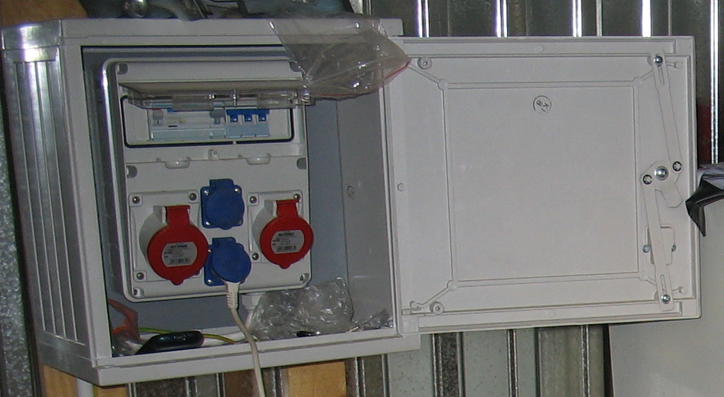

  • #15 18621255
    Robinson74
    Posts: 901
    Rate: 159
    I will step on the topic, because the situation for me is very similar.
    Don't "hook up", just read the regulations first.
    3.1.19. Publishing entries in archival discussions. / zbich70 /
    I have a switchboard and a 400V socket with 5 pins in the tinplate (there is also a differential),
    It looks like the attachment.
    Father-in-law has a welding machine, but with 4 pins.
    Is it safe to connect?
    Is there any "adapter"?
    • Connecting a 5-Pin 380V Plug to a 4-Pin Socket for a Car Starter IMG_2781_cr.jpg (169.04 KB) You must be logged in to download this attachment.

  • #16 18621346
    Ktoś_tam
    Level 40  
    Posts: 5367
    Help: 505
    Rate: 2912
    We are in the 20s of the 21st century. Maybe it's time to adapt devices and installations to modern standards and not to make strange adapters?
